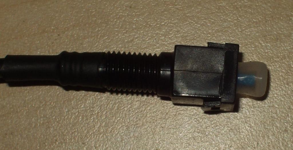

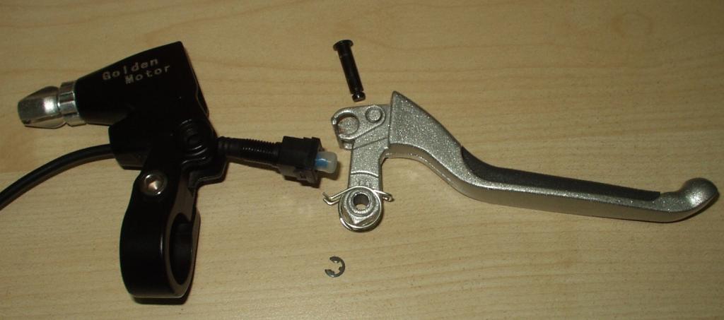

When the lever is pulled, the switch contacts are connected together by a metal disc on the end of the spring loaded plunger pin which simply short circuits the brake signal lead to ground. This forces the controller to cut the throttle and apply regenerative braking and also cancels the cruise control if it was in use.
When the brake lever is released, the plunger is pushed back against the spring and the metal disc moves away from the two contacts creating an open circuit.
The following picture shows the socket fitted on the end of the brake lever cable:
The actual current being switched through the brake switch is very low, so most small microswitches should be able to handle it with ease. Simply connect the two wires that are connected to the existing switch to the "N/C" (Normally Closed) and "C" (Common) contacts on the microswitch.
I strongly advise against using the +5V supply to power LED lights. The +5V supply is needed to provide power for the hall sensors in the motor, throttle and pedelec sensor, and if it is overloaded it could blow the controller's 5V regulator chip causing your controller/motor to stop working completely!

Thanks for the info. I went ahead and installed a micro switch in my Hayes hydraulic brake lever.WOW!! It almost threw me over the handlebars! I had to turn it way down (with the "max EBS current" setting for both motors) like you said. Works like a champ. Thanks again for all the time and help you've given me.
