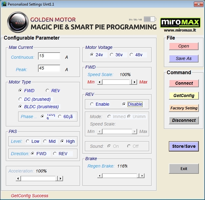

Finally got around to reading the post. It was never clear on the diagram how to fit the proper leads. Maybe I just kept reading it wrong. I have fitted the lead and connected to laptop. Still attempting to decode the instructions. Factory setting is for 5% regeneration. Is that high or low? Speed is set at Max. That can be too fast for my use. Is there a way of having the pedal assist power on slowly and smoothly? At present it seems to come on in cycles power on power off power on power off.
5% seems very low for the regeneration and is probably barely noticeable. The factory default on mine was 50%, but I now have mine set at to the maximum of 116% to save wear on my mechanical brakes.  ;)
You need to reduce the "FWD Speed Scale" to suit.
Unfortunately that's how the basic Pedelec setup seems to operate.   :(
Achieving a smooth regular power output is a lot more complex and expensive, and requires a Cycle Analyst to be installed, along with a pedal crank torque sensor.
You could try another PAS Level (Low, Mid or High) to see if it helps, but I don't think it will make it smooth and even.
