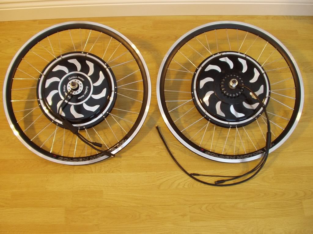

Here you can hopefully see the obvious difference between the MPII on the left and the MPIII on the right:
The pictures I posted previously were of an MPIII that was modified at the factory, but I don't know whether the wiring harness is available separately or not.  As with the external MPII harness, I suspect you would require thicker wiring to carry 80 Amps for sustained periods of time.
Presumably you will be fitting a heavier duty battery to cope with the demands of the controller, as the GM battery is unlikely to deliver that amount of current unless you bypassed the BMS (which would allow the cells to be overloaded, resulting in permanent damage).
All you need to do is extend the three phase wires using suitable cable, along with the five thin wires from the hall sensors using a length of flexible network cable etc. (not required if you are using a sensorless controller) and fabricate a circular cover plate from some 3mm aluminium for the cables to pass through and simply bolt it in place of the old controller.
