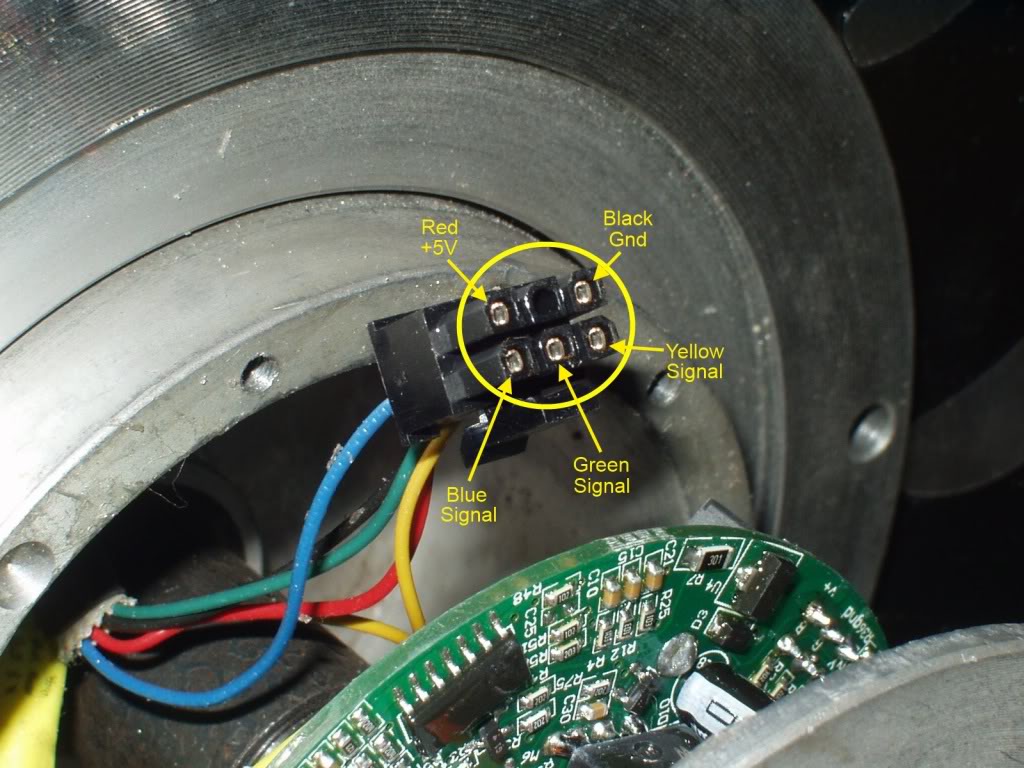

[ANSWER: open the controller; unsolder the yellow wire; solder it to the pin corresponding to the yellow wire from the hall sensors connector; as a result you will have hall sensor's 0V-5V ticks at your pedelec signal wire; VERIFY THE WIRES FIRST, READ THE DISCUSSION BELOW]
I'd like to build a speedometer/odometer for my MP3. Is there any way to catch the hall sensors' data? At the picture below there is "For meter display" connector, but I can't find anywhere description of what the two wires are - "Signal Receive", "Signal Transmission".
If MP III doesn't provide the hall sensor ticks trough its connectors is there anyway to get that from the controller without damaging it?

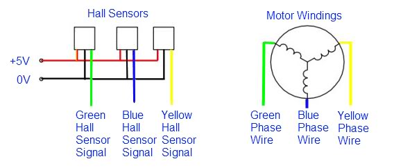

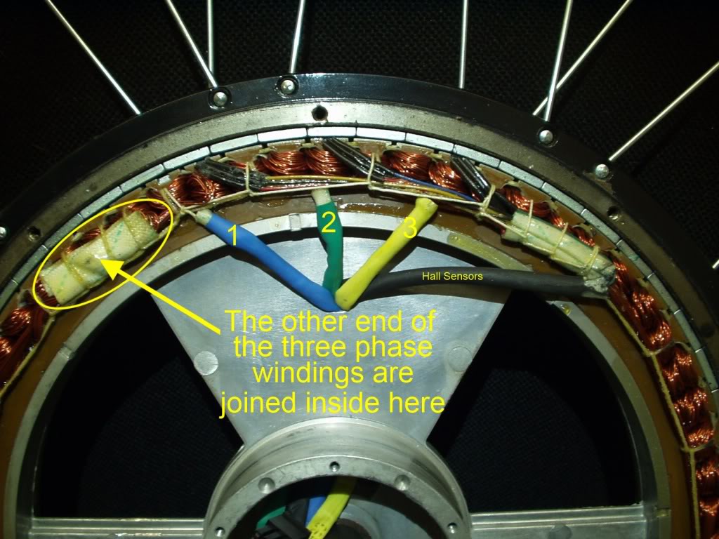

By the way, why there are three hall sensors in the motor - to calculate the speed faster by getting quickly 2 time intervals or there is another reason? For my needs I think I will need just one signal from any of the three hall sensors, but now I am thinking to get data from two of them (anyway there are two spare wires to use) so I will not have to wait for full 360 degree rotation but short time between the two triggers. (I am not sure how they work and will check practically - do they trigger once in 360 degrees, or multiple times by several magnets during the 36o degree rotation)
The hall sensors are used to sense the position of the rotating magnets in relation to the fixed phase windings, not to measure the speed.
There are three hall sensors because it is a three phase motor, so each hall sensor controls one of the three phase wires:
Here is the Hall sensor connector on the MPIII:
The Magic Pie has 56 magnets, so there would be 28 +5V/0V pulses per revolution (360 degrees) from each of the Hall sensors.
