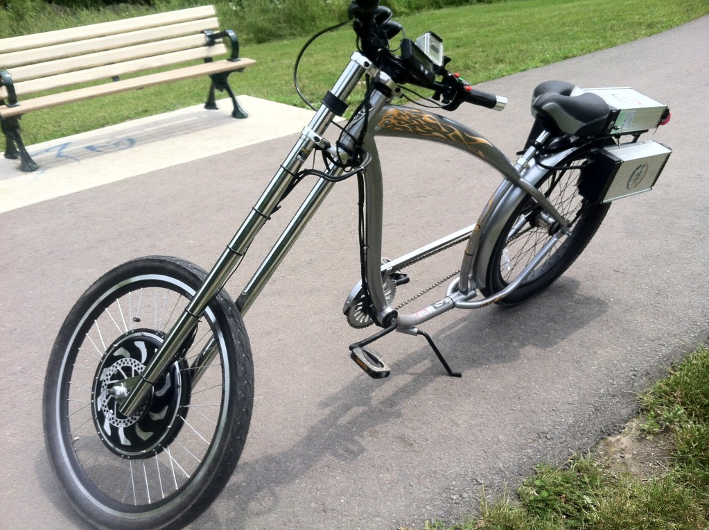

In response to ( maybe Gary can contribute to this topic about his Cannibal ) . Gary has already said last year that he would loose traction with the front wheel in wet and muddy conditions . I have the same bike with a Smart Pie front and mid mounted battery and have never had wheel spin unless I induced it to show someone how much power it has at rest . It won't spin with me sitting on it . I don't ride in mud or take my bike out in rain , they don't like it . The Cannibal is not a good example for the previous argument that rear wheel drive is better as there is very little weight on the front wheel . A standard Mountain Bike or even Beach Cruiser has more weight on the front wheel. Also Gary's bike did not come with any brakes in the front where as mine came with a disk brake , but the disk was mounted on the opposite side of the bike as normal and since the MPII that I had at the time could not be made to run in reverse without rewiring the motor I opted for a Smart Pie which could be run in reverse .
Hi Rod,
Damn, that sure is a good looking design. I like the way the upper tubing line flows from front to rear.  Gary's battery collection over the rear wheel looks cooler, tho.  And to be honest, if I was selling EV stuff, I'd want to have a bike that would smoke the front tire:)
Hey, Aliassss, are you saying efficient but meaning effective in your comments about FWD?  Look them up.
