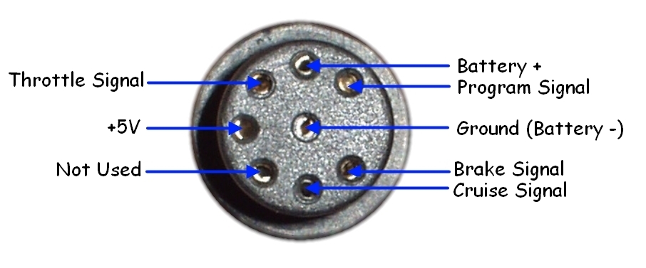

Using the picture that is attached to this post, I connected 2 wires and a multimeter  and got a 5V reading, next I crossed the 2 wires, which should have made the motor spin at full speed but nothing happened.
Was the battery still connected while you joined the wires together or was is only turned on after joining the wires?
It is very important that the wires are not joined together before the battery is turned on, or the motor will not run.
Using the above diagram for reference it might be worth trying a few simple tests to confirm that the Throttle, Cruise and Brake signal wires are not shorted to ground somewhere inside the motor harness or on the controller connections, as grounding any of these signal wires could prevent the motor from running.
Connect the negative meter lead to the centre "Ground" contact and measure the voltage on the "Brake Signal" contact. It should read somewhere between 5V and battery voltage, if it reads 0V then something is wrong.
Leave the negative meter lead connected to the centre "Ground" contact and measure the voltage on the "Cruise Signal" contact. Again, this should read somewhere between 5V and battery voltage, if it reads 0V then something is wrong.
Leave the negative meter lead connected to the centre "Ground" contact and measure the voltage on the "Throttle Signal" contact. It should read less than 1V, if it reads more than 1.25v then the throttle test may not work.
Now connect the "+5V" to the "Throttle Signal" and check that they are both reading around 5V. If it reads 0V then I would suspect a short to Ground somewhere on the Throttle Signal wire.
If all three signal wires produce the expected results, I would say that the new controller is faulty (unless you have a battery or BMS problem that is not allowing enough power to run the motor when load is applied).

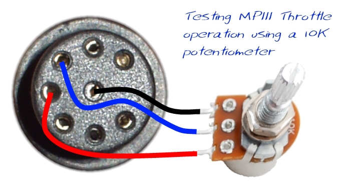

Here's an alternative throttle test using a 10K potentiometer:

Also I see by the diagram you added that when I was doing my testings(at the very beginning) based on the diagram I added at the first post at this thread , I measured the voltage between the +5V connector  and "not used" connector and after that I connected them. Is this the right way to make the wheel spin at full speed?
*asking because of the "not used" label.
Sorry for the confusion, I somehow copied the labels from the plug view instead of the socket view. I have amended the incorrect diagrams in my previous post so they are now hopefully correct. I really should stop posting on the forum late at night when I'm not fully awake! ::)

Here are my readings:
voltage between "Brake Signal" and "Ground" is 4.814V
voltage between "Cruise Signal" and "Ground" is 4.815V
voltage between "Throttle Signal" and "Ground" is 0.001V you said it should be less then 1V, but should it be 0V?
voltage between "+5V" and "Ground" is 5.055V
voltage between "Battery+" and "Ground" is 53.52V(same as the voltage coming straight from the battery)
voltage between "Throttle Signal" and "+5V" is 5.050V
Re: Magic Pie III motor won't run(starts and after a second stops)
« Reply #14 on: February 23, 2014, 09:12:20 PM »
0.001V seems reasonable (with the throttle unplugged) but I would expect it to read around 0.8V with a throttle connected.
