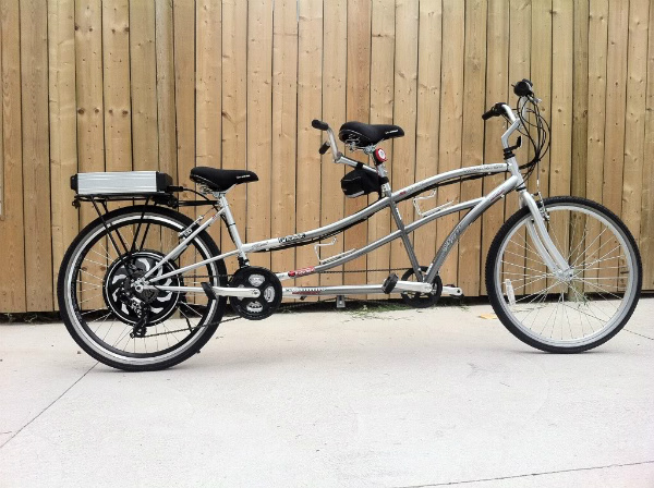

Even My Tandem has v-brakes, the rear motor with regen at 90 percent and it stops just fine with two riders.

Just my 2 cents on Regen Braking.. And A cheap excuse to yet again post pictures of my ebikes. I love them all! I think I'll go hug them again right now!
