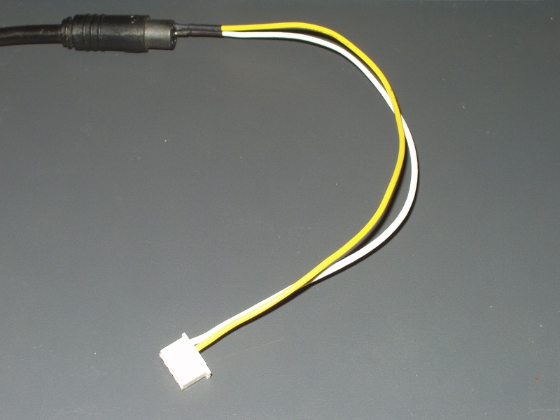

The reason I know this can happen, is because I have just performed a very simple test to confirm my suspicions:
I plugged 2 wires from a disassembled battery balance lead extension cable into the to Battery + and the Throttle Signal connection on the motor harness:
and then gradually dipped the connector end into a small amount of tap water, and the motor instantly started to run the moment the contacts touched the surface of the water!
Inside the eight pin connector, the  Battery + and Throttle Signal pins are adjacent to each other and are only separated by a gap of around 2mm, which is the same as the spacing on the balance lead connector terminal that I used for the test.
If the water conducts enough volts with my 29.6V battery, the problem would occur even more easily with a 48V battery.
However, the motor did not run when I tried the same test with the connector lead attached to the +5V and Throttle Signal connections.
