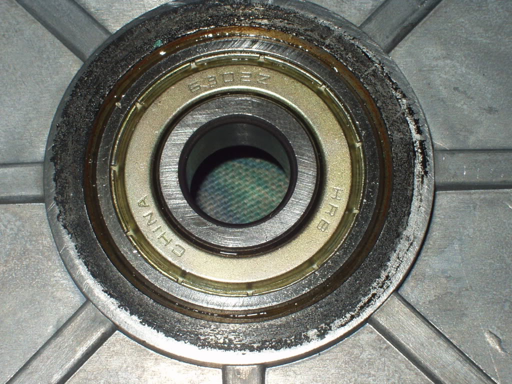

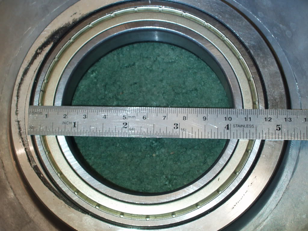

Here are some photos of my MPIII's bearings:
The left hand bearing has an unusually large inside diameter (85mm) to allow it to fit over the outside of the stator's tubular extension piece that houses the speed controller.

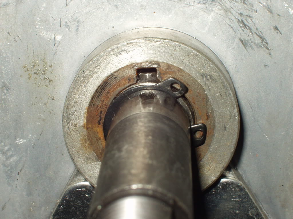

The right hand bearing is the same size as the earlier Pies, and it appears to have some form of locking compound holding it firmly inside the housing:

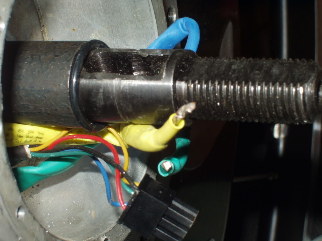

The inside of the bearing fits nicely over the machined surface of the axle next to the circlip:

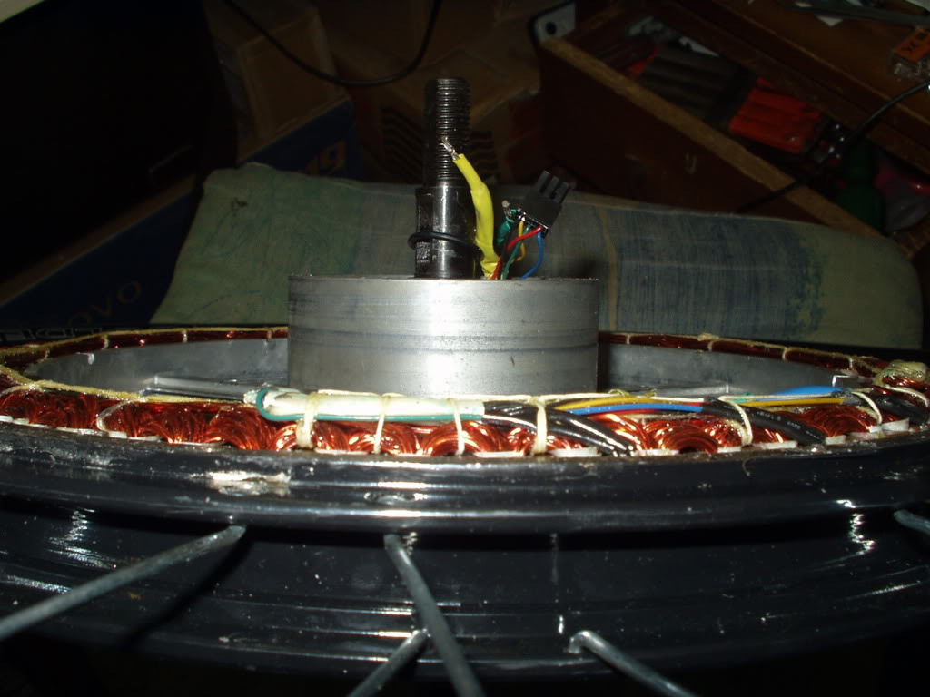

I think the most likely place for any play to occur will be between the inside of the large bearing and the cylindrical part of the stator, but you will probably have to remove the disc brake mounting/fan assembly in order to see it more clearly.
Any play developing between the bearing and the stator assembly would result in movement as indicated by A and B on this photo of an early Magic Pie:

I suggest you price up a replacement bearing before you attempt to remove the original one, as some of the ones I found were quite expensive.
Here are the relevant bearing details:
Replacing the bearing is unlikely to be an easy task, as there is no direct access to drift it out without possibly causing damage to the side cover.
It may be necessary to use a special drift of approx 86mm diameter, which should hopefully just fit inside the alloy casing and locate against the inner race of the bearing so it can be tapped out.
If the bearing has been sealed into the housing with bearing locking compound (to eliminate any unwanted movement) it will be much more difficult to remove.
It's possible that a press (either hydraulic or mechanical) may need to be used to gently ease the bearing out of the housing. ???
