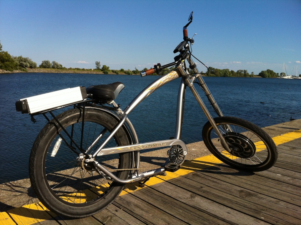

When I first bough the Cannibal I was upset because you cant get the disk brake in Canada. NO front brake didn'n't sound like a good idea. I even tried ordering from the states, but still they would not ship to me. I was actually thinking of asking you to accept front forks for me then ship them up here.

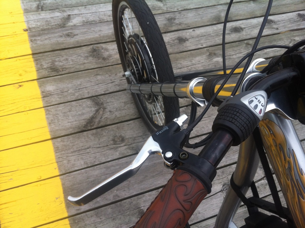

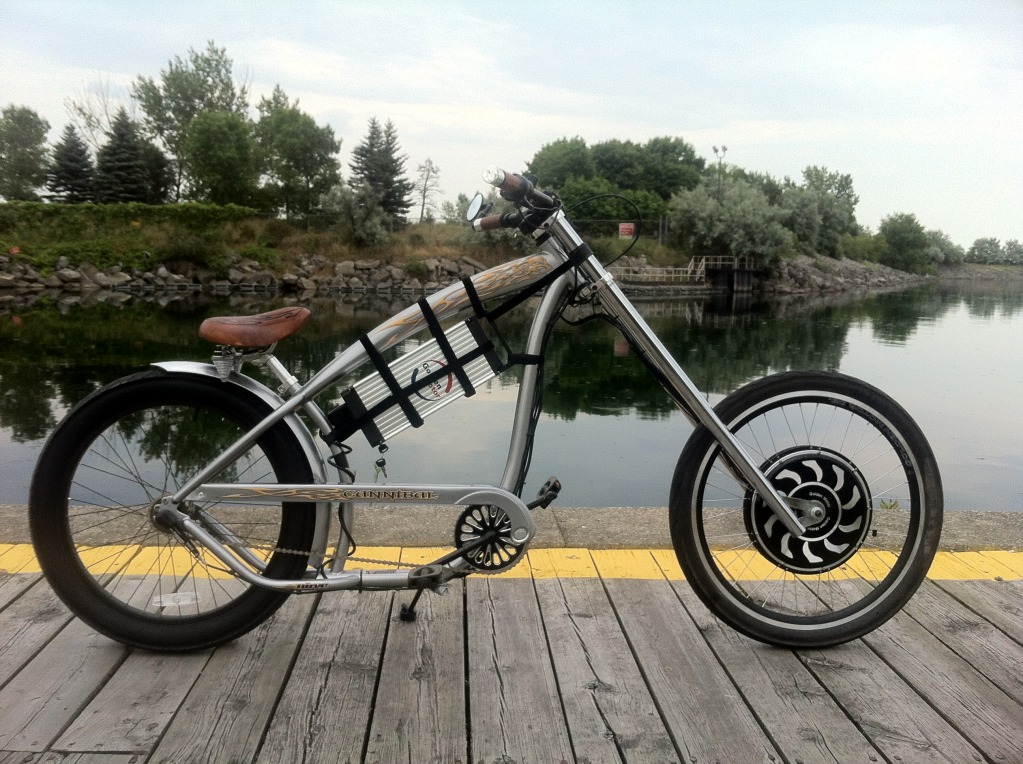

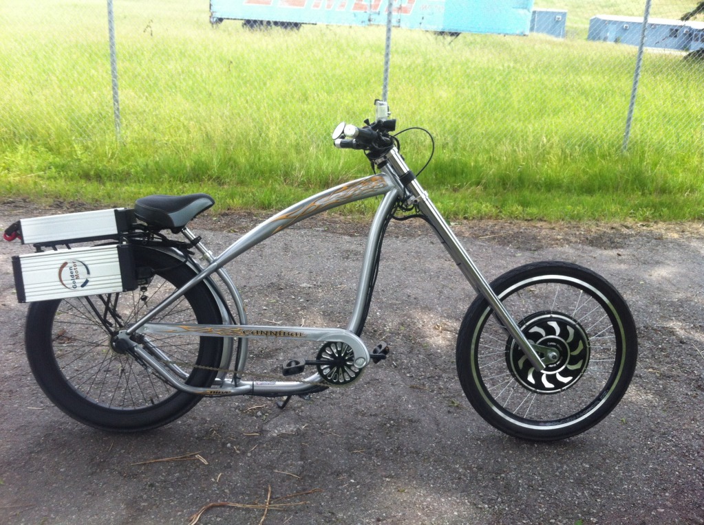

After about two weeks and different configurations I have decided the front disk brake is not nessasary and even probably dangerous. The front wheel so far out front just spins out every time you take off, so braking would slide easily. I swapped to a 36 volt battery for street legal speeds by default and added a brake lever to the left handlebar. The brake lever has no cable to a disk brake. I am just using it for regen braking on the front wheel now and it works great. This bike is really for someone that does not intend to ride on bad surfaces. A nice ride for a sunny day :)
I treid a few battery locations as well. I like the 36 feet of velcro strap method and haning it in the frame. The bike loses alot when you have a rack on the back. Still awesome thougfh in any configuration of course.
The lever, no brake cable, regen braking only
One battery
Three batteries
And now the preffered method, 36 feet of velcro strap
Of course with the velcro it's not a good idea to leave the bike unattended. So this ride is really for sunny day rides where you keep your butt in the seat or at least an eye on the battery ;)
