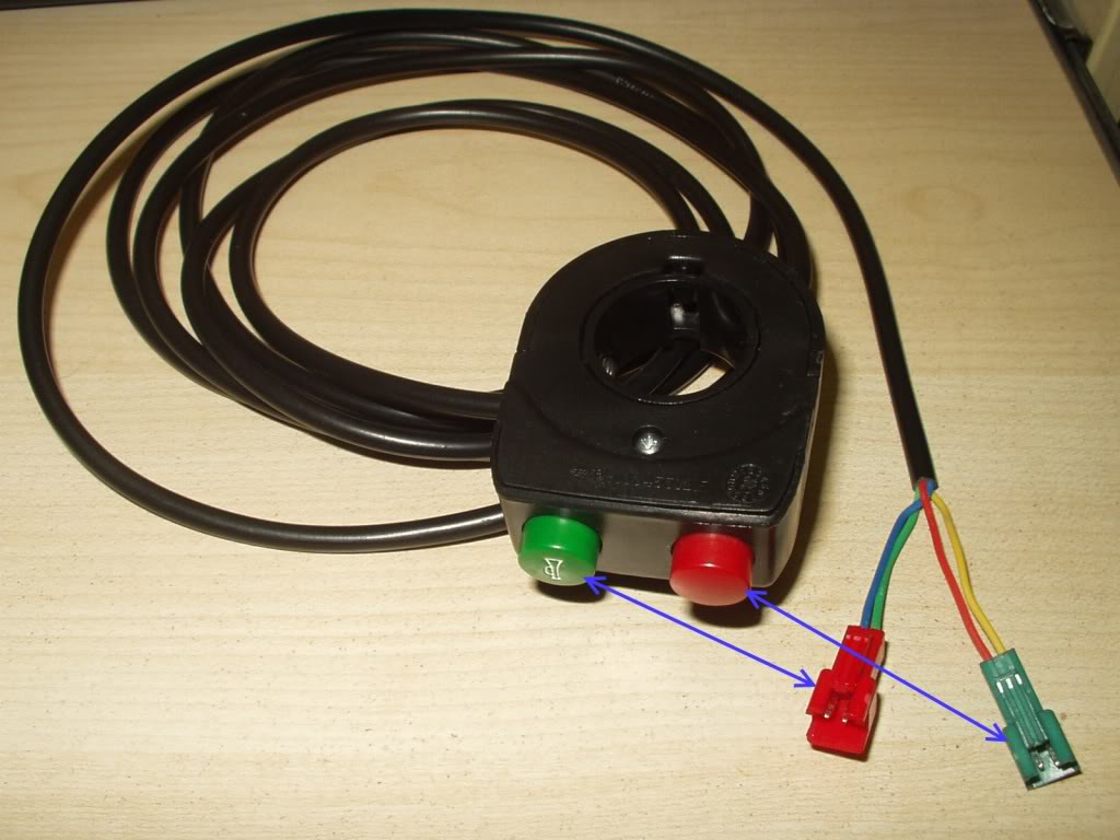

Re: MP II, Horn switch connections
« Reply #8 on: May 31, 2012, 12:49:56 PM »
I've just had a quick look at the connections on my MPII wiring, and my horn/cruise switch assembly appears to be wired as shown here:
The green horn button is connected via the green and blue wires to the red connector.
The red cruise button is connected via the red and yellow wires to the green connector.
To use your horn button as a regen button, simply plug the red connector from the switch unit into the blue brake switch connector on the main harness.
The original Magic Pie connections were as shown here:
My MPII harness has different coloured wires to the above diagram, and it also has an additional black two pin connector which connects to the red switch on the throttle to allow the reverse function to be used.
If yours has the external controller the wiring may be slightly different, but hopefully you can figure out which wires need to be swapped.
« Reply #11 on: June 01, 2012, 04:07:50 AM »
I have often wondered what genius decided the red button goes to the green plug and the green button goes to the red plug. why? Why? WHY? Is this just to drive people insane??
« Last Edit: July 02, 2017, 08:05:38 PM by Bikemad »
Re: Red and Green
« Reply #12 on: June 01, 2012, 01:23:56 PM »
As red usually indicates danger, I can only assume they opted for the red connector on the horn circuit because it connects to the battery +ve terminal which is potentially far more dangerous than the cruise signal voltage.
The cruise button is probably red because inadvertently operating the cruise control could be more dangerous than sounding the horn! ;)
Most of the machines where I work have green start buttons and big red emergency stop buttons, but I did hear someone mention that the European Standards want this to be changed so that a red start button indicates danger, and a green stop button makes it's safe.
We readily accept that Red traffic lights mean STOP because it's dangerous and Green lights mean it's safe to GO, so why would we even consider changing switches on potentially dangerous machines and equipment to do the exact opposite?
