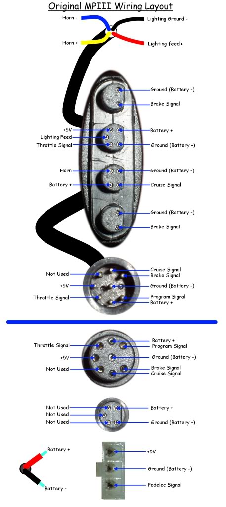

Dennis, you seem to have either a problem with your 5V supply for the throttle sensor, or a poor connection with your test probe. If your harness has the three pin pedelec connector, you can easily check the 5V supply by measuring between the connectors with the red and black wires.
I would suggest you unplug the 8 pin connector from the motor harness and see if the 5V supply is present on the +5V socket.
I have attached two wiring diagrams which I have drawn of the two different wiring harnesses that I received. Hopefully this will help you to figure out the correct throttle connections.

to what pins did you connect the pot you mentioned?
That was on an earlier Pie which had the separate three pin throttle connector as shown in the photo. The two outer connections went to the +5v and Ground connections, and the centre connector went to the throttle signal wire.
Carefully check your levers and throttle/motor harness connection and let's hope you find something obvious causing your problem.
