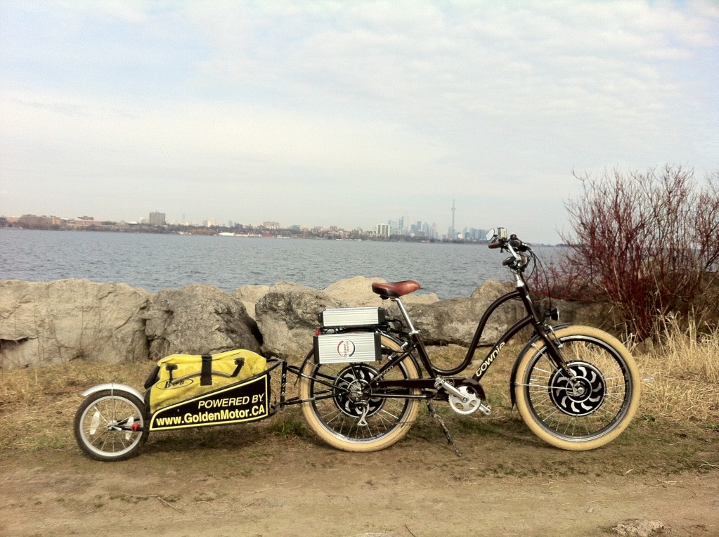

An MP3 with a 48 volt battery wil serve you well. My rolling weight with me, the bike and the trailor is close to 500 pounds. My bike is a dual drive MP3 but I recently swapped the MP3 front wheel back to unmotorized for some test rides to work. The bike performed well and I rode 10 miles uphill to work on one 48v10ah battery. Considering the the distance you travel is half that and resonably flat I would think one 48v10ah battery would be sufficient for round trips with power to spare. I have put the MP3 back on the front again as I did miss the extra power.

I will be mostly sticking to side streets, all paved, with only a slight increase on the ride home. I like the pics (and the kind comments about my weight)!
