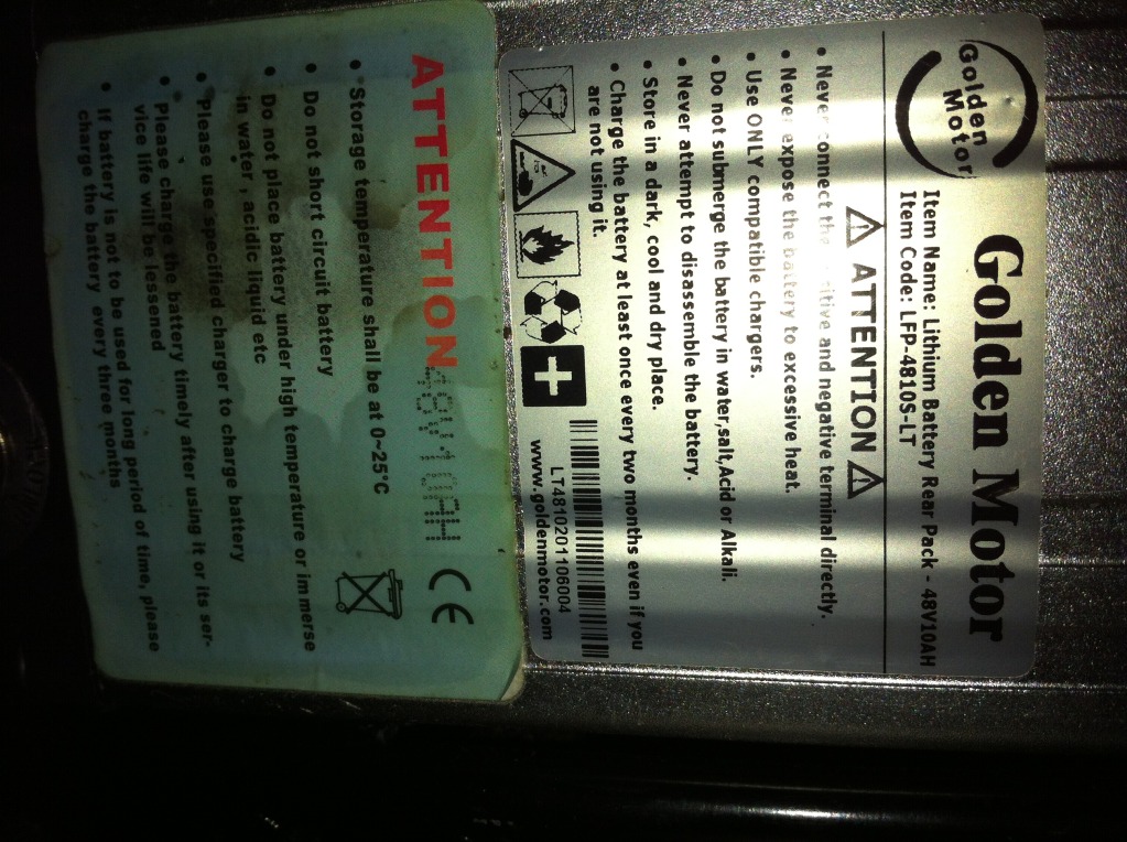

LiFePO4 cells are typically 3.2V nominal and 3.7V max, and 13 of these would only give 41.6V nominal and 48.1V fully charged, which is a lot lower than the 53V that you mentioned in one of your previous posts.
The new GM LiFePO4 packs have (LT) on the label after the battery size and a green paper label that stains easily as you can see. Why paper :(
This is one of my personal 48V10AH LiFePO4 packs
I think your pack's item code will be: LFP-4812S.
I hope this helps to clarify things.
