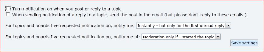

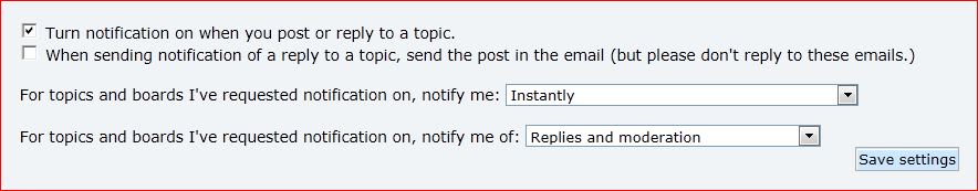

Re: Notification of replies
« Reply #10 on: February 15, 2012, 01:13:09 PM »
Oh, seems that this board doesn't send me mail notifications anymore when subscribed threads are replied to... :(
Cornelius, I've just checked your "Notification" settings on your account (and changed them while I was there) so you should now receive notifications of all replies (including moderation) to subscribed posts, not just the first unread reply.
If other members are not receiving replies to subscribed topics, check your Notifications Settings.
If notifications have not been enabled, it should look like this:
Simply select the check-box to turn notifications on and then set the other two drop-down menus to whatever you prefer:
(Don't forget to click the Save settings button after your preferences have been set)
Further information regarding notifications can be found here.
If your email address has been changed since you first joined the forum, you will need to update it in your Account
Settings
