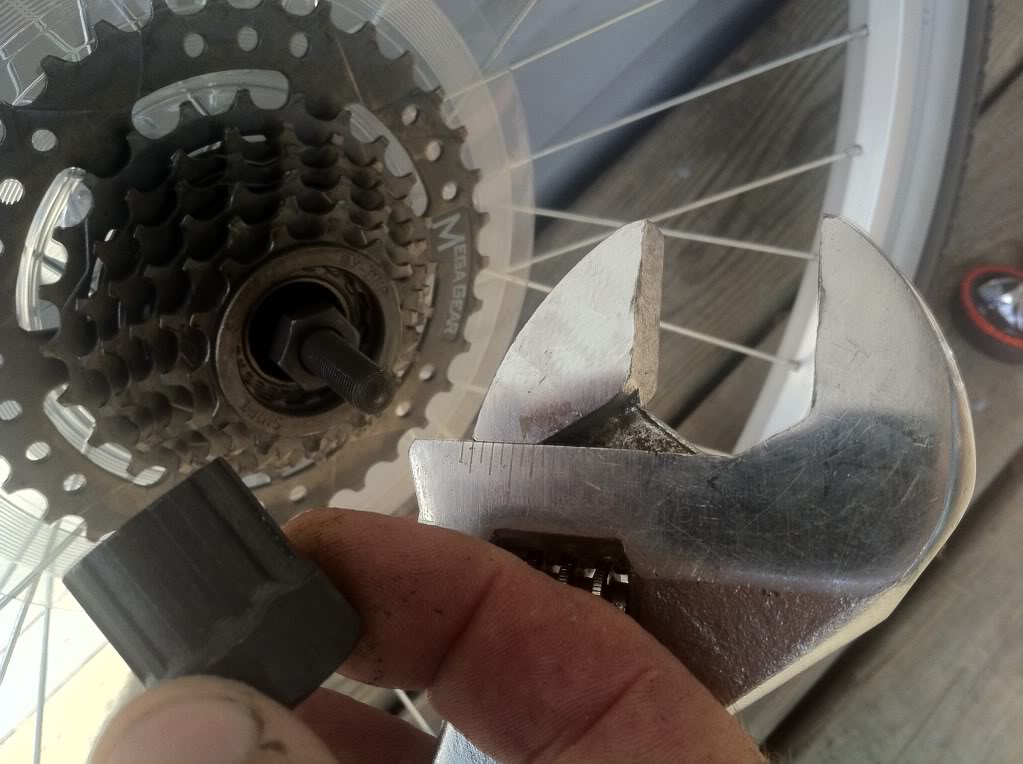

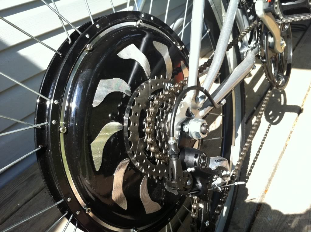

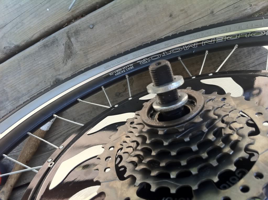

Then with the wheel removed, you have to unscrew the freewheel in an anticlockwise direction using a freewheel removal tool and a suitable wrench. This is if you want to use your existing freewheel. A six speed is ideal; a seven speed will involve a little bit more work.

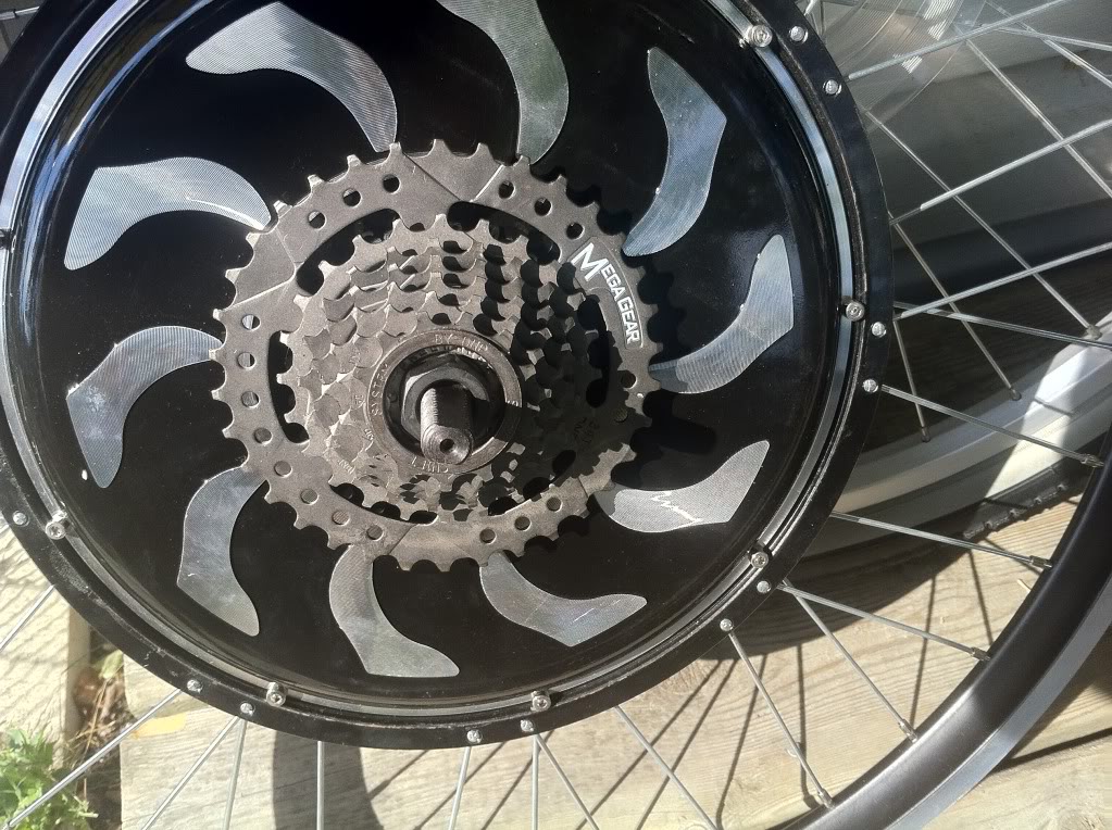

Next you have to carefully spin the freewheel onto the new wheel. Tighten it as much as possible by hand and then check that it still free-wheels easily in the reverse direction.
If you are using our 6 speed freewheel this should work fine. If you are using a seven speed or any other it may bind and not freewheel. In this case you have to remove the freewheel and add the spacer ring you should have received with your kit. You may want to look at the first part of this video to see what I mean about the freewheel possibly binding.

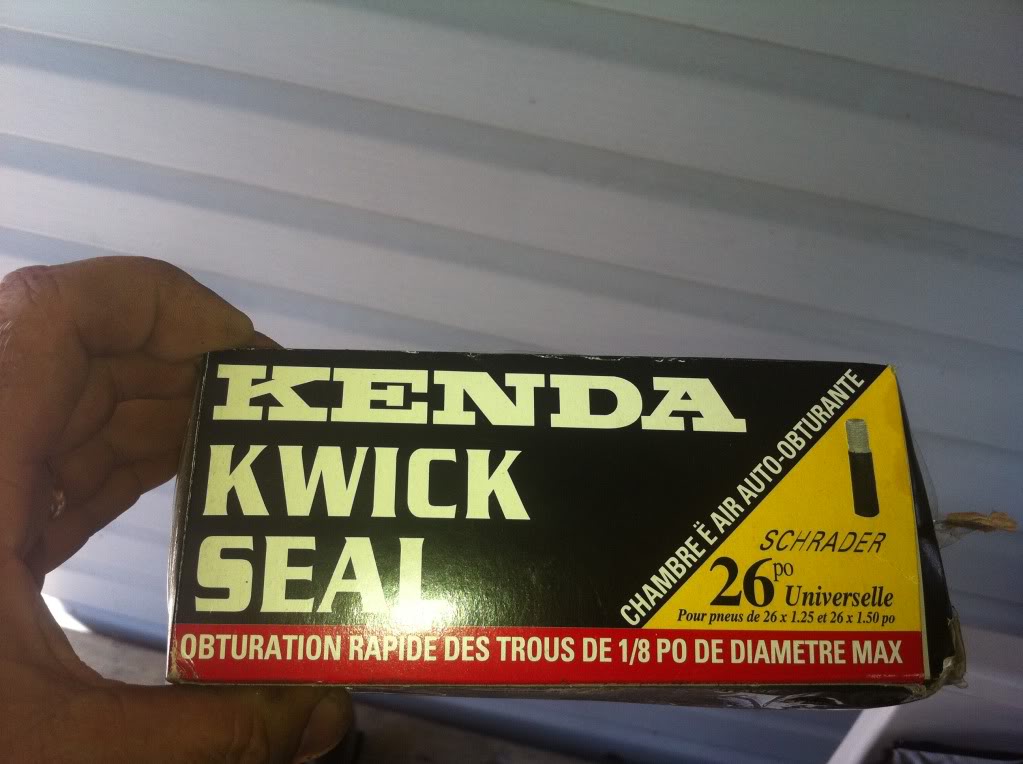

Next remove the tube and tire from your existing wheel and fit them onto the new wheel. I usually replace any cheap tube at this point with a nice thick self sealing tube like this one.

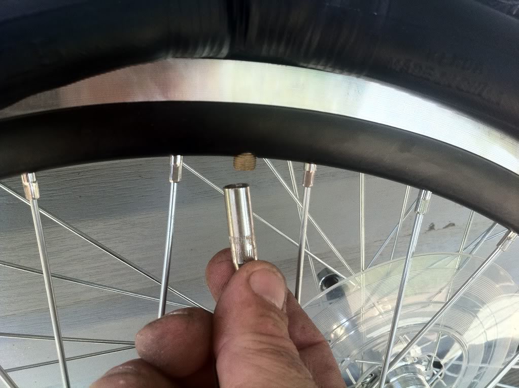

I find fitting a valve extension is very handy here to keep the valve from going inside when you air it up. They can be picked up at any tire shop.

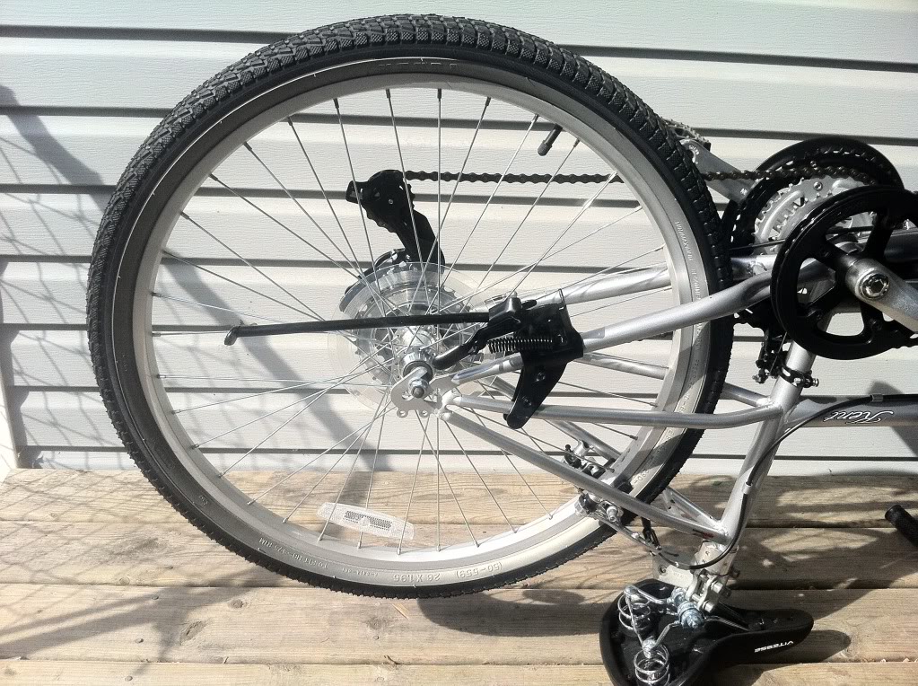

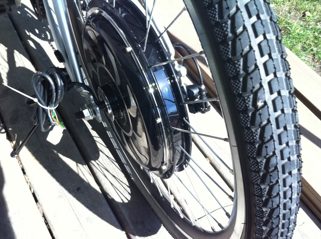

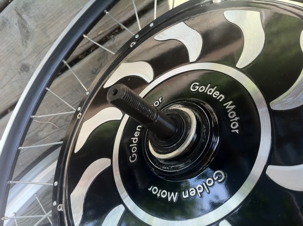

Next take all the washers and nuts off the wheel except one flat one on each side. If you are using a seven speed freewheel you will need to have at least 2 or 3 washers on that side to prevent the freewheel from binding against the frame. You also have to ensure the washers do not make contact with the freewheel in any way or it will bind.

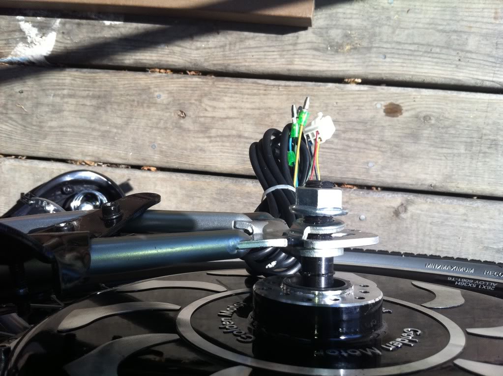

Next place the wheel into the frame. Be sure the wires do not get damaged and are pointing in the direction you desire. The washers are positioned as shown. First one flat one (2 or 3 if using a seven speed freewheel), then the bike dropout, then the lock washer with the tab pointed into the opening of the dropout followed by the nut.

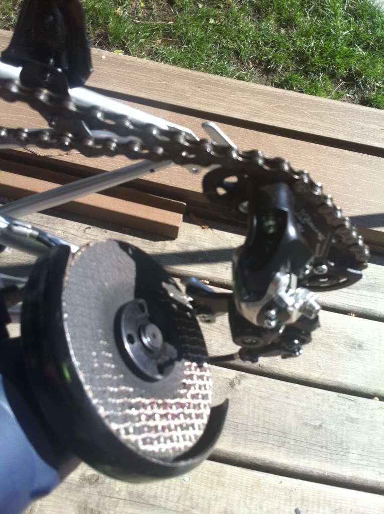

If it fits ok great, but sometimes the dropout slot is slightly too narrow and you may need to file the slot wider to accommodate the 10mm flats on the axle. This can be done with a file in 15 to 20 minutes or an angle grinder in 15 to 20 seconds. Be careful not to overdo it.
Now make sure the wheel is correctly aligned and the axle nuts are done up very tight before turning the bike over. Here are a couple of shots with the wheel fitted.

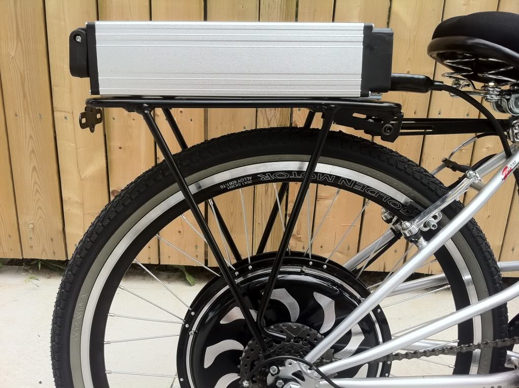

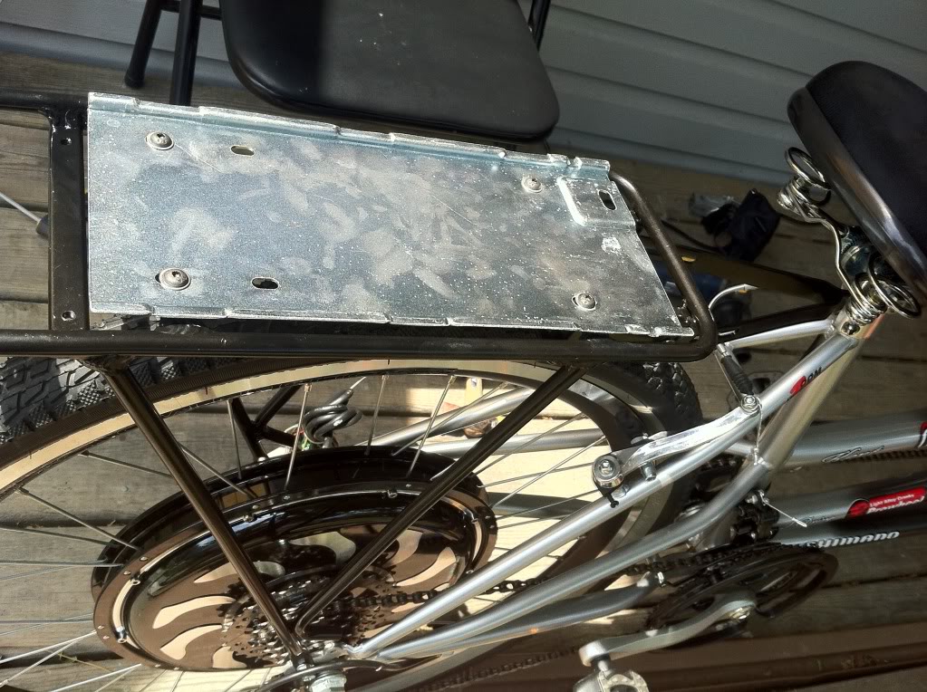

Next add the rack for the battery; this one is the rak-001 (standard rack). I prefer this rack as it is very strong and doesn't move.

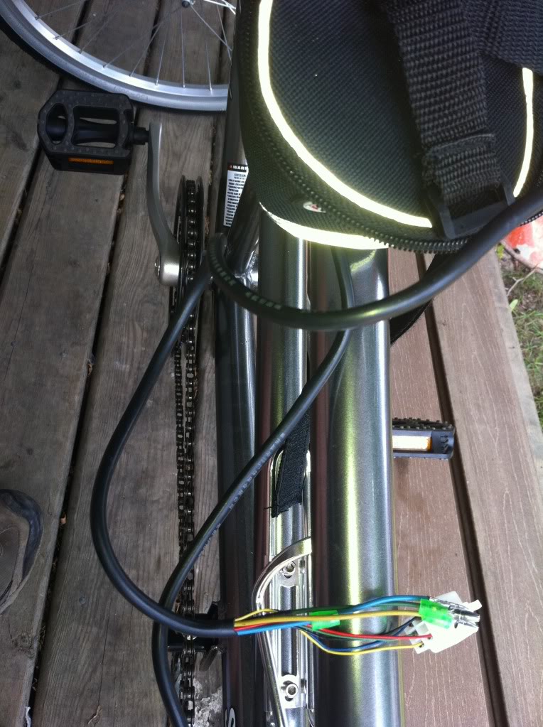

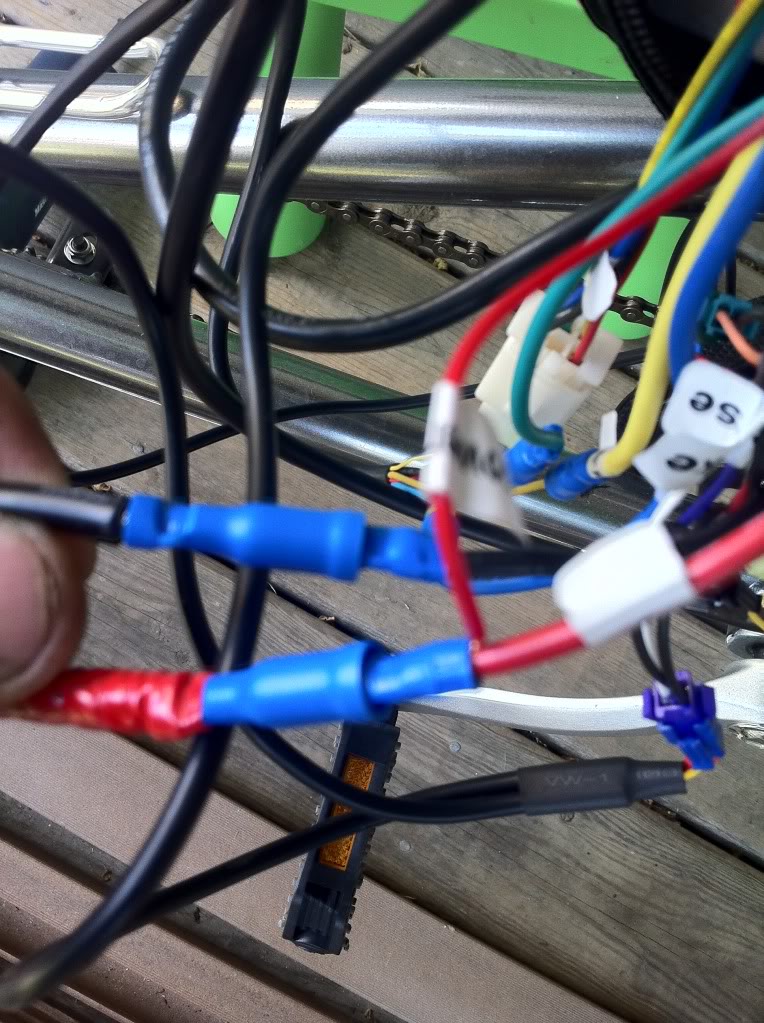

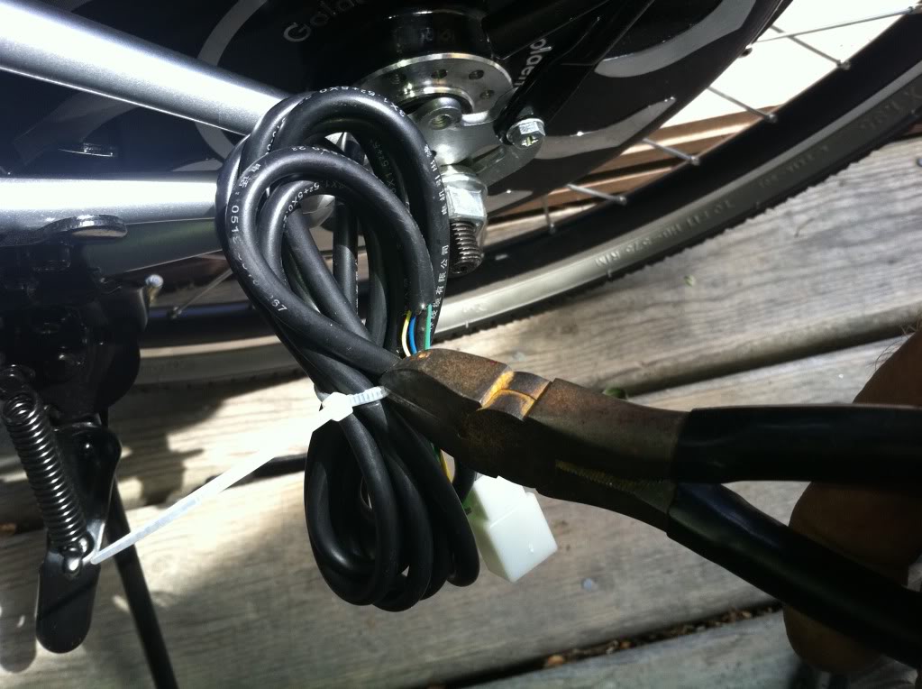

Next pick a location for all the wires to meet the controller. I like hanging a pouch under the seat. Others prefer the controller box under the rack. Remove the plastic tie from the motor wires and then run them to the Pouch (in my case). In through the bottom and out the zipper opening.
Now connect them to the controller wires as shown.

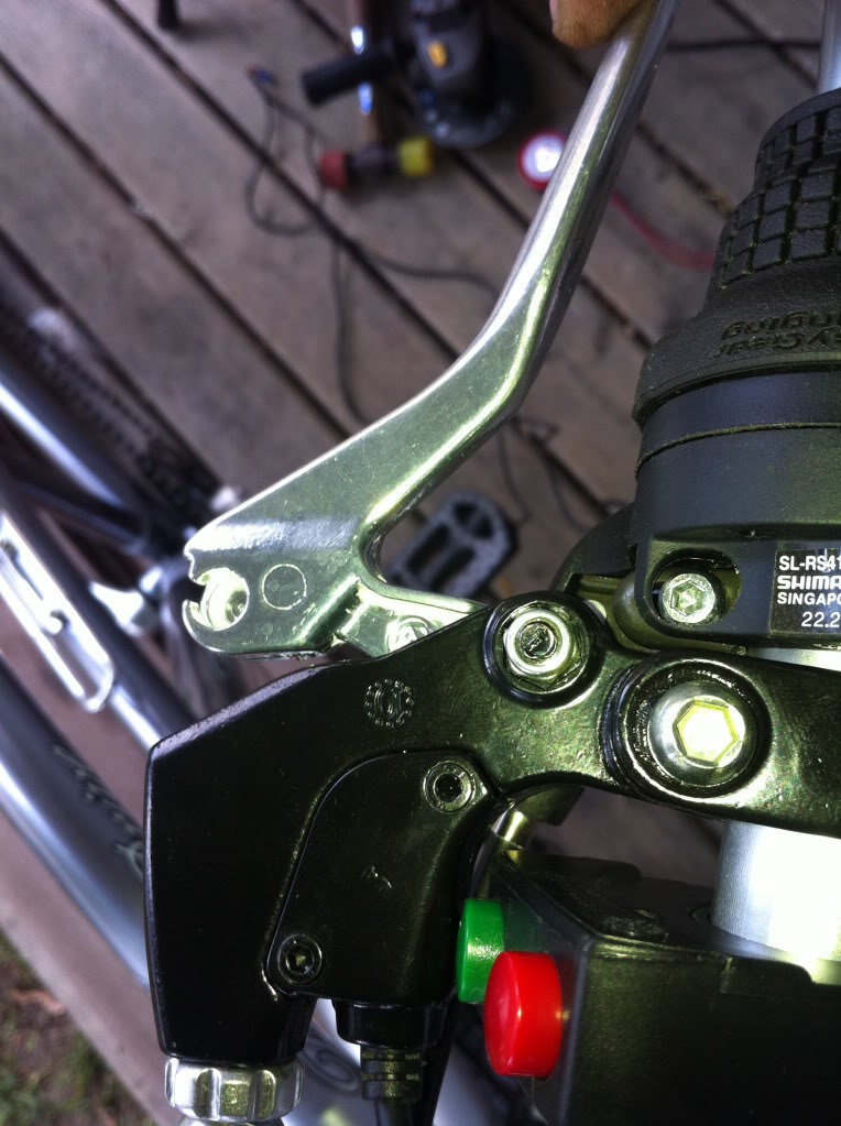

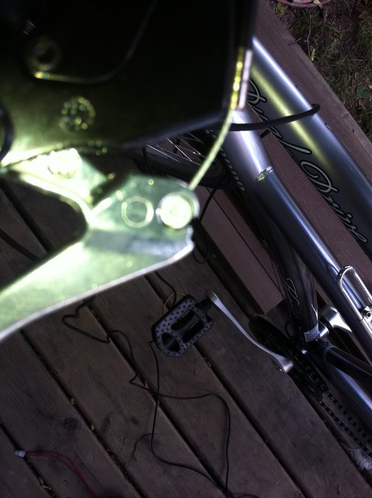

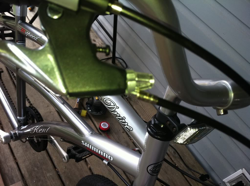

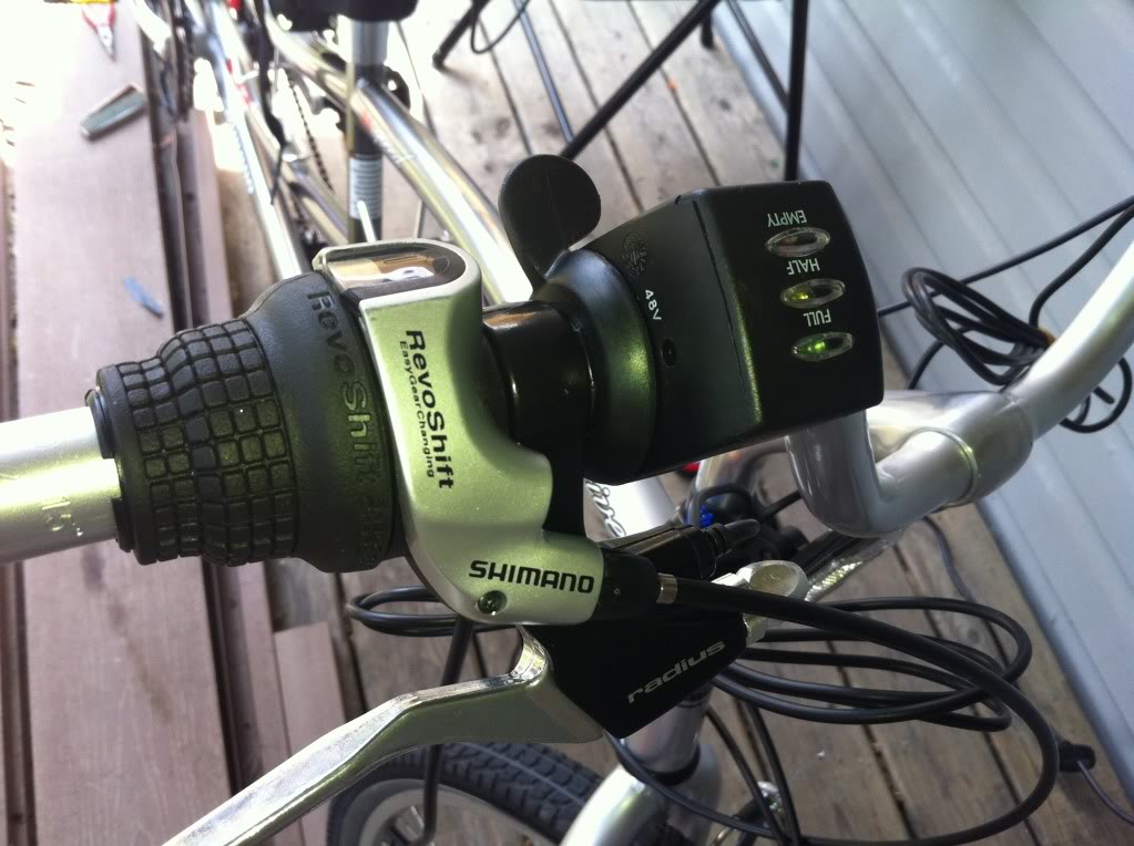

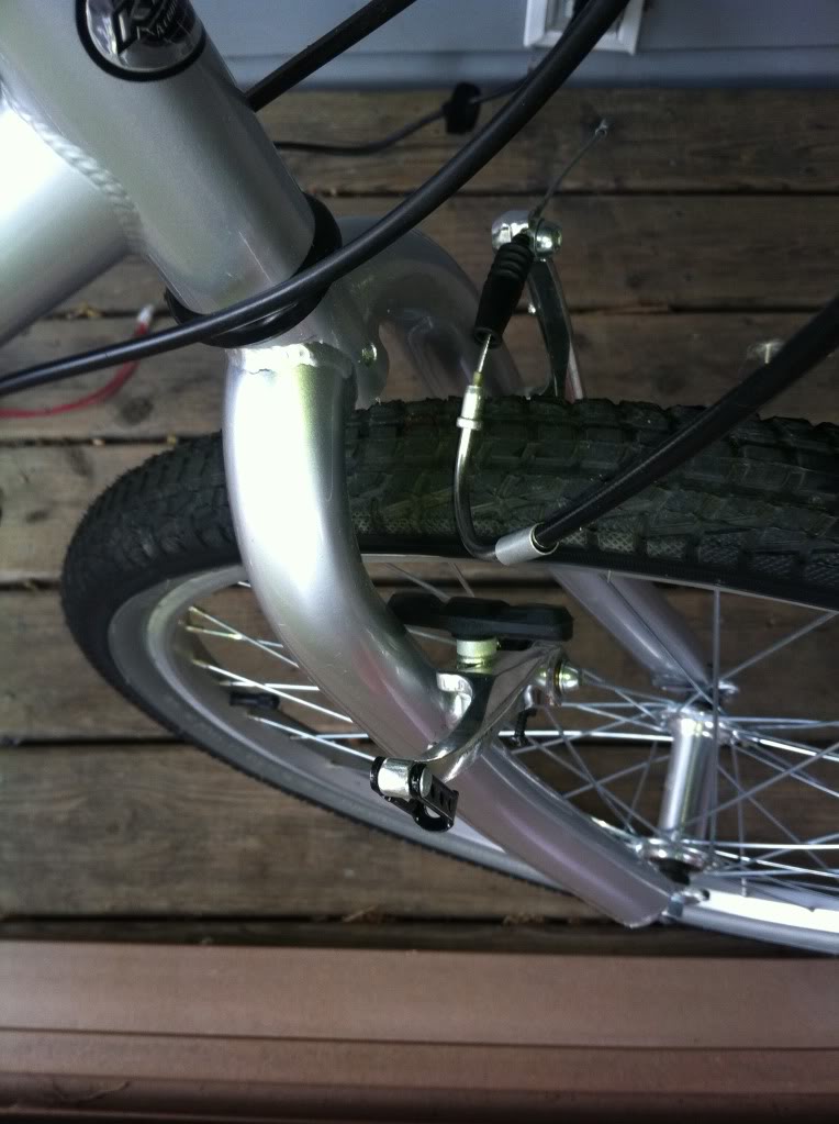

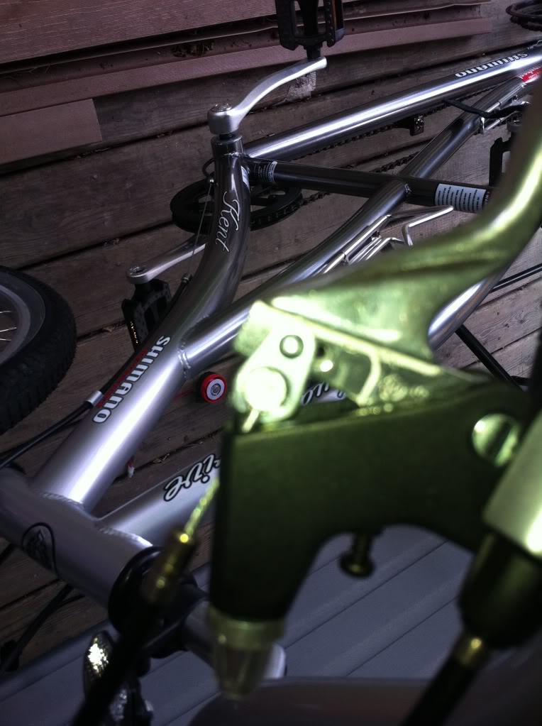

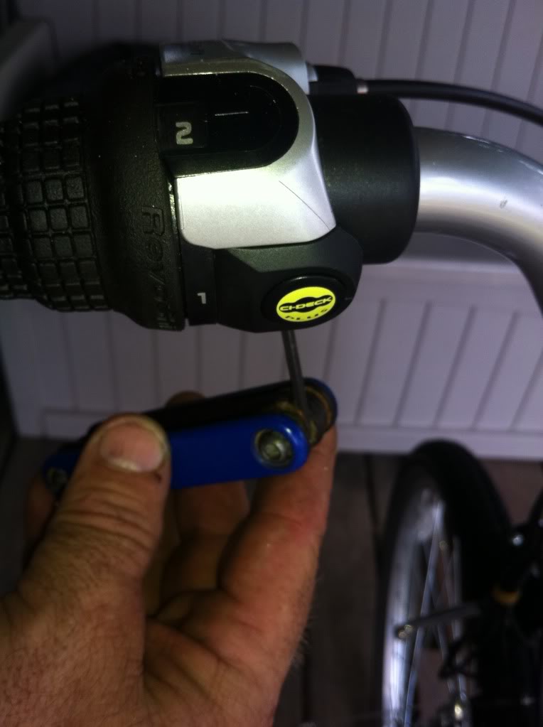

The motor is now installed; let's move on to the controls. First the brake levers need to be removed, the brake cables can stay you are just replacing the handles.
Once the cables are disconnected you can remove everything from the handlebars and install the throttle, control buttons and power brake levers. Although the old rubber handle grips are usually a snug fit, they can sometimes be removed quite easily by using the slackened brake lever assembly (or the twist gear selector) to push them off by applying force to their inner end, instead of trying to pull the grips.
If the rubber grips have holes in the outer end, put your finger over one hole and use a bicycle pump or airline on the other end to simply blow them off. If they still refuse to budge (and you are not intending to reuse them) you may have to resort to cutting them off.
Then reconnect the brake cables to the new levers. Tighten everything up and add the new handle grips. Depending on how much room you have they may need to be trimmed to fit.

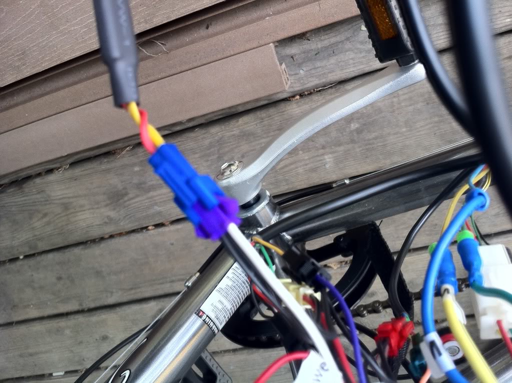

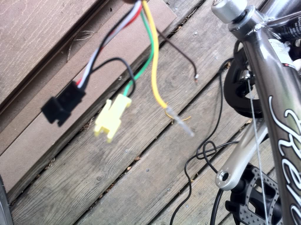

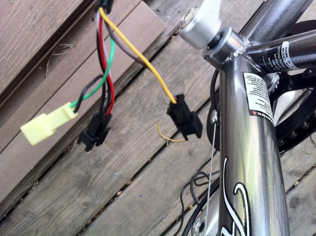

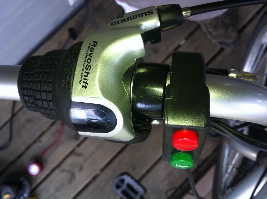

Now for the wiring of the controls. First the wires from the throttle. The black 3 pin plug is the throttle plug. The two pin yellow plug is for the battery indicator LED’s in the throttle and the two loose wires are from the red switch on the throttle.  This can be used for lights, reverse etc.
In this example I'm using it for the reverse function.  Look in the bag of extra plugs you received for the 2 pin black one and add it to the loose yellow and black wire from the throttle.
Now plug them into the matching colored plugs from the controller.

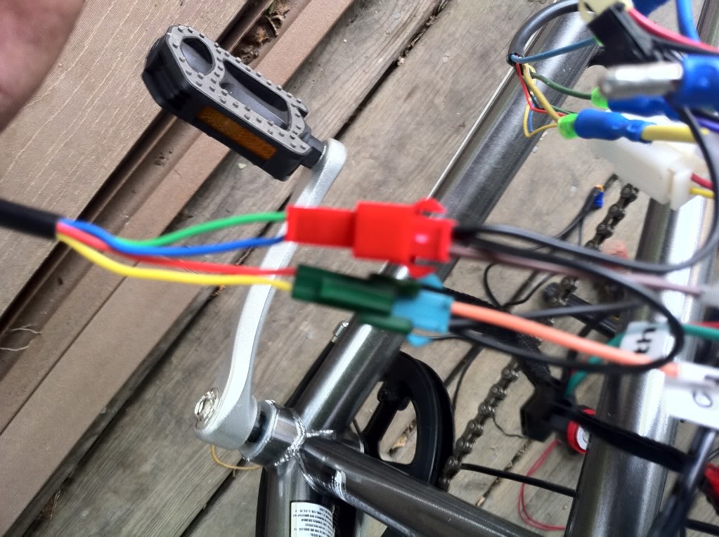

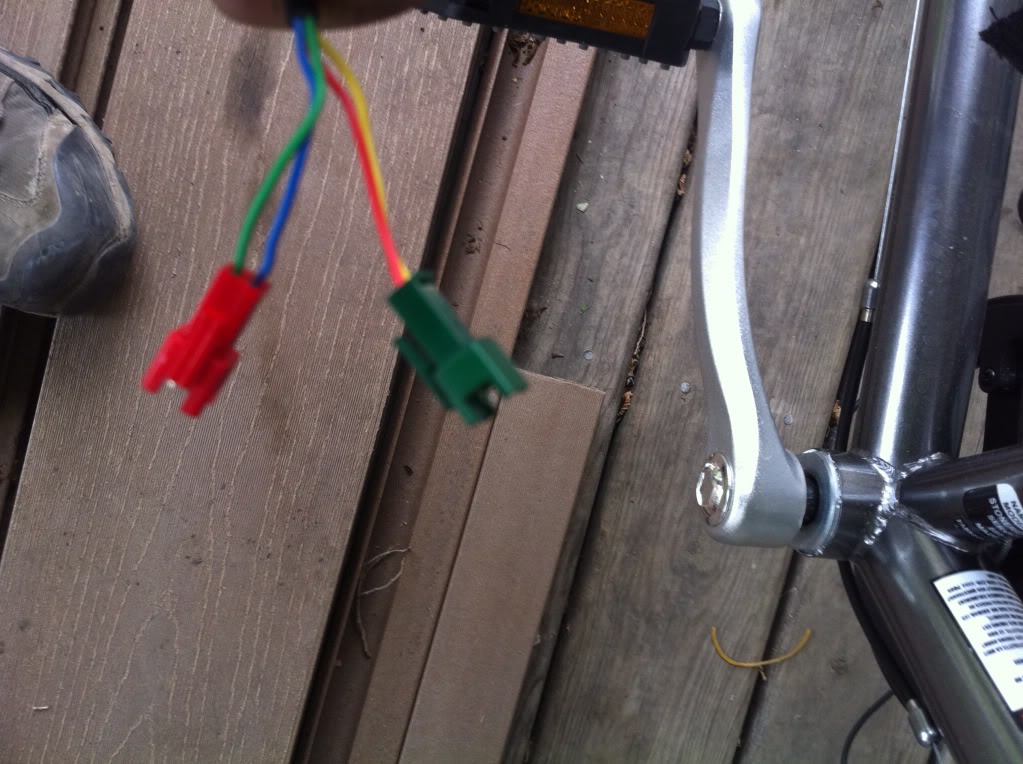

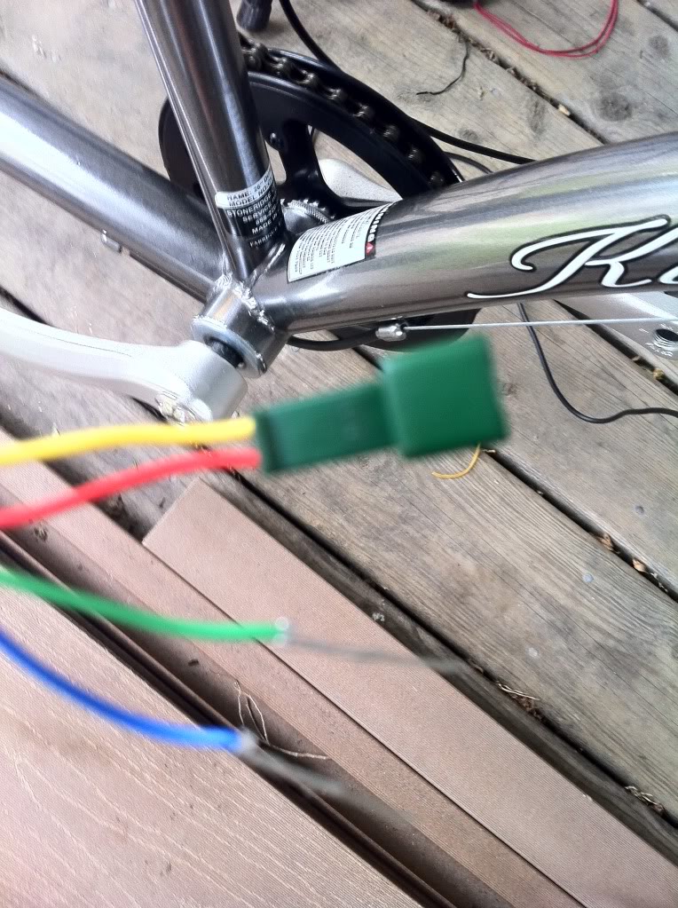

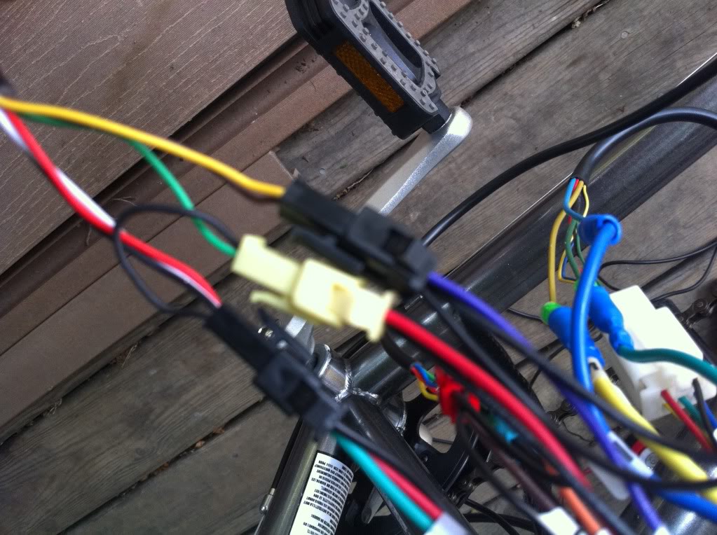

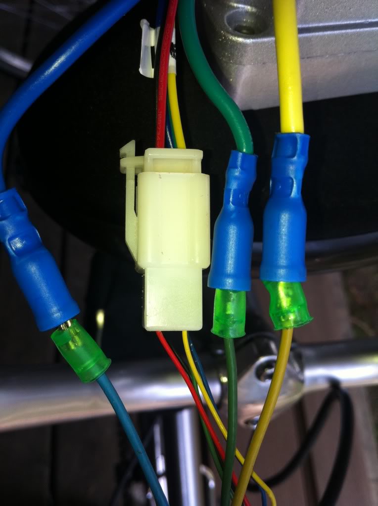

Next the 4 wires that come from the 2 button switch. The yellow and red are usually in a green plug. That is for the red button on the switch usually used for cruise control. The blue and green is for the green button which we will use for the horn.
Please note if you have a 3 button switch you should have a look at this
photo of the 3 button switch wiring
Add a red plug to the green and blue wires.
Then plug the green and red to the matching colored plugs on the controller. Please note that the green plug on the controller is a different shade of green but it should be tagged cruise.
Now for the brake levers. Plug the blue plug from the brake levers to the blue plug (sometimes purple) on the controller.
Next hook up the black and red wires from the battery to the black and red wires from the controller.

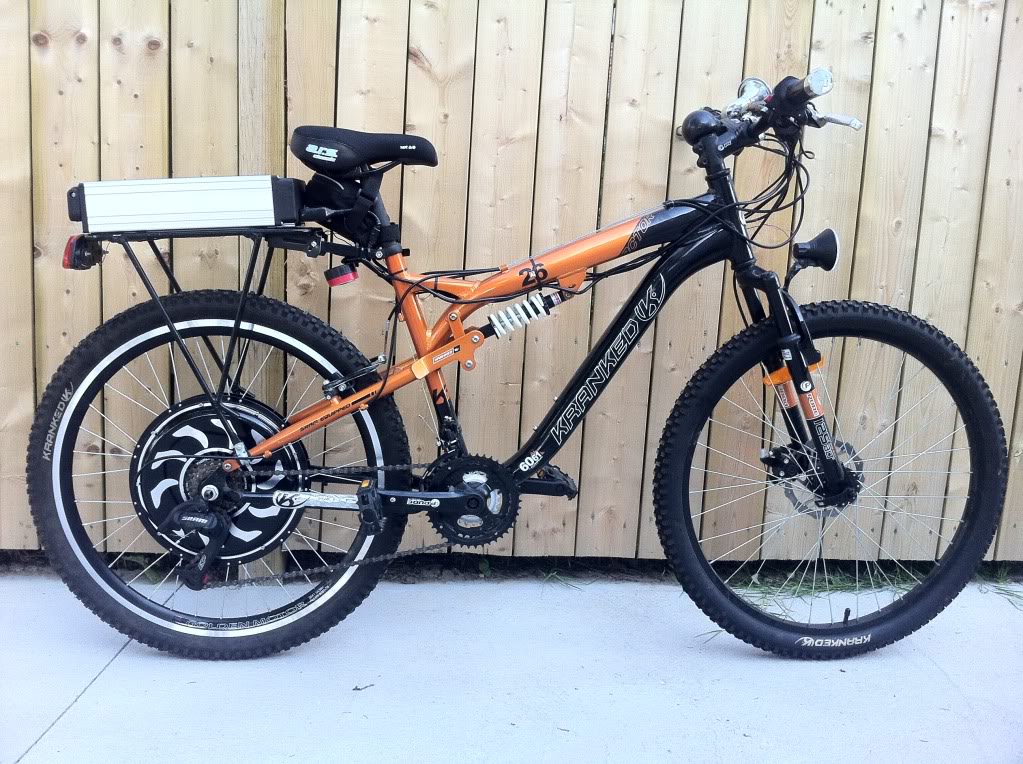

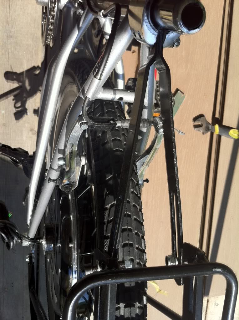

When I was doing this I was thinking about all the side stories to doing an conversion. It seems every bike brings its own set of challenges. This bike I had to mount the rak-001 different then any other I had done. Usually there is a seatpost bolt with a lever to tighten the bolt like on my Wifes ebike shown here below. Not a real close up but you get the idea.

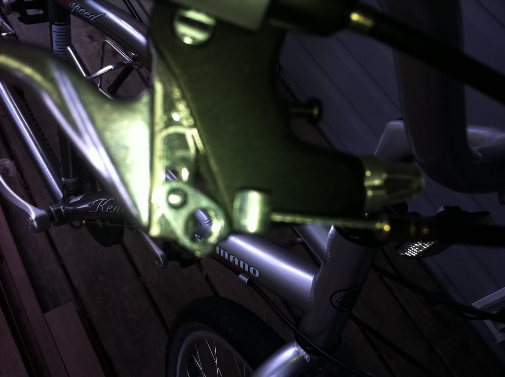

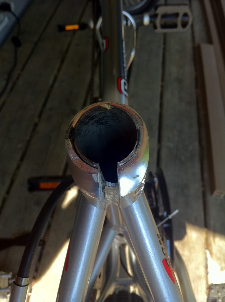

This bike has a different seat post clamp. Its large with 2 bolts sunk in and the usual method wouldn't work. So I again took out the grinder...

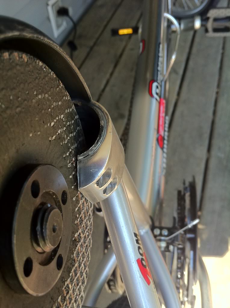

Opened up the slot in the frame where the seatpost goes in...
Then I added the arms for the post on the inside of the clamp. Then the bolt still goes though the original way.
For a very clean looking setup. Except for all the fingerprints on the plate :)

Actually While I'm at it. Look at the way the bottom of the rak-001 is mounted on the wifes bike.
You can see there are no holes for mounting the rack as its a full suspension bike. To fix this I picked up some conduit clips at the local hardware store. Wrapped some inner tube around the frame then wrapped the conduit clip around that. Then attach the bottom of the rack with a bolt and lock nut. This method has worked on several bikes for many miles.
