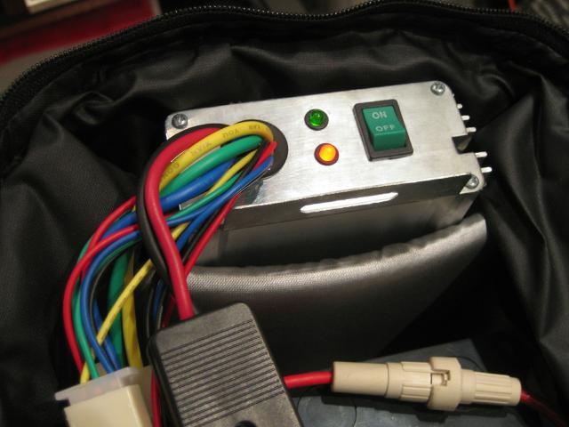

It was one of the first mods I did, and I've done it to all four of the controllers I have...
The switch is ganged (and good for 32A at 250V), but the internal arcing which must occur each time the switch is thrown will probably eat the contacts eventually.  I've been thinking about putting on a additional momentary switch (with a series resistor) in parallel with the main switch in order to permit a low-current "precharge" of the caps before throwing the main switch.
So far, still working great as-is after many many cycles...
