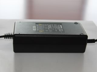

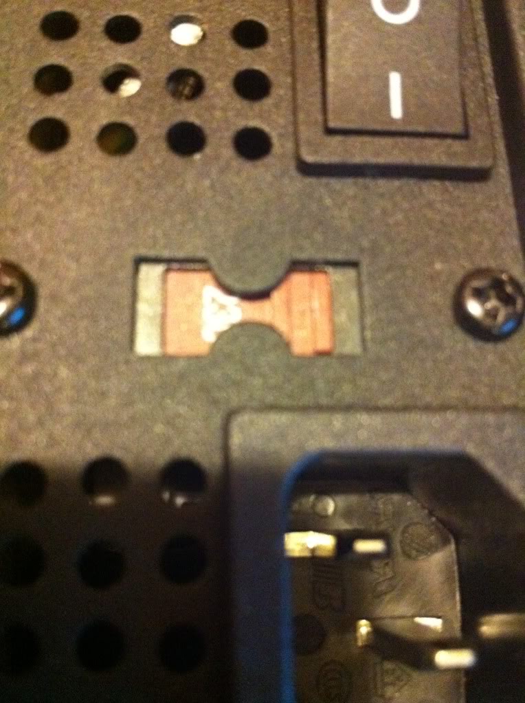

Any chance someone can post a picture of this switch to show exactly what it looks like?
Not the clearest pictires, but they should do. It is a simple sliding switch the seems to be easiest to flick with a ball point pen. When you flick it back and forth it should move quite freely and you can tell it is working by how it feels. I have had one charger the the switch made no difference. It didnt feel right when you flicked it and it always stayed in 230 mode. At least I assume it was stuck on 230 mode and  that is why the charger didn't work.
Also the 2 amp chargers GM has are auto voltage switching and no switch exists for switching voltage.
They come in 24v2a, 36v2a and old style 48v2a and look like this
The new style 48v3a with the voltage switch looks like this.
« Last Edit: May 14, 2011, 02:04:06 AM by GM Canada »

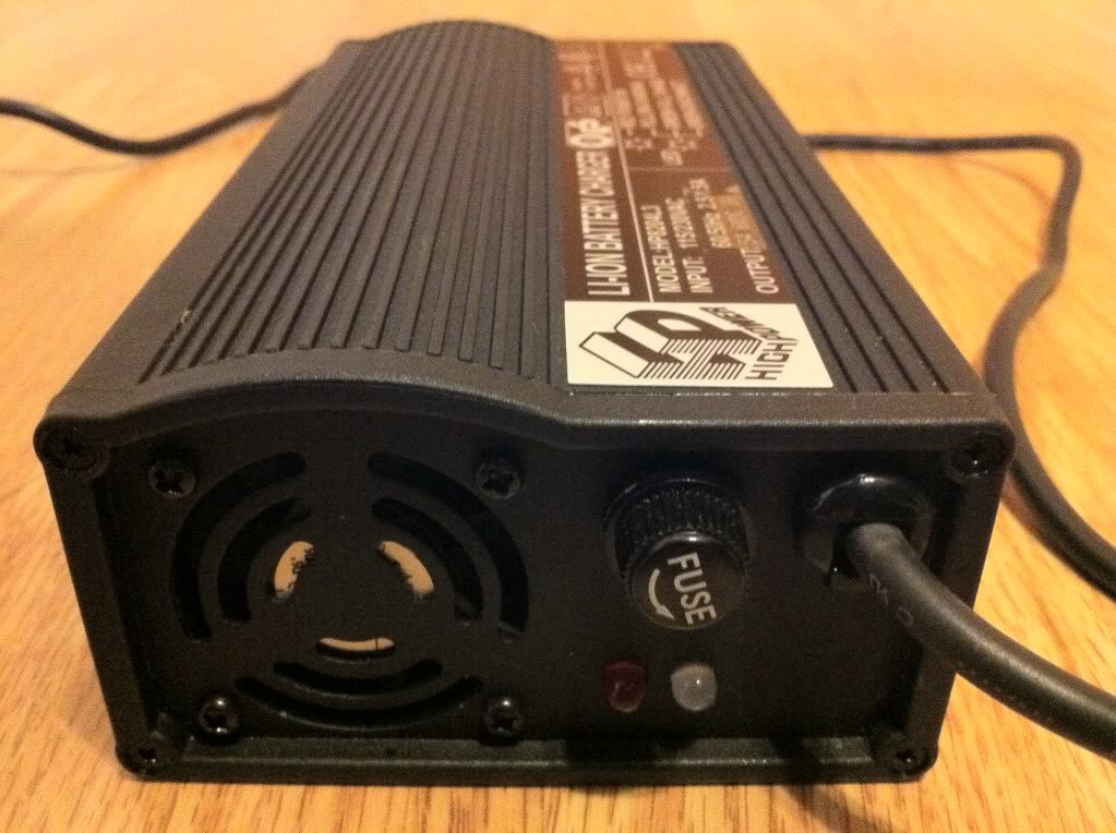

Can we see any pictures of the charger details. Like what exactly does it say on the charger.

There is a pic of the charger label too.
