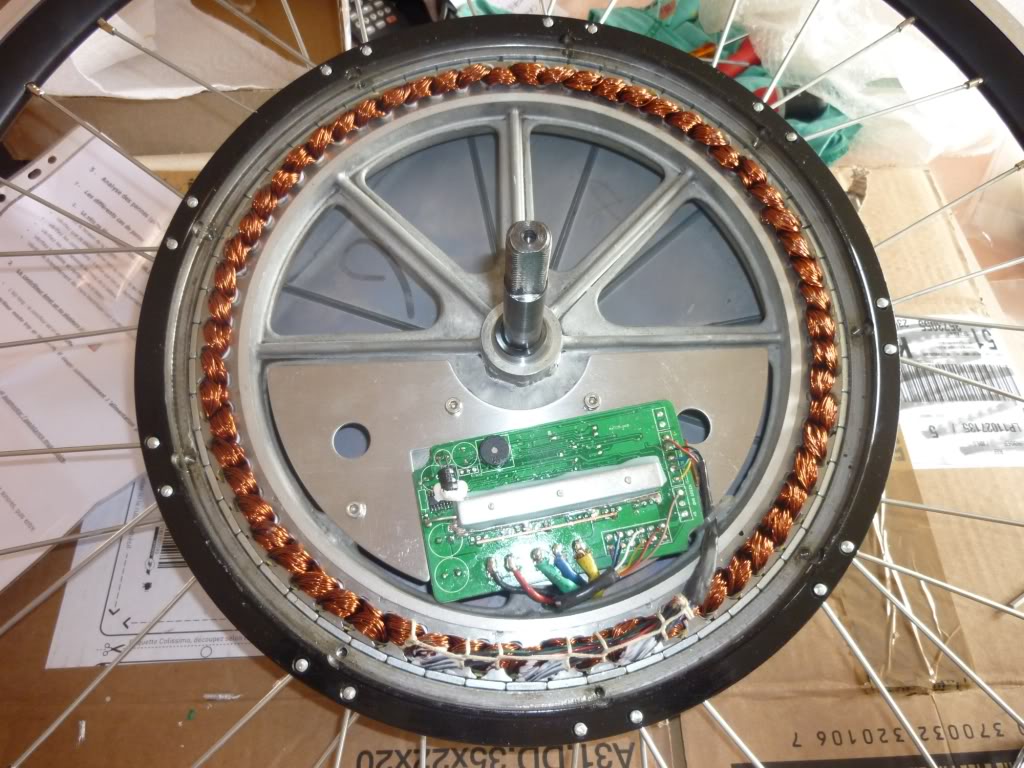

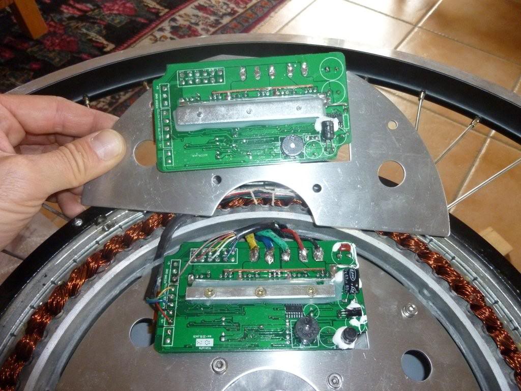

Here are a few Pictures of what appears to bethe successfull replacement of a failed internal controller. Everything appears to be working and this person is waiting for sun to do a full test drive to confirm everything is good.
Before the replacement you can see the controller is actually different.

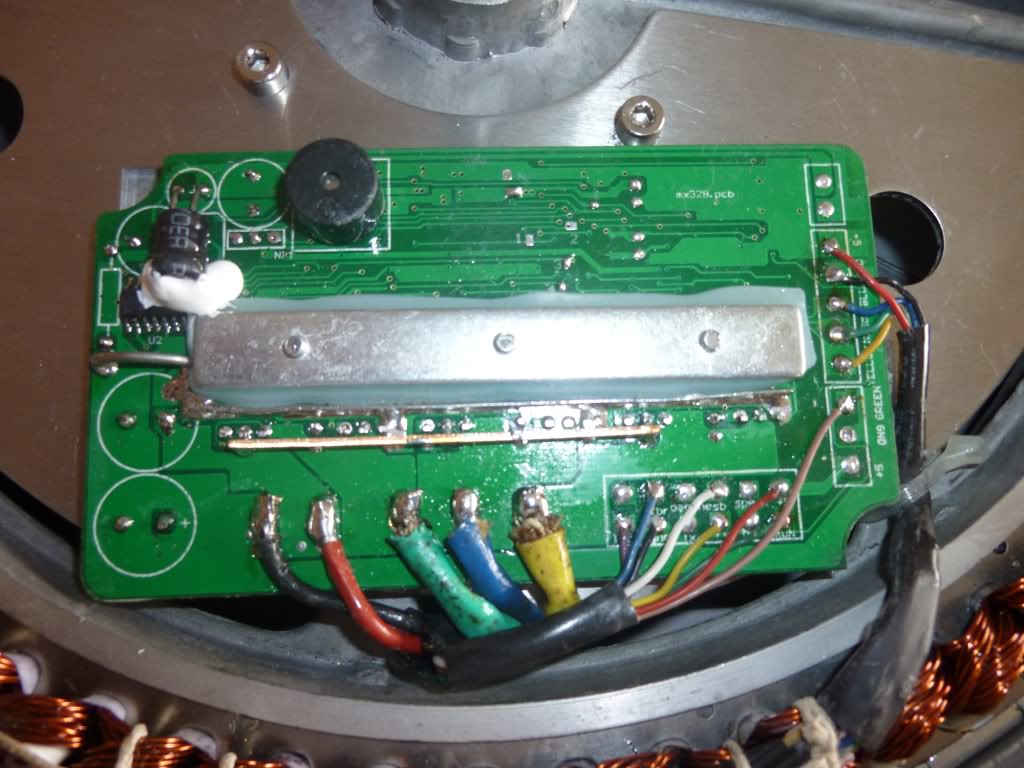

After the replacement.
I thank you for your permission to use these photos to help others and hope to hear how well the test drive went. You can just let me know in email if you still prefer not to post in the forum. I will post the result here for you.

Looking at those photos I can see a potential problem, the metal strip that holds the controller tightly against the heat sink is dangerously close to the shunt loop (see attachment). If it's touching against the shunt, it could very easily cause the shunt to be bypassed completely, if the bicycle frame and the battery negative are not isolated.
This could quite easily be the case if a set of GM LED lights have been fitted with their fixing brackets grounded to battery negative. I don't suppose the lighting cables alone would make much difference, but if a thick lead is used to join the bike's frame and the battery negative, I think it could cause the controller to put out a lot of power ;D, but probably only for a short time. :(
If the motor seems unbelievably more powerful than before, then the above could explain it. ;)

hate to sound like a grumpy old man, but when inspecting the shunt I would probably resolder the phase wires if they are a bit questionable
and put the tape there!
:D
Things just seem a little close for comfort
