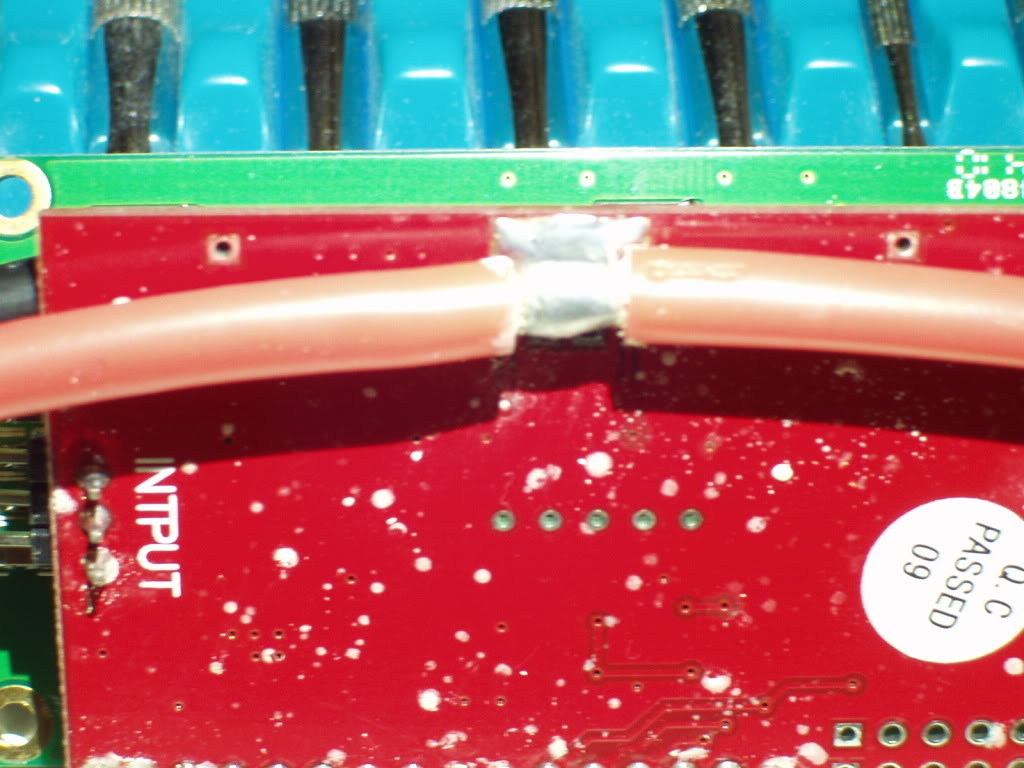

Highly unlikely, as the Red and Black wires are each a single long wires that go right through the meter, they have a small section in the middle where the insulation has been removed and the small bared section of wire is soldered directly to the circuit board of the meter. If power is not going to the controller and battery indicator meter, there must be a poor connection at the external load end of one of the two wires, or possibly a fault with your switch. That meter will allow power through these wires in both directions, but it can only monitor power consumption in one direction, or only regenerated power if the source and and load are transposed.
I made up some gender changers on mine so I can use the same meter to measure my regen current, and also to monitor my battery while charging at home:
Re-check your connections on the load side of the meter and check for voltage going into and out of the switch connections.

Re: Turnigy Watt Meter wiring correction
« Reply #9 on: May 11, 2011, 12:27:24 AM »
Unfortunately I was not right about the wires inside the watt meter. The red wire is a single continuous wire:
But the black wire is actually two separate pieces of wire soldered either side of the internal shunt:
Although they're not very clear, the above pictures will hopefully make sense.
The Black wire is mounted on top of the lower circuit board and the Red wire is mounted underneath the board.
Unfortunately my memory seems to degrade at this time of night (it's gone 1:25am here). ;D
« Last Edit: June 30, 2017, 10:51:45 PM by Bikemad »
