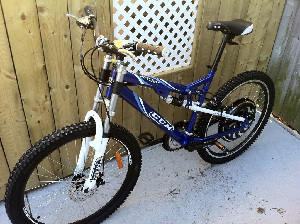

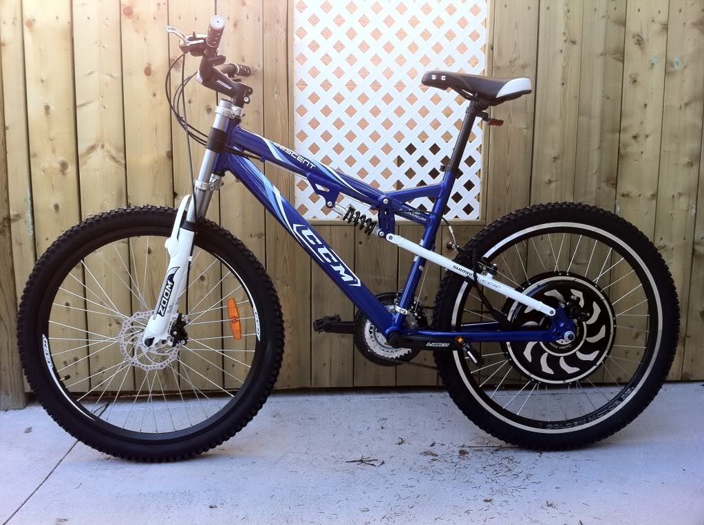

First lOOk!
Stuck A pie on it to see how it looks :)

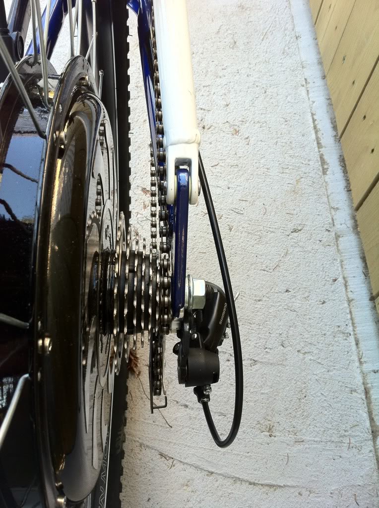

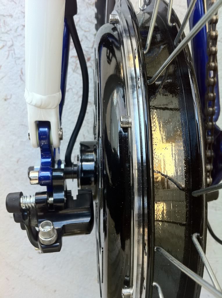

Stuck a Disk brake Activator on the back, Looks like it will line up with a disk nicely..
I was able to use the 7 speed freewheel that was on it by adding one GM washer inside. It fit perfectly no filing!
I think I am going to like this one! Hmm I think I say that every time don't I?
I think I'll keep this one real clean loooking, No GM buttons or brake levers, just a thumb throttle a seatpost rack and a small pouch under the seat for the wires.

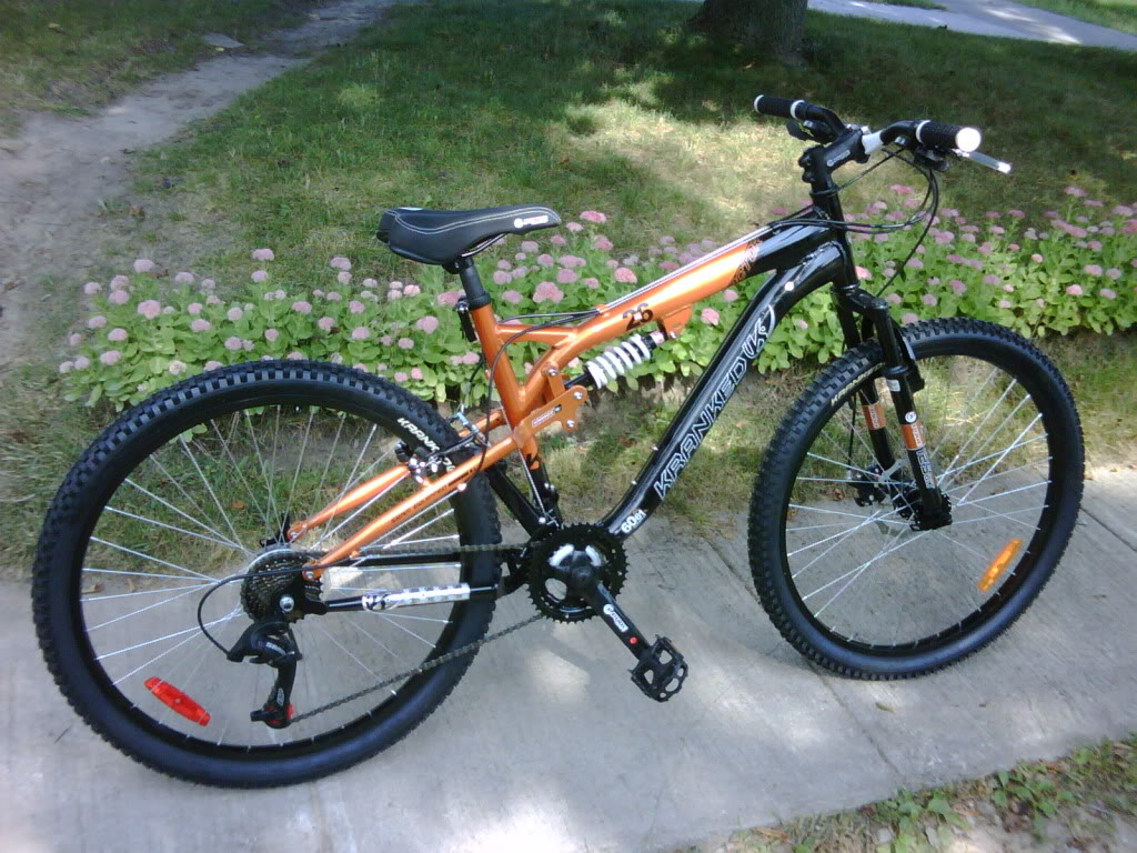

I guess the cracks in the road have finally caught up with me! Time for some smooth riding. Beleive me I have thought about it alot and when I saw half price I could not resist! My wife has a full suspension mountain bike with a HBS 36v500w and it is so smooth, even on the sidewalks. This is her bike before I converted it.

More progress..
Today I added the second pie and the Cycle Analyst. I got most of the wiring done and its all in a pouch under the seat. Still need lights. Afterall it is going to be a serious commuter to work and its often dark. Took it for a quick boot. Decided I need upright handelbar extentions on this bike so I can sit more upright. Also did not like riding without cruise control so I added that. Another quick ride to test the cruise and decided its to dangerous to use cruise and not have power brake levers. So much for a simple clean build. Since my brake levers and gear changers were built into a single unit I had to replace them with separate gears shifters and the GM power brake levers. I don't know why people resist this. The new click shifting gear shifters were only 20 dollars. Then I was toying with the idea of a socond throttle on the upright bar so I can sit upright and still have throttle control. So what the heck I added a second throttle. Then I though it would be nice to have a brake lever on the upright on the other side. So I added that. My original Brakes serviced a front disk brake and a rear center pull brake. The additional lever will go to the Disk Brake I added to the back. So now I have three power brake levers and two throttles. Pictures to come tommorow when I get a bit more tinkering done.
Oh yeah, I also added a drink holder. I guess I am to predictable sometimes.
