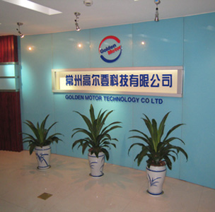

Found these pics on fourm.Looks like someone else spelled it wrong to lol.
« Last Edit: March 16, 2011, 11:34:39 AM by rollin76 »
Re: It's Golden Motor not Golden Motors
« Reply #6 on: March 16, 2011, 12:30:23 PM »
The label looks good except for the spelling of "golden motors" instead of "golden motor".
Yes I left the s and co from name because it was hard to clean up on windows paint so that the lettering was clear when you shrink pic down.
Rollin, you seem to have missed Gary's point, there isn't supposed to be an "s" on the end of Golden Motor, but you have added one making it incorrect, in the previous pictures it was spelt correctly, but on your label it is not. ;)
I would suggest a Voltage and Maximum RPM which is correct for your battery and wheel size or perhaps don't mention wheel RPM.
(See attachment below.)
The maximum power allowed should be the motor's actual output, not what it uses.
A 500w motor would need to use 625 Watts of power @ 80% efficiency (26Amps @ 24V) to produce the 500W maximum output.
If a hubmotor was only 50% efficient you could use up to 41.67Amps @ 24V (27.77Amps @ 36V) without breaking the law.  ;)
