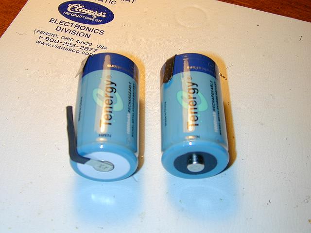

Ack.  This is easier...  Here - pictures help...
The one on the left was what came with the first order (I was impressed with these).  The one on the right I'm not as happy with, and this appears to be the same cell they're selling on eBay.  As you can see, the tab on the positive terminal is missing.  Fondly remembering the late Steve Irwin, I can only say (in my best mock Aussie accent), "I barely touched the beggar, and it came ROIGHT off"...
