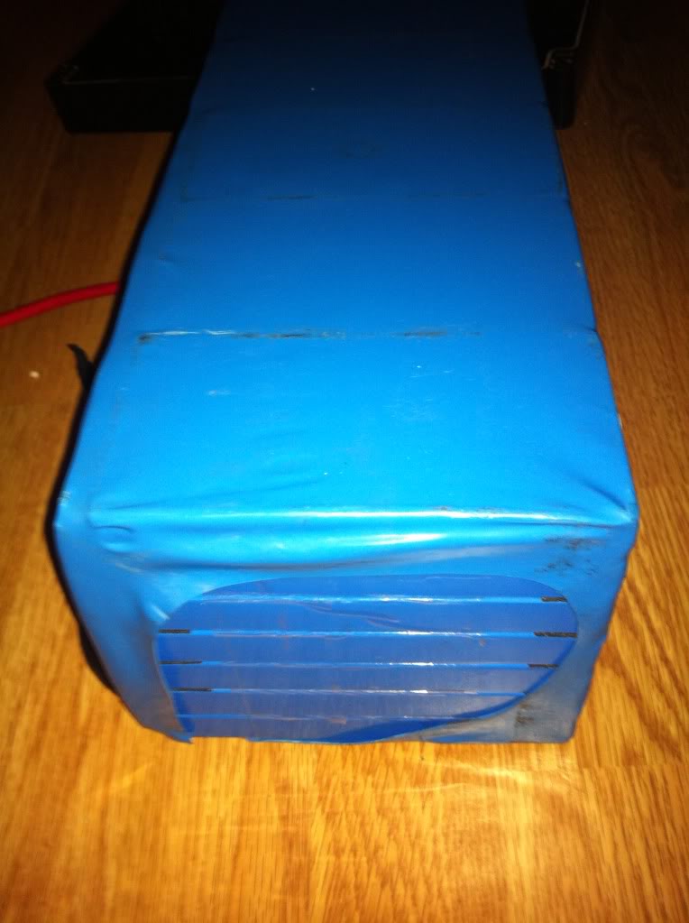

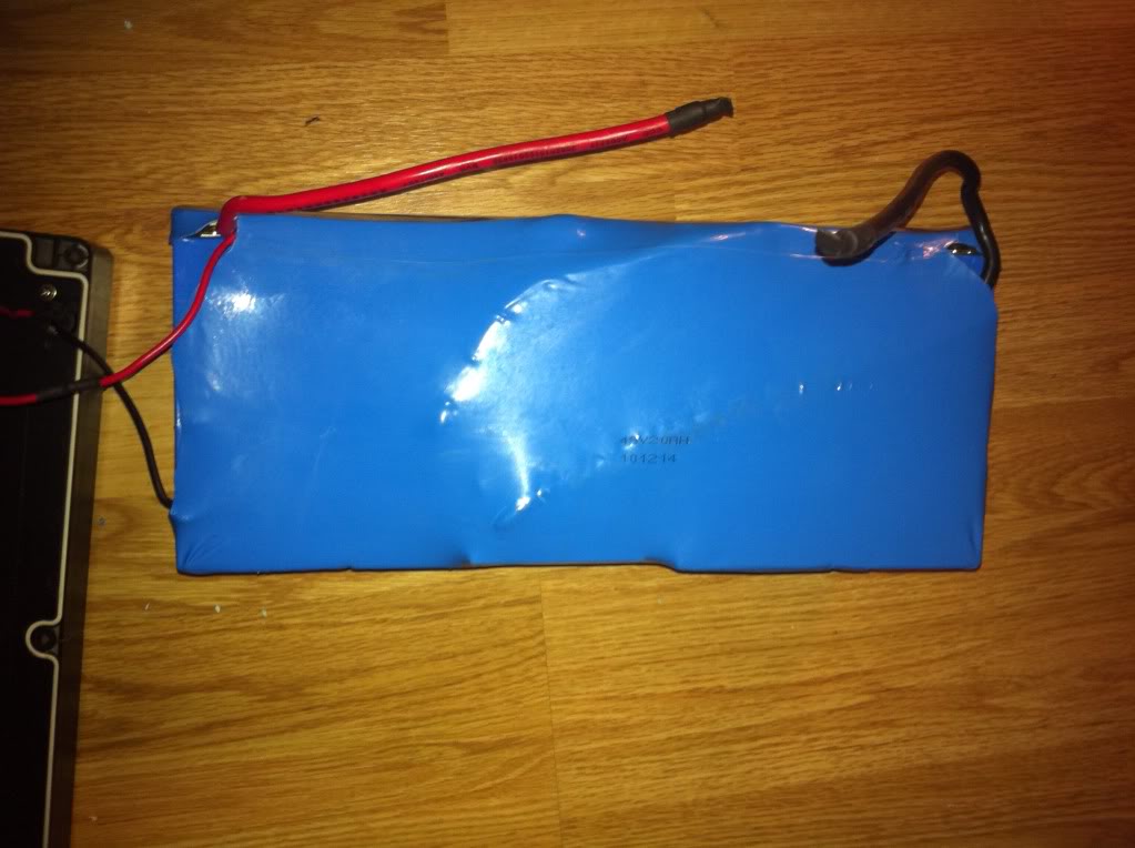

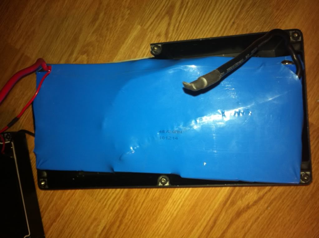

The 48v 20ah looks like ping batt with case off.Pack is made from 32 cells shaped like a pack of cigerettes.cell dimensions L 140mm W 65mm H 16mm pack size L 330mm W145mm H 125mm with out outer shell.Gm believes my pack is fine and want to send me new case.One cell corner is crushed.Not to bad.cells have square corners and this cells corner is rounded a bit.Will this make a differance?the top of case is crack half way across width of batt right over top of bms.What would happen if bms does not work and I charge this batt?Could it catch on fire?batt should be tested to see if cell damaged or bms functioning.It should  be fix first because if I use it amd bms is not working would that not ruin batt completely?denting lifeop4 cells is not good for them is it?I think I should be packing this batt up send it back and wait for new one.batt could work for while and die in 6 months because of this.It would be real fun trying to get a warranty claim on a batt few months from now if gm wont replace it now after it arrived almost broke in half..Maybe gm should package fragile items better in the future to prevent thing like this from happening.Save money in the long run.You would think they have some kind of insurance for this.

Please do not worry about your warranty. My reputation is rock solid and I will not let you down. If there was any doubt of this I'm sure you would find something negative in the forum about me somewhere.
That being said, GM does not want to just send you a new battery without tests to see if there is a problem with the one you have. They seem to feel a new case and a charger with the proper cord will resolve this. I think we have to wonder down that path to see where it leads us. They feel since it is lifpo4 it is safe to use and recommends a good test ride to see how well it works. Can you put a meter on it, record the voltage, run it until the bms kicks out and see what the voltage is then? Worse case scenario is I will be zooming around with that battery. I always wanted to try one anyway.
« Last Edit: February 15, 2011, 02:22:44 PM by GM Canada »

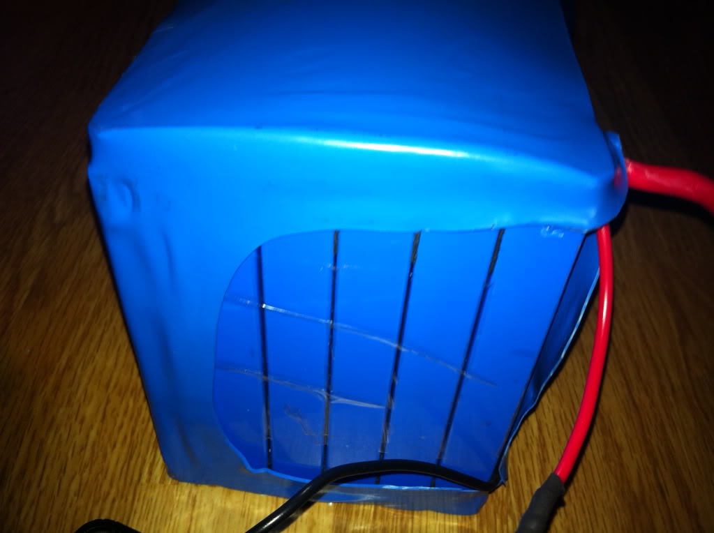

Rollin 76 even a small dent in a cell will become a problem down the road. its lifepo4 theirs no risk of fire but if that cell shorts there will be heat and smoke don't charge that pack unattended. case is one thing crushed cells is warranty.

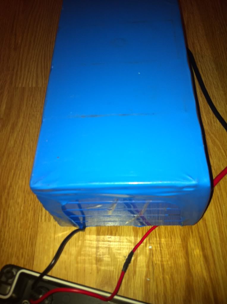

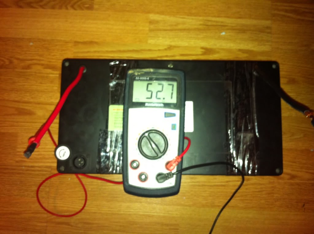

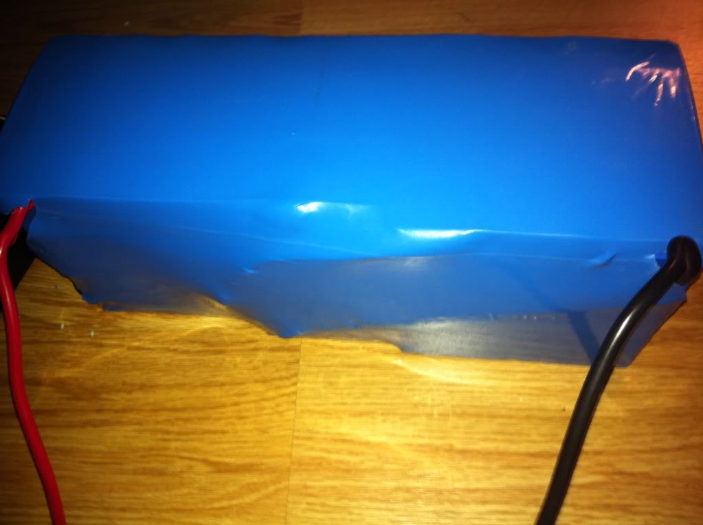

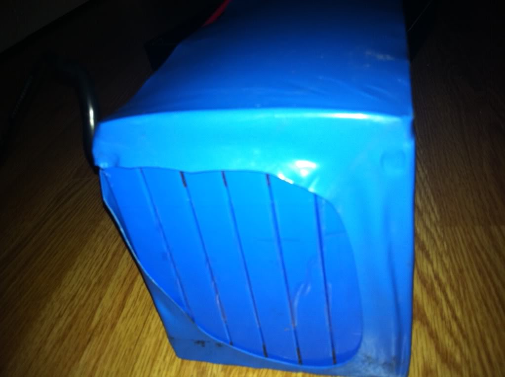

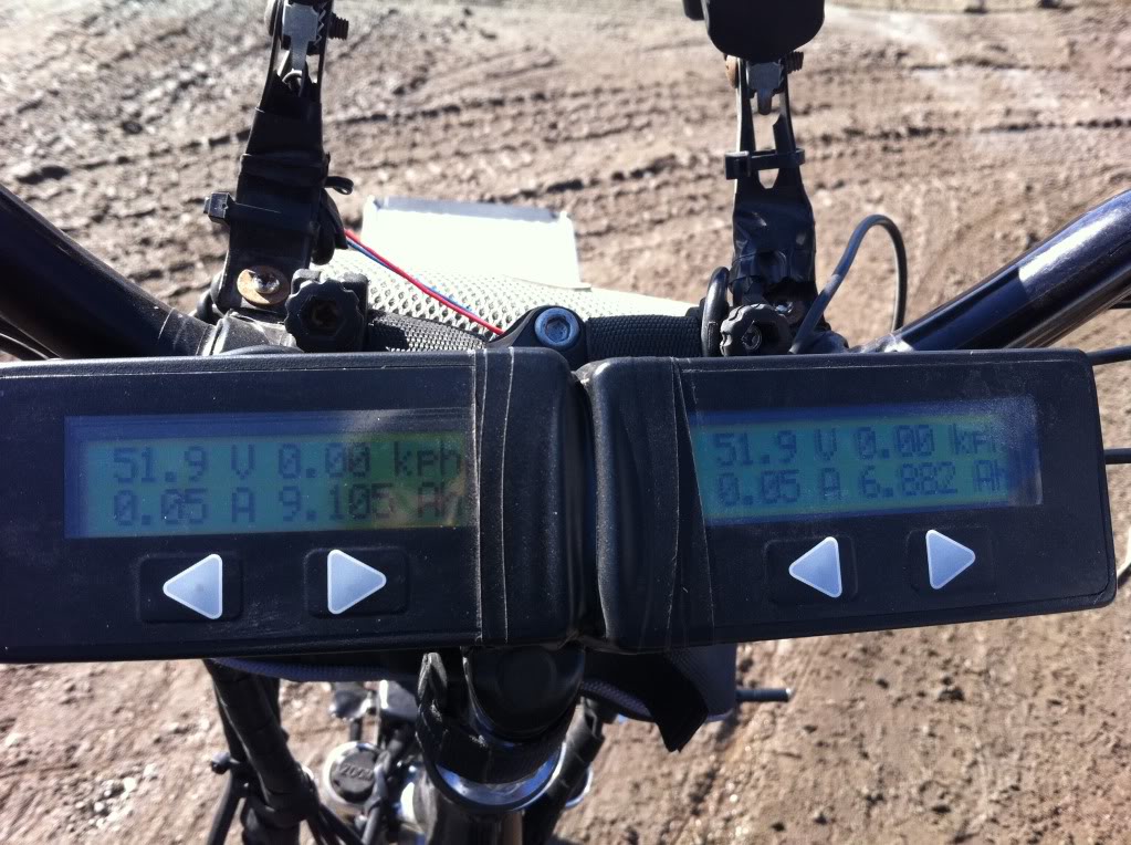

I now have had the damaged battery in my possesion for a week and have looked it over. I see no evidence that it was damaged in any way other then the external case damage. I know some will say there could be still be damage inside the shrinkwrap, but seeing no obvious damage I decide not to cut open the shrink wrap. Looking over the case and how the sits in it. My opinion is the top of the battery where the bms sits did not take a hit. I chaged the battery and all went well. It was at 52.7 volts when I received it and it charged to just over 56 volts. My next post will be about a recent test drive.Anyway here are some pictures.
Re: buying pie what controller battery
« Reply #26 on: March 07, 2011, 04:04:02 AM »

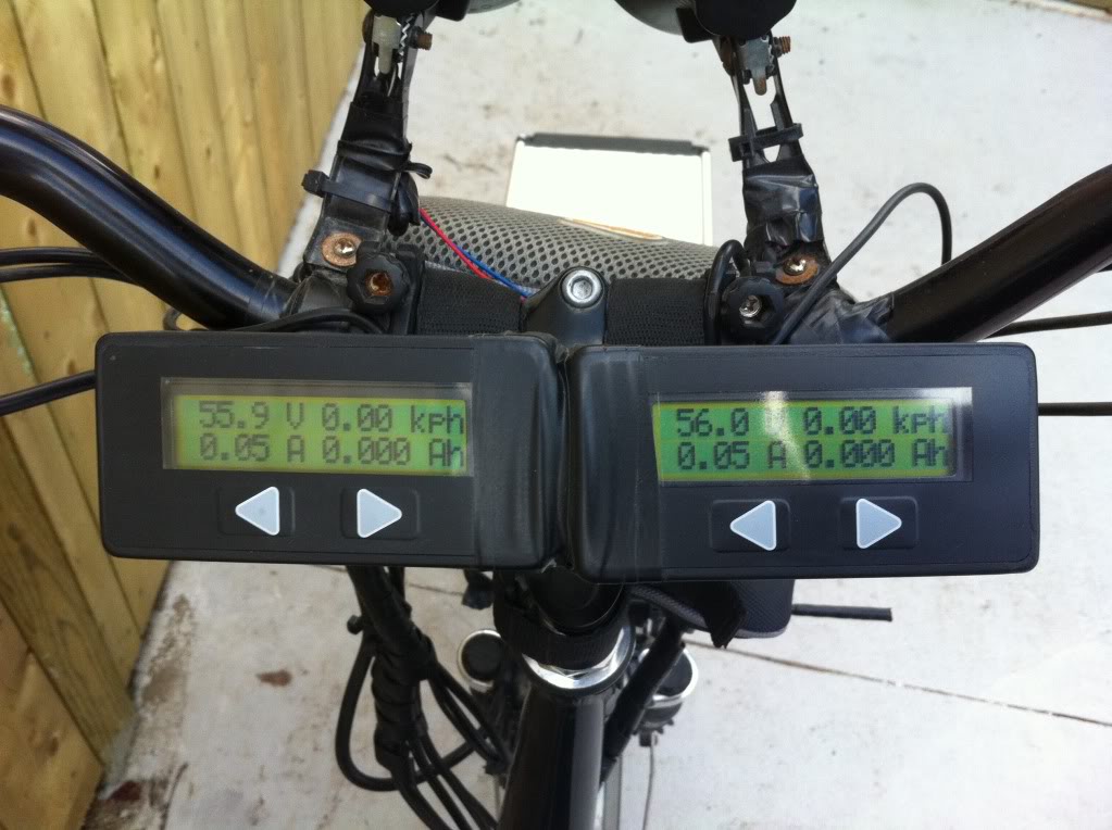

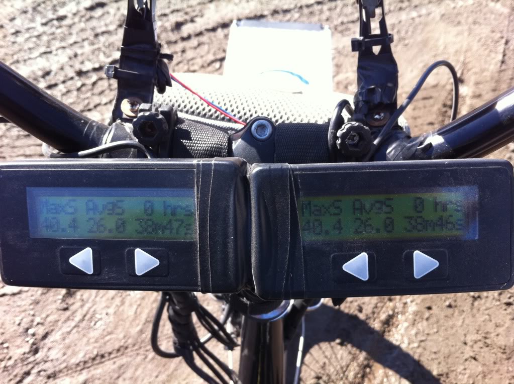

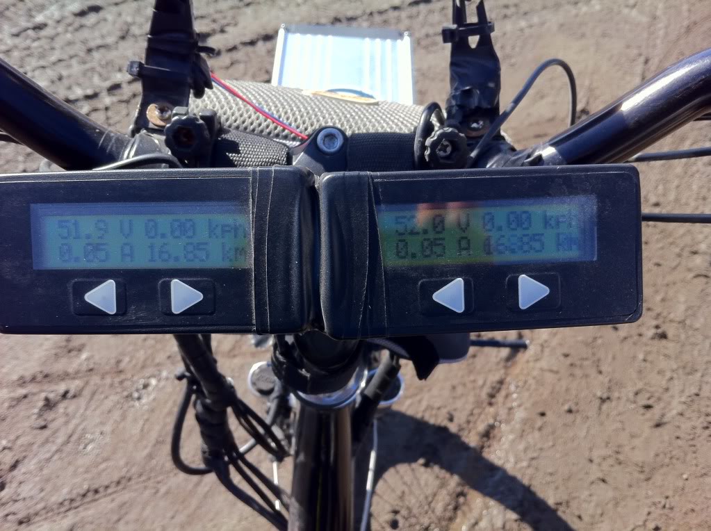

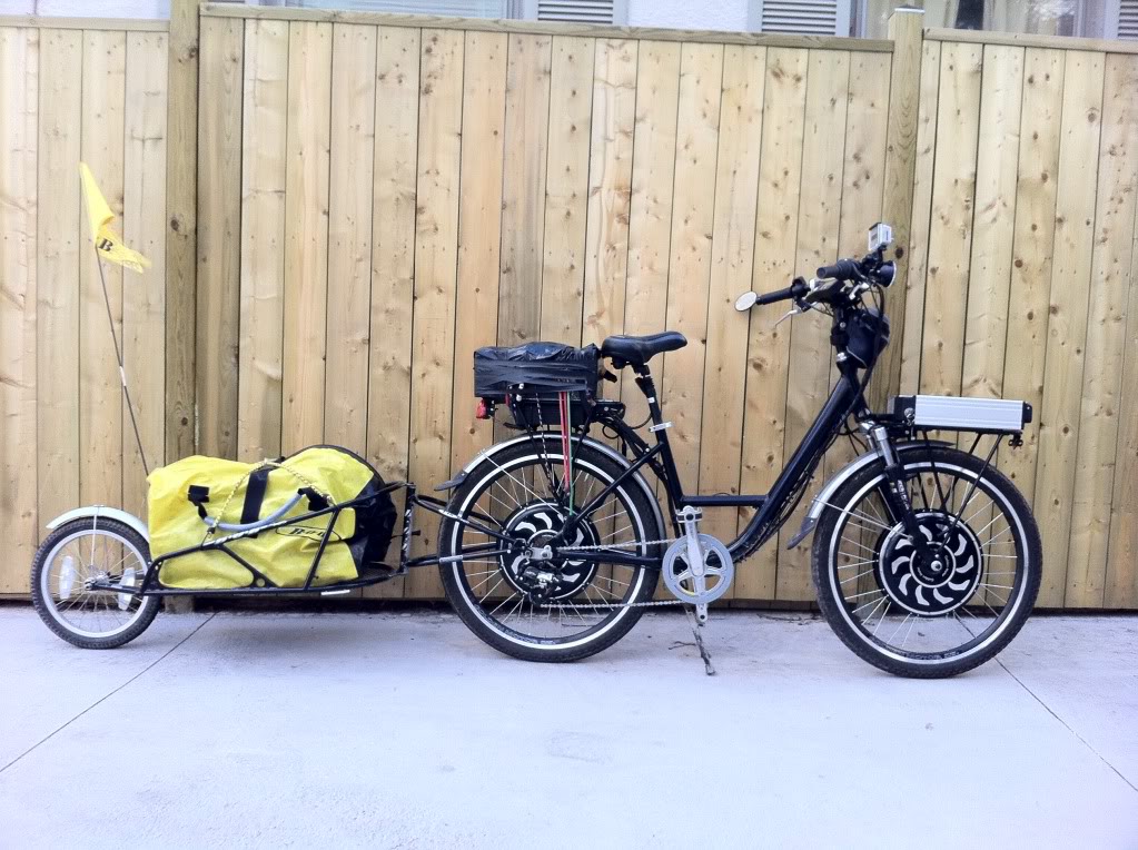

I removed my rear 48v12ah battery from my bike and mounted the 48v20ah battery. I used about 12 bungie cords and wrapped it in a garbage bag to make it not so obvious. I loaded up my gear in my trailer and headed out on the road for my 10 mile (16k) ride to work.
What a day to do a road test! My ride is a long gradual uphill climb. The day I did this ride I actually had a headwind worse then any other ride. It was in the steady 40 to 50 kph with gusts over 70kph. My rolling weight with all my gear is over 200kg. With these obstacles I burned over 15 amps of power one way. This is not unusual as I normally burn most of my amps on the uphill ride to work and less downhill going home. But the battery pulled strong. My speed due to the wind was all over the place. Here are the pictures of the Cycle Analyst upon arriving at work.
After work I headed home and the battery started kicking out. I assumed it was the BMS saying thats it. I used anderson plugs to make the connection and I could unplug it and replug and it would go again. After doing it a few times and nursing the battery I made it most of the way home. I then unplugged it and plugged in my 48v12ah on the front for the rest of the trip. I was satisfied with the results and would look at the CA stats later. The next day when I returned to the battery I found I had cracked the Anderson plug and the connection was faulty. It was most likely why I had problems on the way home as the connection was very bad and any bumps or movement could make it kick out. So only the stats on the uphill ride to work will stand. The Stats from the return trip are unreliable and have been discarded.
I am not normally one that “tows  the company line”. Anyone that has been in the forum for some time knows I have butted heads with GM a few times on issues I don’t agree with. But In this case I do  believe this battery is fine. It will be recased and sent back to rollin76. I have given him every opportunity to cancel this order , offered him a full refund including any fees paid and even advised him on how to do a PayPal dispute if he feels it is necessary. He has chosen to still take this battery and it will still have full warranty and my assurance it will stand.
« Last Edit: March 07, 2011, 04:07:47 AM by GM Canada »

Not that MM's words mean anything, but looking at those pics, personally I would be grateful of receiving a newly cased unit - and a bonus it was tested by a dealer.
I'll add a few more words (as MM usually does with a tasty beverage)
> After much dealing with customs and imports over the recent years, looking at this one you can't really blame GM 100% for the broken package.
Let's say it was packaged in a wooden carton, any dunnage such as this will require Quanantine, at the cost of the importer. So the range of cost would be from around $60USD to $130...
Air cells would burst, and due to the weight of the unit, the corners could break any plastic lining along with foam.
Recently GM orders are extremely well packed, but something to improve on here would be this battery surrounded in polyfoam, then double boxed in cardboard, then put in a bigger box with either shredded rubber or multiple layers of corrugated cardboard.. Reading that back seems like a bit of work but the cost would be $1 or 2 if that...

« Reply #29 on: March 07, 2011, 02:05:04 PM »
So far I have only done the one test drive. I was going to do it again today but is -8c and a high of -2c. Still a little cold considering the sides of the road are once again covered in snow. The forcast tommorow is above zero so maybe then. Also I am trying to do some further testing of my dual mini. So each trip I will have to decide, this bike or that one....
