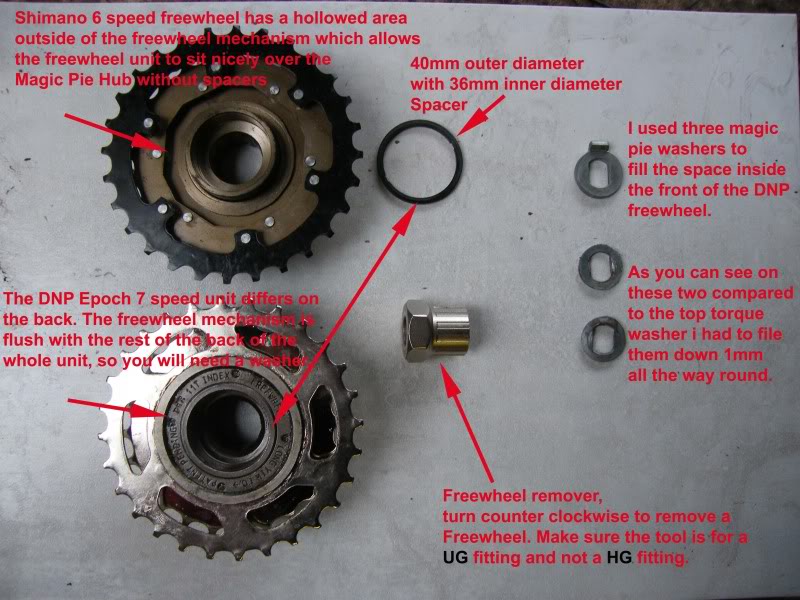

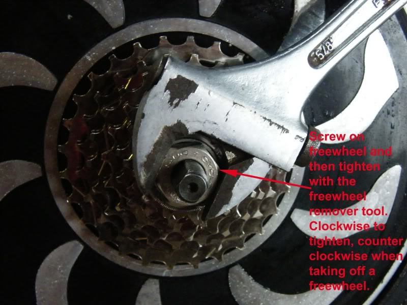

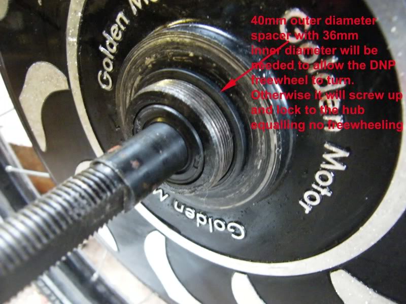

most people probably run a Shimano 6 speed freewheel on their PIE. If like me you want to pedal at top speed then you may be wishing you had that extra small 11 tooth cog on the freewheel.
I've successfully done it and this is with my Hydraulic disc brake set-up too and my 26" X 2.35 fat road tyres. All this on a standard 135mm rear mountain bike axle ;D
Remember, that once done you will need to adjust your rear derailer and probably have to change to a 7 speed gear shifter.
I hope this helps if you decide that you need that extra gear for pedalling when at full speed.

isn't there an cog with 11 tooth that is 6 speed?
Re: 7 Speed Freewheel with 11 tooth cog for Magic Pie. (A How To guide) :-))
« Reply #2 on: December 31, 2010, 09:49:48 PM »
Not that I've seen, I think even 12t is rare on a 6spd.

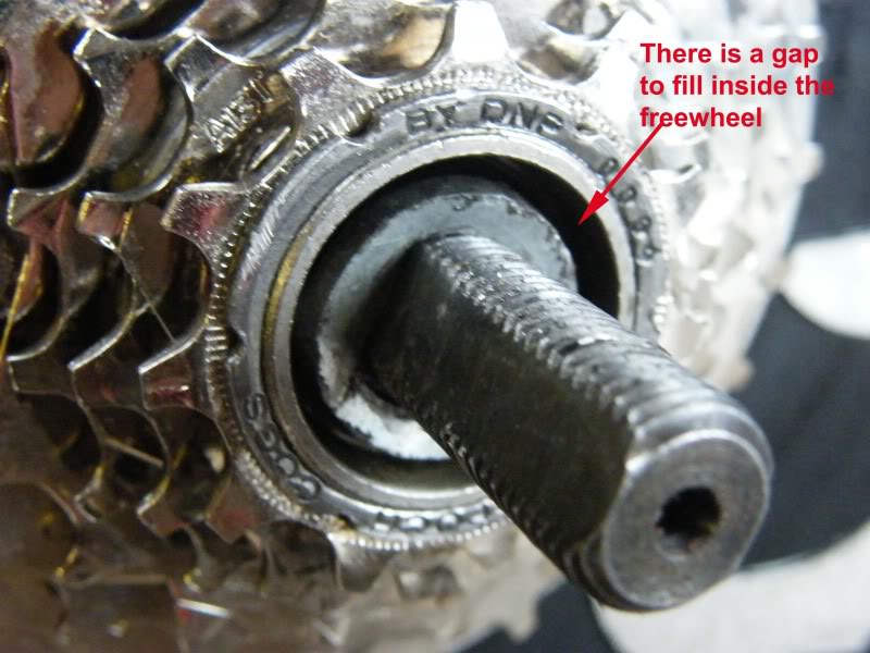

Hey Awesome work Andrew!! Great stuff you took some pics and posted it up, I was thinking with the washers - was cool but have you got some holding your axle in the dropouts now? I'm sure it's tight, but you don't want all that hard work you've done to 'spin' on you!
Due to the way the freewheel mechanism works, getting one with a smaller cog than 14 or 13 is rare. the 11 cog freewheel as far as I know only exists with the DNP Epoch as pictured above. I got it fron a US company and they inject it with grease using a special tool so it is silent and does not click loudly like the shimano freewheel.
and of course, please do not confuse a threaded freewheel with the modern splined cassettes which you usually find on modern bikes

Monkey, Yes don't worry, I have torque washers in place , infact I have custom made ones which have blocks on them which wedge into the dropout space and are jammed in

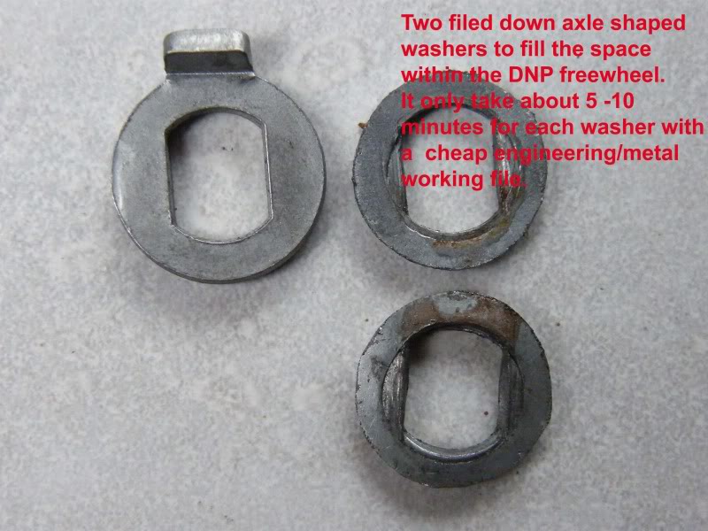

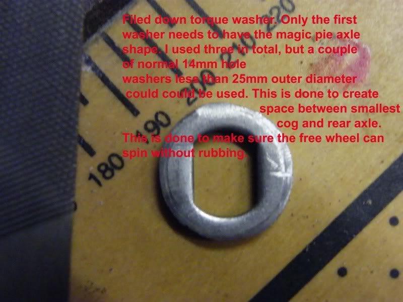

Also, I have found it impossible to find 14mm ID washers with a less than 25mm OD.  Trying to find a washer the same diameter and shape as the PIE axle is non existant as far as I know in the UK
I've just discoveed that many car 'oil sump washers' have a 14mm inner diameter and less than 25mm outer. :)
So if you can spare one torque washer to go inside the DNP freewheel and line up with the axle shape, then a few sump plug washers could be used to fill out the rest of the internal space
Thank You for that! I have looked around and the best thing I found were lock washers. These are surprizingly stong. But a true washer would certainly be stronger.

No worries, it's something to do during these dark nights.   The best washers i've found are aluminium sump plug washers that are 14mm ID and 20mm OD........ http://cgi.ebay.co.uk/ws/eBayISAPI.dll?ViewItem&item=270661455664&ssPageName=STRK:MEWNX:IT
Probably  best to avoid copper sump plug washers as they are more crushable and will oxidize
