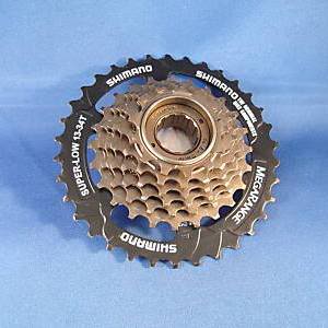

Milhouse, the link you have posted is for a splined cassette, which is not suitable for a Magic Pie. GM recommend a 6 speed thread-on gear cluster known as a "freewheel" which simply screws on to the Magic Pie's threaded boss.
The special tool is only needed to remove the freewheel (when it fails and needs to be replaced).
I couldn't find anything suitable on bikeshop.no, but I found this Shimano MFTZ06 6 speed screw-on freewheel on woollyhatshop.com which should fit the Magic Pie.
The 7 speed freewheel can be fitted if you use an extra spacer washer on the axle, but the 34 tooth 1st gear can be a bit too large for some dérailleurs to cope with. ;)
The following picture shows a 7 speed freewheel unit being screwed onto the hub:

Peter, the Shimano MF-HG37 7 Speed freewheel that you have found only has a 28 tooth 1st gear, so there should not be a problem with the dérailleur, but it still may need an additional washer on the axle to space it further from the frame:
Most removal tools usually have a 10mm diameter hole through the middle to fit over a standard axle:
The Magic Pie requires the hole to be at least 14mm to fit over the larger axle:
Gary (GM Canada) sells these if you can't find one locally.

I only discovered this when I went to use it, I ended up enlarging the hole in the centre of my standard removal tool with a grinder so I could unscrew the freewheel when I transferred my Pie to another bike that couldn't cope with a 34 tooth 1st gear.
