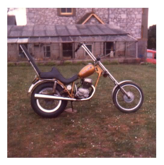

My Fantic Chopper moped originally had 16" tyres front and back, but the the outer diameters were very different:
16 x 5.00 tyre on the rear and 16 x 3.00 on the front.
The same 16 x 5.00 tyre on the rear, but now with an 18 x 2.50 on the front.
