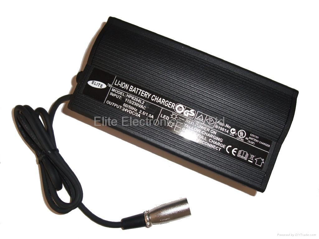

I have a HP8204L3
Kinda like this:
It shows a Green LED when fully charged, and mine is showing just that :)

If is the same as mine:
So this chrager dows not give any voltage when it is disconnected of the battery, when it detects the battery it starts to work.
Im having problems with my battery, so when the BMS kicks off the battery the charger does not detect the battery! So I need to manually move the wheel pedaling with my hands than use the regenerative braking, this activates the controller and then you turn on the bms. And also my pie does not have even 5km of range anymore.
I'm sure mine is a battery problem, but yours could be the charger or be like mine but worst. (at least I can go to the bakery)

He should have the same charger I have.
Two leds
One red that does not change color, it is only a power on led.
Second led is orange, or yellow, when charging, green when charged and off when the battery is not connected or the charger does not detects the battery (my case)
