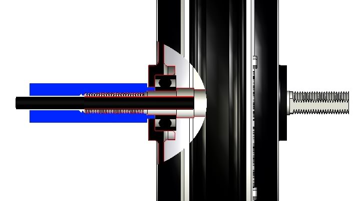

In my opinion, the strongest way to mount the hub (using just one end of the axle) would be to machine a threaded boss which the axle could thread into. This boss would be stepped to go right inside the hub casing and seat against the inner race of the bearing, giving the best resistance to any bending forces acting upon the axle.
For this type of mounting to work, a clockwise rotation would be essential, otherwise the unit could end up unscrewing itself under heavy load.
Simply bolting the end of the axle through a bracket would put a lot more strain on the axle itself, which is already weakened by being hollow, threaded and having flats machined into it.
From a designer's point of view, the direction of rotation would definitely be an important consideration.
Offline Sr.WiNdTeCh
  • Posts: 10
Re: 48v 1000watt Wind Turbine
« Reply #8 on: February 10, 2010, 10:34:01 PM »
I will more than likely tack weld the nut to the stud... Once I get the brackets all made I will put in a removable bracket so I can still remove the motor if need be.
Re: 48v 1000watt Wind Turbine Mounting
« Reply #9 on: February 10, 2010, 11:50:15 PM »
Welding a nut will cause localised stress on the axle which could create a weak point.
It would also make it very difficult if you needed to replace the axle bearing on the mounting side.
If you want a strong mounting that is unlikely to fail, it would make sense to fabricate a threaded adapter like this:
This adapter could be made strong enough to safely allow it to be welded or securely clamped to the main assembly as required, and I would expect this to be more than twice as strong as a tack welded nut type of mounting.
It could also be drilled and tapped to receive a grub screw, which would lock the axle to ensure it could not work loose.
I know which mounting method I would use if I were building it!

what program did you make that with?
Yeah I like that Idea a lot more, problems is getting it made.....
« Reply #11 on: February 12, 2010, 12:39:57 AM »
It's just a screen capture from the solidworks drawing which I modified using a freeware program called Paint.NET.
If you know someone with a lathe, it shouldn't be too difficult to turn one up.
If the lathe is unable to machine the thread, you would need a suitable tap:
(M14 x 1.5)
It would be good to see some pictures of your progress if possible.

Is that the exact thread size M14 x 1.5? Yeah I don't see why I couldn't do that, I have a buddy with a lathe, he is the same guy making my blade brackets. I will definitely keep you posted through the build, I have came up with the whole turbine design so far, I'll try and get it on the computer and put on here for you to see if I'm missing something. I should have time this weekend to get it on the computer from my chicken scratches.
« Reply #13 on: February 12, 2010, 10:48:51 PM »
That's the size it states on the drawing.
