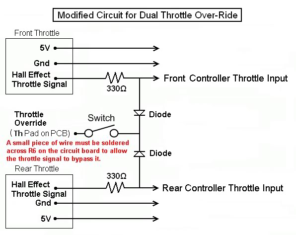

Does anyone know if you can use one Cycle Analyst for 2 motors, or do you have to buy 2 of them?
Currently I'm using 2 of the Turnigy Watt Meters, and would LIKE to use Cycle Analyst for the speed / amp limiting function, but 2 of them would be $300 as opposed to the $50 I spent on the two Tunigy's

  • Posts: 5,644
Re: Using one Cycle Analyst for two motors
« Reply #4 on: January 28, 2010, 11:43:16 AM »
Does anyone know if you can use one Cycle Analyst for 2 motors, for the speed / amp limiting function?
Frank,
If you are using a single battery and single throttle device, it can simply be wired as per the instructions to control the speed/current limit of both motors.
If you have two batteries (independently wired to each motor) the wiring will need to be slightly different, and it will only be able to monitor the current drawn by one of the two motors.
If the motors are identical, I would suggest fitting the shunt on the Rear one.
If the motors are different types, I would suggest fitting the shunt on the most powerful one.
If you are using separate throttle devices, each will require its own diode and resistor to be wired in as per the standard instuctions, before they are joined together.
I would recommend they are joined externally to a single wire, which will then go to the "Th" connection inside the Cycle Analyst.
I can post a modified a wiring diagram if you need it.
I have not ordered mine yet but I will be using dual throttle
what would this re wireing consist off ?
« Last Edit: April 24, 2010, 07:24:11 AM by MasterCATZ »
  • Posts: 5,644
« Reply #12 on: April 25, 2010, 12:55:31 AM »
I have not ordered mine yet but I will be using dual throttle, what would this re-wiring consist of?
This should be all that is required for the GM Cruise (and/or Magic Pie) Controllers:
After some experimentation, the recommended 3-5K resistor needed to be replaced by a 330 Ohm resistor for correct operation with the GM Cruise and Magic Pie controllers.
This also required the shorting of resistor R6 on the Cycle Analyst's circuit board, which can be done by putting a jumper on J6 soldering a small piece of wire across R6.
The switch is optional, but would provide a quick way to turn on a pre-set speed or current limiting function on the Cycle Analyst.
« Last Edit: June 30, 2017, 07:10:54 PM by Bikemad »

I think I may be starting to actually loose my mind. I took the casing off my CA. I can't find J6 on my 2.2 motherboard. R6 is clearly marked. Do I just solder a jumper on that? Can someone point it out to me? Thanks.
