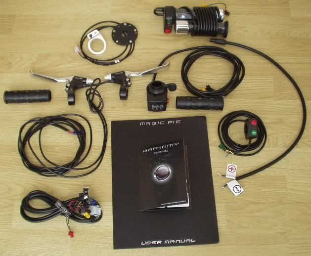

1. There was  NO  BATTERY POWER CONNECTOR in the delivery of Magic Pie (bought in Nov 2009)  !!!
There is only the wire coming out of the wheel with the two connections (+/-).
Wolfgang,
I'm assuming a battery power lead should have come with the kit as standard like mine did:
The battery lead is shown on the right in the above picture, and is clearly labelled to avoid any confusion with the connections, and should be self explanatory.
Unfortunately it looks like they must have forgotten to put the lead in with your kit, unless you bought just the motor.
« Last Edit: June 30, 2017, 06:08:02 PM by Bikemad »
