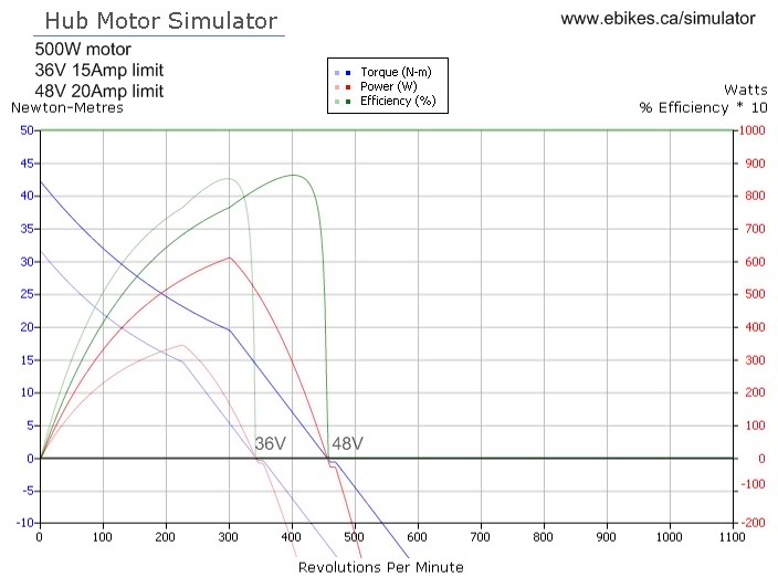

Could you tell me, Alan, what max speed it could go with 500W (rpm)and 750W, I can not read the motor performance curve
Maximum motor speed 36V  500W = 340rpm (19km/h with 300mm tyre)
Maximum motor speed 36V  750W = Unsure (I don't have any figures for this motor)
Maximum motor speed 48V 1000W = 470rpm (26km/h with 300mm tyre)
The golf trike motor    48V  750W = 390rpm (22km/h with 300mm tyre)
  • Posts: 5,644
Re: Greg's Trike project
« Reply #10 on: October 06, 2009, 11:57:49 PM »
the 750W too only 18 Nm
golden motor say 18 NM at 266 rpm (508 w) but if I go less than 266 rpm (14km/h), the torque isn't more powerfull ?
because 0 to 5 km/h (0 to 98 rpm) with 18 Nm do it in 7,72 s !! it's too !
any idea ? ???
i don't want to buy two battery, two controllers, two motors.

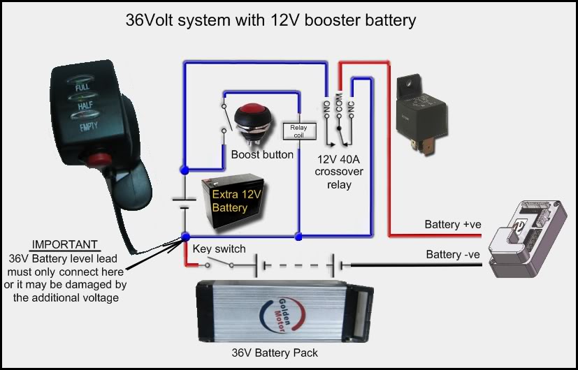

Greg,
I don't know if the 36V regen controller can cope with the higher voltage, but a 48V boost would certainly help to increase the available torque, if only for short bursts when it was really needed:
