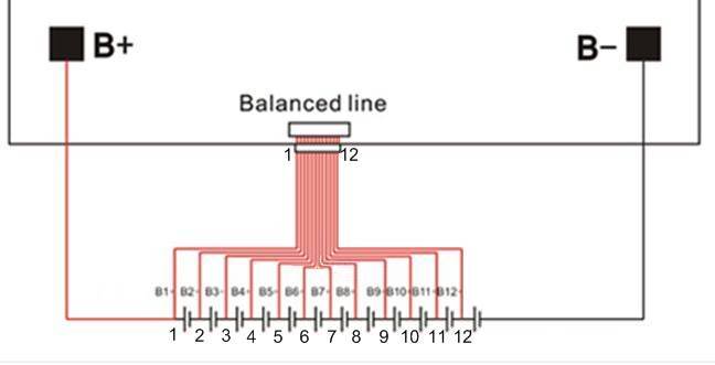

What I want to know is for example, wire nº 5 coming out of the battery in wich connettion must go...??
Looking at your pictures it appears that:
1 goes to 1
2 goes to 2 etc.
like this:
Hopefully this modified diagram will make it a bit more obvious.

 you have to know the order your cells are connected in order to know which way to connect those wires. You may have to strip down your battery to expose all the wires so that you can reconnect them correctly. Below are two diagrams taken from different types of bms's that may help you determine how to do it. Assuming the connector for all the little wires has them in sequential order then you should be able to take it from there.
Muzza.
Hello Muzza
Your drawing is very good.BMS1 is suitable for 36V LiFePo4?BMS2 is suitable for 72V LiFePOo4?
Robert uses LiFePO4 and red BMS is another kind of Lithium Battery.
Actually I didn't draw them, I just copy and pasted them. I guess the voltage would depend on the number of cells in each diagram.
Muzza.
Re: Battery charging
« Reply #19 on: September 17, 2009, 11:12:07 AM »
BMS1 16 cells 48 to 64V  (12 LiFePO4 cells@3.0V=36V)
BMS2 24 cells 72 to 96V  (24 LiFePO4 cells@3.0V=72V)

Robert's battery appears to be a 12S 3P pack (12 sets of 3 cells in parallel).

Tom told me to conect cell 1 to position nº1 in the BMS conector, and so I did, but nothing happens, so I decided to measure voltage, and I found 36.1volt from the wires out of the battery, and 36.1 volt from the wires of the BMS, but when I measure after the shunt of the cycle analyst I only had 5.1volt.  I wrote to Ebike, and very quickly they answer me they have never have a shunt burnt, and to try continuity.  They were right, the shunt was ok.  So it must be the BMS, so I disconected, and plug the battery without BMS directly to the cycle analyst shunt, AND IT WORKKKKKKKKK:) :)
