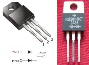

Is it possible to retrofit the Magic controllers I acquired before this protection was built in? In other words is there a retrofit kit or is there a diode I can purchase locally or from Golden and install?
The diode modification was applied to the battery pack, not the controller, and was only required with the non-modified controllers.
The modified controllers (from 22/7/2009 onwards) no longer need a diode fitted across the battery switch.
Quote from: Yao Yuan (GM Representative)
We have recently enhanced the cruise controller to detect if the battery pack is in place. If the battery is switched off, or is not connected at all, the controller will check the back EMF voltage, if it exceeds the preset limit, the controller will disable the regenerative braking to protect controller from being damaged.
As of today, 22/7/2009, the day of the eclipse, all GoldenMotor controllers have a new function to deal with the issue of regen braking burning out the controller while battery is off.
If you want to fit the diode, because you have the earlier type of controller, then connect it directly across the switch connection to enable any regenerative braking current to still reach the battery even though the switch is turned off.
Check out your local electronic component supplier for a 100Volt 20Amp diode. I found this one
If your switch is on the +ve lead from the battery, both outer legs go to the controller side of the switch and the centre leg goes to the battery side of the switch.
If your switch is on the -ve lead from the battery you must fit the diode in the opposite direction.
If the diode is fitted the wrong way around, power from the battery will be supplied through the diode with the switch turned off.
Simply reverse the diode if this happens.
Hope this helps.
