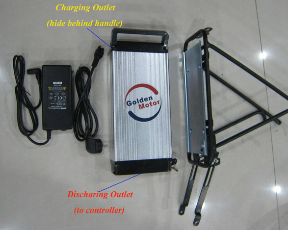

To charge the battery while using it, could I plug in a 50.8V power source into the charging outlet on the battery while the battery is simultaneously connected to the controller? 50.8V comes from the GoldenMotor website. After clicking the EV battery button on the left hand side and scrolling down to the solar charger section of the page it shows that the 36V solar battery chargers output 50.8 charging volts.
« Last Edit: July 20, 2009, 11:24:50 PM by Dolfino »

You have to be very specific when you use the terms "outlet" etc. You mention plugging a power source into a charging outlet on the battery. I am not clear what you mean but I will assume that you mean plugging the power source into the charging input socket on the battery.
If you are using a battery that has a BMS built into it then you can do what you suggest. The voltage will never be higher than about 42.0 volts because the BMS will open circuit from the charging socket to the battery cells when that voltage is reached.
Whenever the charger is connected to the battery 50.8 volts will not be measure at the battery or charger since the battery is a load on the charger and will keep the voltage down to under 42.0 volts. But when the BMS opens the circuit between the battery and the charger the charger's output wire will show a voltage of 50.8 volts and the battery will show a voltage of 42 volts. They are no longer completely connected once the BMS has opened the charging circuit.
It is OK that the bike is ON because the BMS will keep the voltage of the battery to no more than 42 volts which is the safe upper limit of the battery.
Sorry if I confused you. I was going to say charging inlet but this picture confused me and made me change my mind.
Anyways, from what I understand, it is perfectly OK to input any voltage over 42V into the charging inlet, regardless of whether or not the battery is on, and also regardless of whether or not the battery is being used. It would be much easier to input 48V than 50.8 into the charging inlet on the battery because I could easily get a 48V DC-DC converter. I think I understand it now, but I just want to clarify. Thanks so much for your help.
« Last Edit: July 21, 2009, 01:29:30 PM by Dolfino »
What happens is this... to charge any battery you have to put in a somewhat higher voltage than the voltage you are trying to charge the battery to. The higher that input voltage is, the quicker the battery will charge. If the input voltage (charger voltage) is too high then the voltage measured at the battery while charging will also be too high. You do not want to charge your 36v LiFePO4 battery higher than 4.3 volts per cell. (I think 4.3 is the max, not absolutely certain.) So you can charge with as high of a voltage as you want as long as the cells never go above 4.3v each. The BMS in the battery is supposed to ensure that over voltage charging does not happen.
If you are applying your charging voltage at the output wires of your battery the BMS input charging circuitry will be bypassed and it will be possible to overcharge the battery and ruin the cells. I just mention this in case you intend to charge thru the output connector of your battery instead of the normal charging jack.
