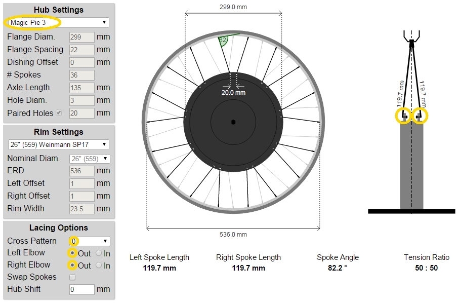

Check out this post to find out how to properly measure the ERD of the new rim and how to calculate the length of the new spokes that will be required.

I have updated the previously linked post to avoid any confusion. It now says select the "Magic Pie 3" which you would use for all MPII, MPIII, MP4 and MP5 hubs.
If the flange spacing measurement does not match your particular hub, you simply enter the measured figure for greater accuracy, but I would expect the default 22mm width to be close enough for most applications.
I physically increased the flange width on my original Magic Pie by ~6mm and the original length spokes still fitted fine, and I have not experienced any failure of the original spokes or nipples since the wheel was rebuilt, and that was over 10 years ago.  ;)
Magic Pie II, III, 4 and 5 hubs with laced rims all use the same paired hole measurements.
Using the ebike.ca spoke calculator, select the "Magic Pie 3" hub making sure the "Cross Pattern" is set to "0"  and I suggest you also fit the spokes with the elbows on the outside of the flanges for better lateral strength as shown here:

Bikemad, that spoke calculator is wrong for some reason. The original spokes for the wheel are 110mm. This has been measured by the bike shop a few months back, and confirmed with tech support for Golden Motor. It seems Magic pie 3 Hub is smaller than the Magic Pie 5. Also, if you lace the wheel with the elbows facing OUT, how much more would they stick out towards the frame, or would this even matter ? I'm more worried about the clearance on the bottom area of the frame, where you have a kickstand, disc brake, torque arm etc.

The rim shown in the calculations below is not a GM rim:
It has a much larger ERD and therefore needs longer spokes.
The spoke calculator is not wrong, but it can only give the correct spoke length if you enter the correct ERD value:
For the above calculations I simply entered a guestimated ERD measurement for the 26" Deep "V" GM rim, as I don't have a bare rim to measure accurately, but the value I used is probably within a couple of millimetres of the rims actual ERD.  ;)

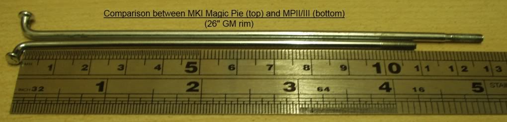

The Magic Pie III (Magic Pie 3) is definitely not smaller than a Magic Pie 5.
If you take a look at the picture below you can see that the MPII and MPIII use exactly the same length 110mm spokes for the GM 26" rim as the MP4 and MP5:
