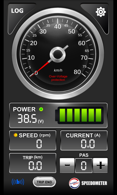

If your controller voltage is still set at 36V, the fully charged voltage of the 48V battery will exceed the Overvoltage protection value for the controller and prevent the motor from running.
If you have the Bluetooth display on your phone, you should see "Over Voltage protection" displayed just below the km/h label on the speedometer:
