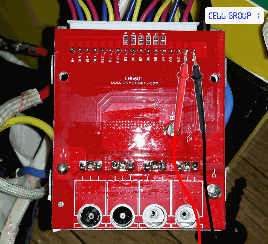

Newbie question if you don't mind. I have the same battery and am guessing one or more of my cells have degraded because the power will suddenly drop out after about 15 miles (I usually get far more  and a gradual drop shown on the LEDs). Would someone kindly illustrate on one of these photos where to place the +/- probes of a multi-meter - or describe it of it's easy enough to understand.
Thank you.
Re: Inside of my GM 48V 10Ah pack
« Reply #9 on: July 06, 2016, 07:17:09 PM »
If you have access to the BMS, you can check the voltage of the individual cells (or cell groups on earlier LiMn batteries) by measuring the voltages on the balance lead connections as shown here:
Unfortunately, a weak cell may only show a low voltage relative to the others when it is actually under load. :(
To check the battery under load you will need to attach a suitable resistive load across the output terminals.
A 240V kettle or electric iron will draw less than 2.5 Amps @ 48V, and this might not be enough to show the weak cell.
Four 60W car headlamp bulbs connected in series should draw around 5 or 6 Amps but will get very hot!
Heating elements from an old cooker hob might be another option as you can switch them all on together to put more load on the battery.
An old electric bar type heater should work well, but a fan heater with an electric fan might get a bit too warm as the fan may not run on a DC battery.
If you wire the plug lead from a four way extension socket direct to you battery output connector you could plug in a combination of the above mains powered items (kettle, iron and bar heater etc.) but if they are 110V  instead of 240V be careful not to exceed the current rating of the mains cable or it could get hot enough to melt internally.  :o

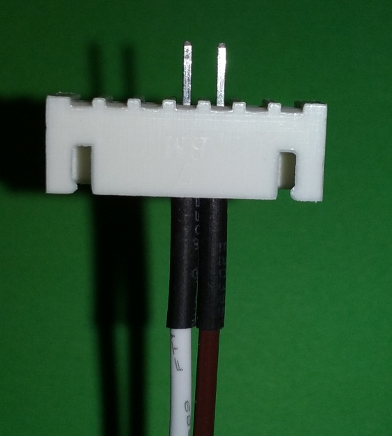

Should the multi-meter be reading somewhere around 3.4v for a healthy fully charged cell when testing each of those groups?
« Reply #11 on: July 07, 2016, 10:20:30 AM »
A fully charged LiFePO4 rectangular cell should read 3.6~3.65V per cell, a fully charged LiMn cylindrical cell (or LiPo) should read 4.1~4.2V per cell.
Be very careful not to touch the meter probes together (or bridge two adjacent contacts with a single probe) while touching the pairs of contacts, as you will get some nice big sparks and also risk melting the two connected balance wires.  :o
You can use a couple of short pieces of cable insulation or heat shrink tube (or make one from insulation tape) slid onto the end of each of the probes to stop the tip of the probe from slipping off the soldered pins.
The balance wire connector must be plugged into the BMS if the voltage checks are performed on the BMS contacts.
Alternatively, you can unplug the balance lead from the BMS and measure the voltages directly on the balance lead connector instead of the BMS.
I use a modified LiPo balance lead connector (pictured above) which plugs directly into adjacent pairs of contacts on the battery's balance lead connector to avoid fiddling around with meter probes.
It makes it a lot easier to read the meter and record the voltages without having to keep an eye on the meter probes at the same time, or lose track of which cell you were checking previously. ;)
