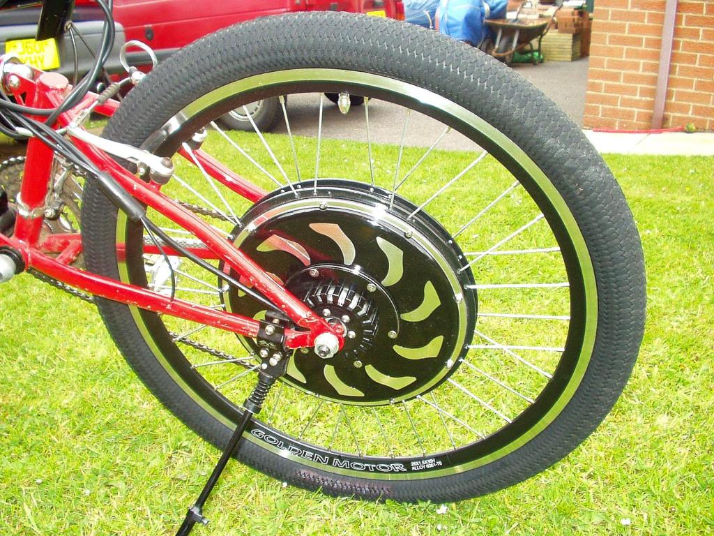

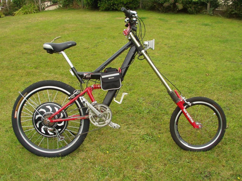

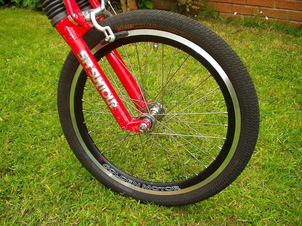

I rebuilt the front wheel of my wheelie machine using a GM 20" rim as I wanted the front and rear wheels to match.
Even though the rims are less than an inch wide, it easily accommodated a 26" x 2.30" tyre on the rear:
And a 20" x 1.95" tyre on the front:
