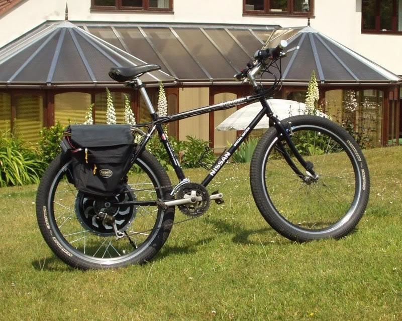

My modified 26" Magic Pie drew 97.75 Amps on a 51.8V 5Ah LiPo pack would simply flip the bike over backwards from a standstill:
