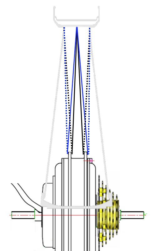

The rear Smart Pie should fit the 130mm dropouts but lacing the wheel using the existing holes in the rim is probably not the best way to do it.
The spoke holes on most rims are fitted along the centreline of the rim to give a greater angled spoke between the hub flanges and the rim to provide better lateral strength for the wheel:
The wide rims on the Dolomite have staggered spokes and a much wider distance between the flanges on the hub to produce a similar spoke angle to conventional rims.
If the rim was laced using the existing holes, the spokes would be exiting the rim in the wrong direction (dotted blue and black lines) and the nipples would jam and cause the spokes to bend. The spokes could well end up being more parallel than angled, which would provide very poor lateral support to the rim.

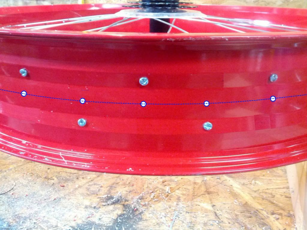

It would be better to spoke it like a conventional rim (as indicated by the the solid blue lines in the previous diagram) but new spoke holes would need to be drilled in the rim around the centreline as shown here:
The spoke length could then be determined by accurately measuring the difference between the internal diameter of the two rims (Standard 26" GM deep "V" rim and your 26" wide rim).

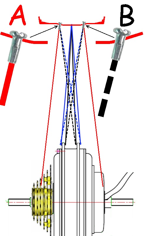

Hey, Alan, what do you think about cross lacing the rim?
Cross lacing is often used on spoked car wheels where the wheels are subjected to very high lateral forces on corners:
The severe angle between the spoke and the rim means that the holes in the rims have to be specially formed to allow the nipple to seat evenly with the spoke exiting the rim at the correct angle.
If you look carefully at the following picture, you should be able to see that the rim is actually angled on the portion where the original spoke holes are located:
This allows the nipple to seat correctly against the rim as shown in position "A" below.
If you tried to cross the spokes with this rim you would end up with the nipple being unable to seat itself against the rim properly, as shown in position "B" in the following diagram:
By the way, the fat tire bike I saw had really tiny diameter spokes that didn't look like they would last very long.
There is no logical reason why they should need to be any thicker than a conventional bike's spoke, as the forces being applied to the spokes should be the same. Having said that, the much larger volume of air within the fat tyres themselves will absorb a lot more of the impact forces on bumps etc. therefore the same thickness spokes should actually last much longer. ;)

Here is my front rim drilled that I handed off to the wheel builder today, I will post more as I work it out.
I used masking tape and a 90deg straight edge and marked the holes then went back and drilled with a hand drill.
