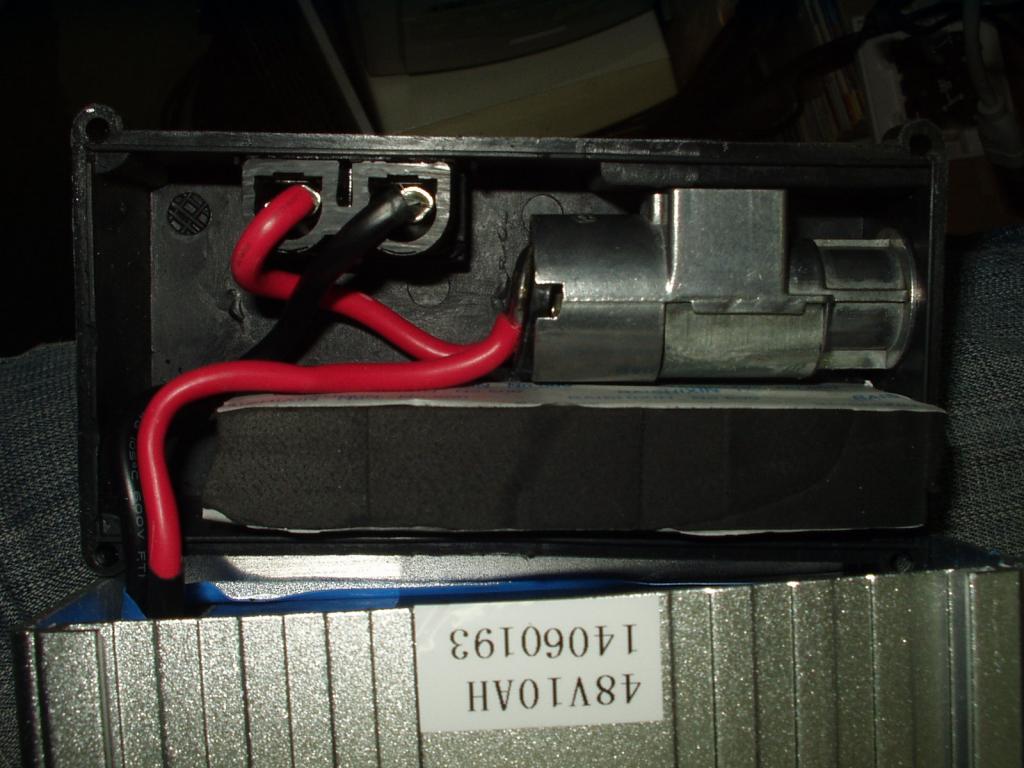

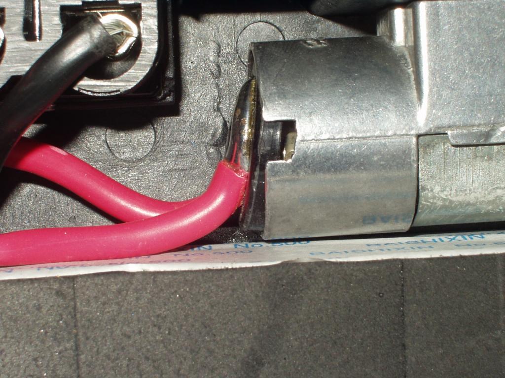

Another possible cause is loose or dirty contacts on the back of the keyswitch inside the battery. If these are not making a good connection it will allow the voltage to flow across the contacts without any load, but the voltage can immediately drop when any load is applied (i.e. plugging in your battery connector).
I had a similar problem which turned out to be the contact plate coming loose on the rear of the keyswitch:
The cables soldered onto the end cover were pulling the fixed contact plate away from the moving contacts.
I pressed the end cover back in fully and then bent the wires more tightly at the switch end to make sure the wires were no longer trying to lever it off again and I have not experienced any further problems with the switch since this was done.
If you think the battery may have water inside you will need to keep it in a warm dry place until it dries out, or carefully remove the end cover and gently dry the BMS board with a hair dryer (making sure you do not allow it to get too hot).
I suggest you contact your supplier to obtain their permission to remove the end covers from the battery and ask them to confirm that it will not invalidate the warranty. ;)
