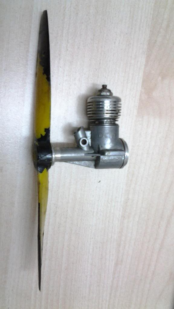

Reading that sentence just reminded me of an old control line model aircraft that I had back in the 70s, a KeilKraft Champ:
.... and I still have what's left of the DC Bantam glow motor that used to power it:
This poor old motor no longer works, as it's missing the needle valve assembly, spring quickstart mechanism, the fuel tank, and a considerable amount of compression too. ::)
I apologise for wandering so far off topic. :-[
« Last Edit: July 02, 2017, 07:16:47 PM by Bikemad »
