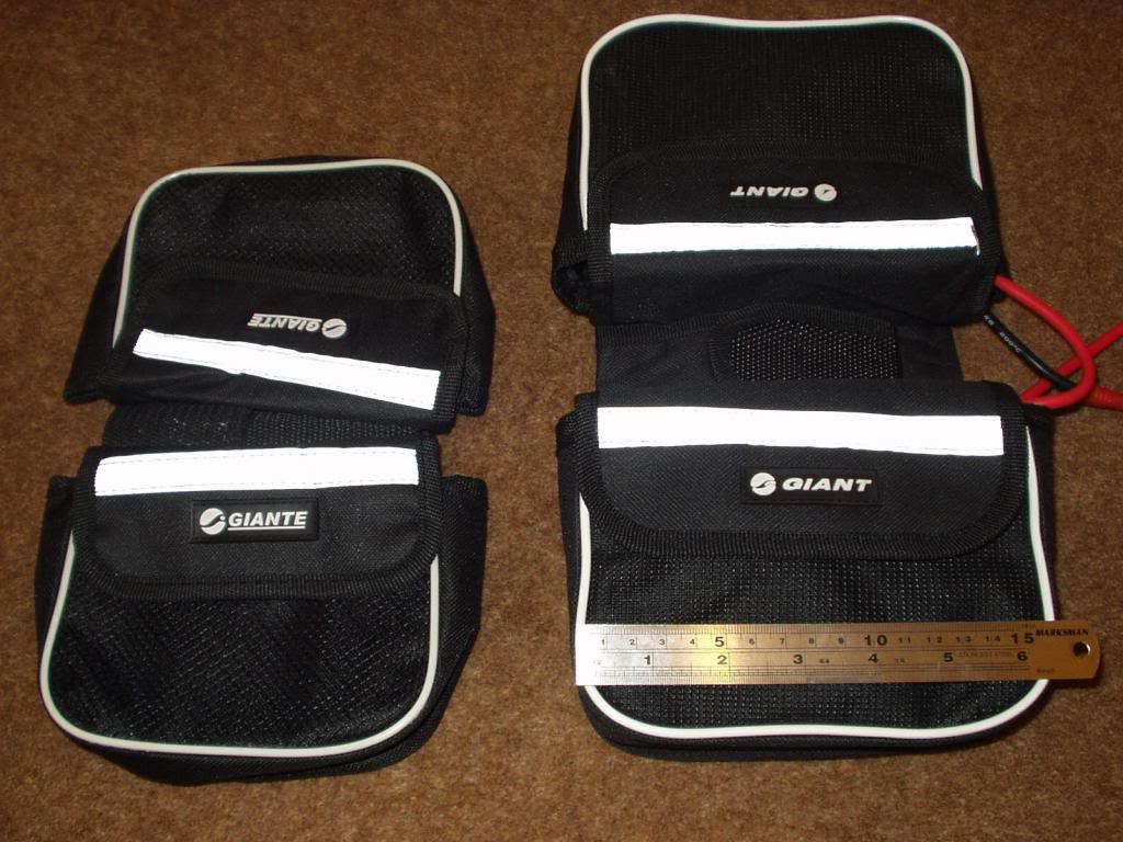

I prefer cheap, high power and lightweight battery packs, and by fabricating my own packs it allows me to easily experiment with different voltages and much higher power outputs. I build my packs from readily available LiPo packs, but they require careful monitoring during charging (using a special charger and power supply) and must also be safely protected against physical damage and excessive discharge current, as LiPo packs are renowned for turning themselves into very effective incendiary devices.  :o
Below is my latest compact, lightweight (1.4 kg/3.09 lbs) battery pack, it's a 29.6V 5Ah (33.6V fully charged) made from two 4s Turnigy LiPo hardcase packs, two Turnigy watt meters, a 40 amp fuse, and a plug in battery monitor unit, are all neatly contained within the small frame pannier bag which is Velcro strapped to the front of the top crossbar for quick and easy removal:
Size comparison:
The slightly larger bag on the right made an ideal home for a 51.8V 5Ah pack (58.8V fully charged) made from 2 x 3s and 2 x 4s Turnigy LiPo soft packs and weighs in at a mere 2.06 kg/4.54 lbs including the same watt meters and battery monitor unit, but this pack is fitted with twin 40 Amp fuses (wired in parallel) to safely deliver up to 80 amps of continuous current output. ;D
