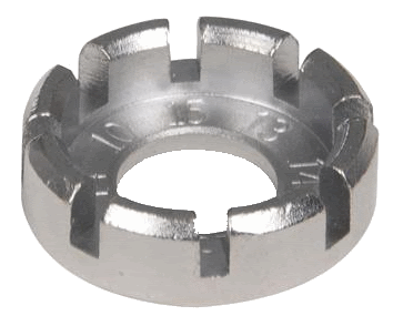

If it's making a pinging noise when riding without a battery, it may be because the spokes are loosening as they settle in with use.
Check the tension of the spokes and re-tension them if required using a size 13 spoke key. Make sure you tension the spokes evenly to ensure the wheel remains true.
I use a universal spoke key like this:
It's cheap and cheerful, but does the job nicely.
The pinging noise from the motor under load is caused by the electromagnetic pulses from the stator windings.
