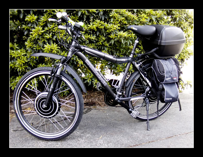

I plan on running two motors so torque should be enough. There are no restrictions where I live so I was hoping to have something that can get to 50kmph fairly quickly and then maintain that with a bit to spare for hills.
Wayne had a top speed of around 52km/h (~32mph), but you will need a battery capable of supplying the required Amps, and don't forget that each motor will need to have its own controller. ;)
Check out this post for more details
A large chainwheel would also be a good idea if you want your legs to keep up and provide assistance at that sort of speed! ;D
