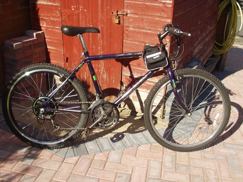

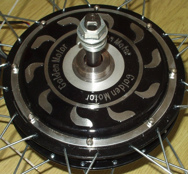

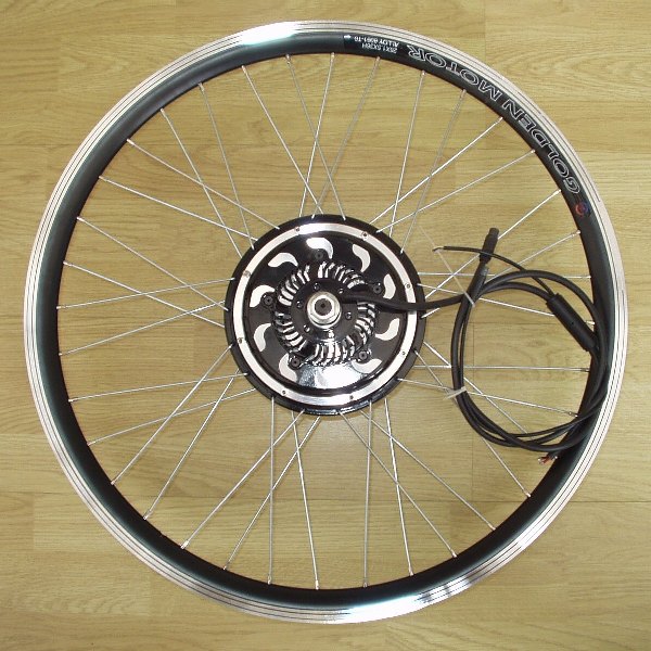

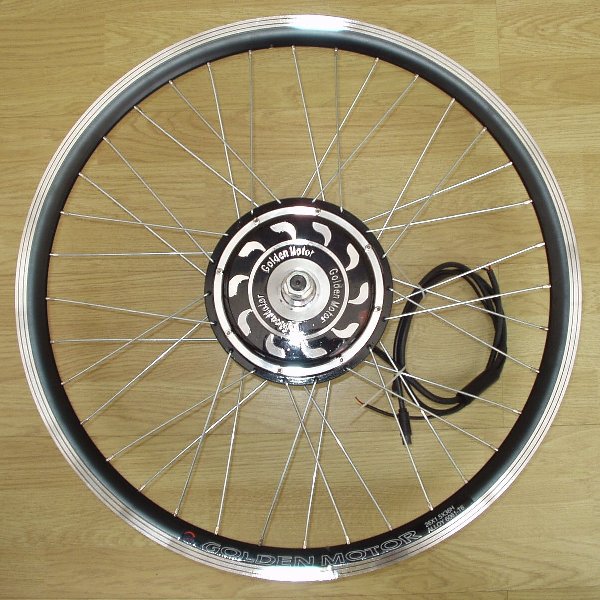

The Smart Pie 26" Rear kit had finally found its way to my house, and I was very anxious to try it out, so I decided to quickly install it on one of my rarely used bikes, an old steel framed Raleigh Ascender 15 Speed Mountain bike:
I quickly removed the wheel from its packaging to take a good look at it, and I must say that I was very impressed with its appearance, I guess GM must have decided to rename it "Smart Pie" instead of "Mini Pie" simply because it looks so very smart:

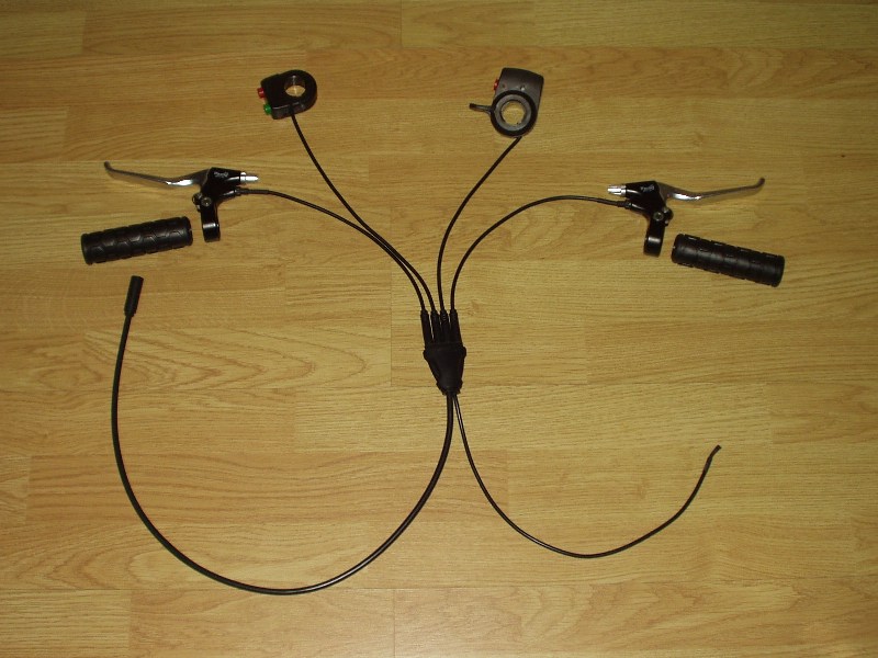

Unfortunately, I was so keen to get the motor fitted that I forgot to take any pictures of the controls supplied with the kit before assembly, so here's a photo of the MPIII controls instead. They are basically the same, except I'm using a twist throttle and the connector harness junction unit now has numbers marked on it:

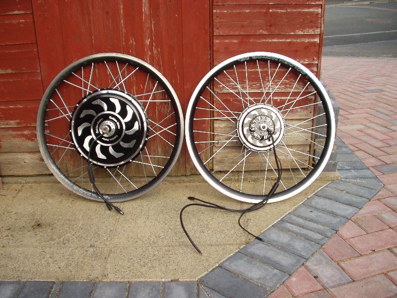

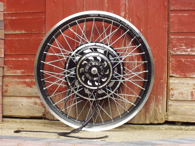

I decided to do a quick size comparison between the Smart Pie and the Magic Pie, so here are a couple of pictures demonstrating the significant difference in size between my old original Magic Pie and the new Smart Pie:
I was also curious to see how much lighter it was than the Magic Pie, so I quickly grabbed my digital luggage scales and checked the weight:
The Smart Pie wheel weighed  in at 6.42 kg (14.15 lbs) in its delivered state (no freewheel, tyre or inner tube), which is 28% less than my MPIII which weighs 8.92kg (19.71lbs), and 15.75% less than my original Magic Pie which weighed 7.62kg (16.8lbs) both of the Magic Pies are 26" rear wheels too.

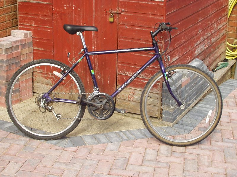

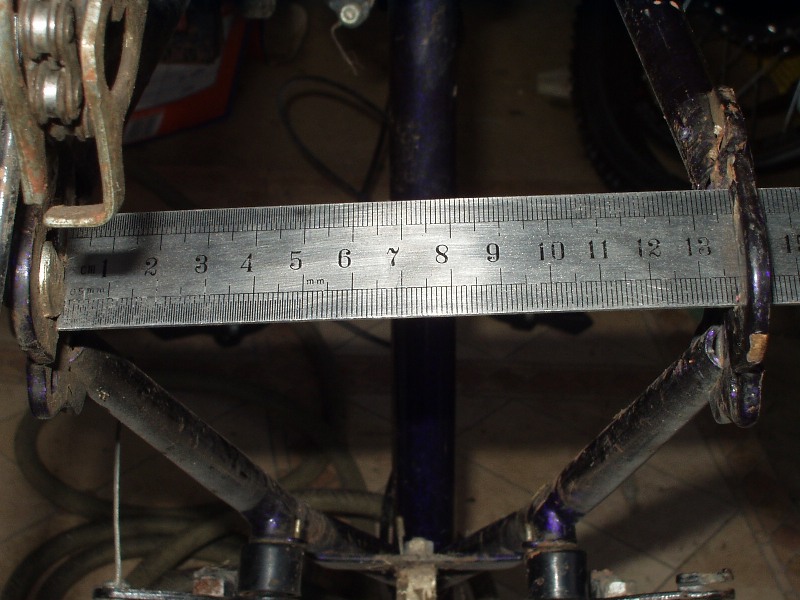

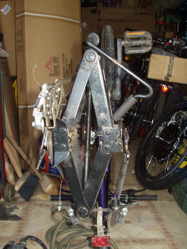

I fitted a new tyre and tube to the Smart Pie, and then flipped the bike upside down and removed the rear wheel. As I started to slip the wheel into place I quickly discovered the first problem; the dropout width was much too narrow for the hub to fit into, so I double checked the width with my trusty steel rule:

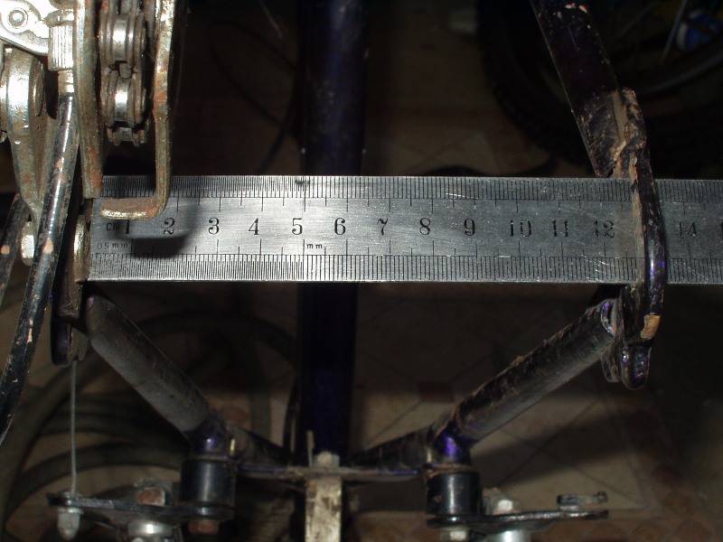

My ancient frame (or to be more exact, the bike's frame) was only designed to accommodate a 5 speed freewheel mechanism, and therefore had a much narrower dropout than most typical modern frames.
This problem was quickly rectified after some gentle persuasion was applied with the assistance of a car scissor jack:
And here is the final result, the required 135mm wide dropout gap:

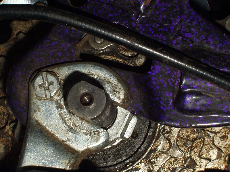

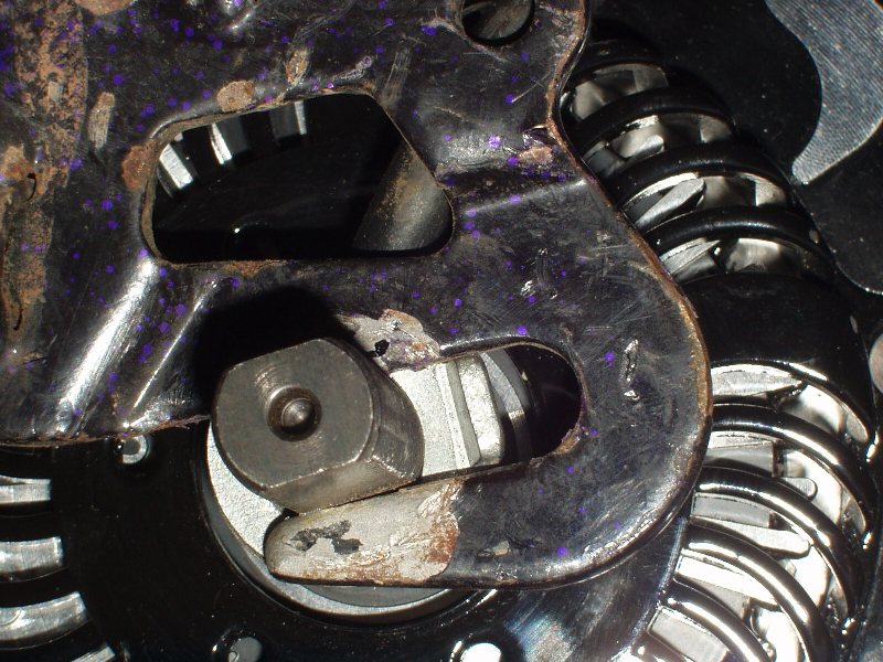

The second problem I encountered was caused by the derailleur mounting on the right hand side spacing the tabbed torque washer too far away from the frame for the tab to actually locate against anything, so I had to fit the washer on the inside of the frame instead, which still only locates against the top edge of the slot:
I also fitted the right hand tabbed washer on the inside, but I had to turn it 180 degrees so that the tab went into the slot before the axle, otherwise there would only have been only one surface for it to locate against:
The tabbed washer on the right hand side is still unable to resist any torsional load on the axle from the regenerative braking, but at least both washers are able to resist the driving torque of the motor which is far greater.

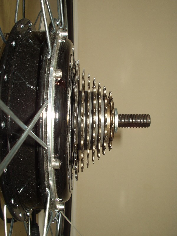

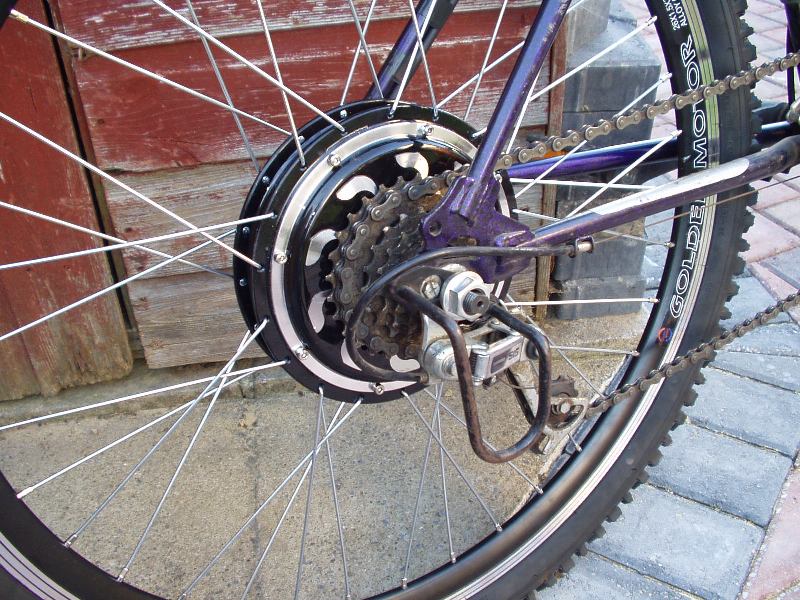

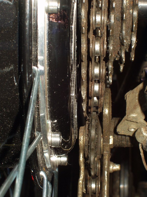

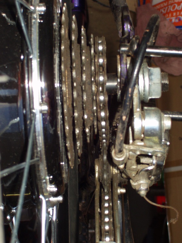

The third problem that I encountered was with the freewheel gear cluster, as the machined surface that the freewheel screws against seems to be a bit too low in relation to the surface of the side cover for my particular freewheel:
I tried both a 7 Speed and a 5 speed freewheel, and both of them needed the one provided spacer washer just to prevent the freewheels from binding against the hub cover:
Even with the single spacer washer in place, I was unable to use 1st gear (the largest sprocket) because the dérailleur mechanism was not able to move over far enough to change gear without hitting the hub cover:
I haven't tried fitting a second washer to see if it would provide enough clearance to allow the correct dérailleur operation with my particular 5 speed freewheel, but I would be concerned about how much thread was left holding the freewheel onto the hub if too many washers needed to be fitted to produce sufficient clearance.
For the time being, I have simply adjusted the stop screw on my dérailleur so that 1st gear cannot be selected, and to be honest, I don't think I will even bother trying to make 1st gear usable as in all the years I've had this bike, I've never needed to use the smallest chainwheel on the front.

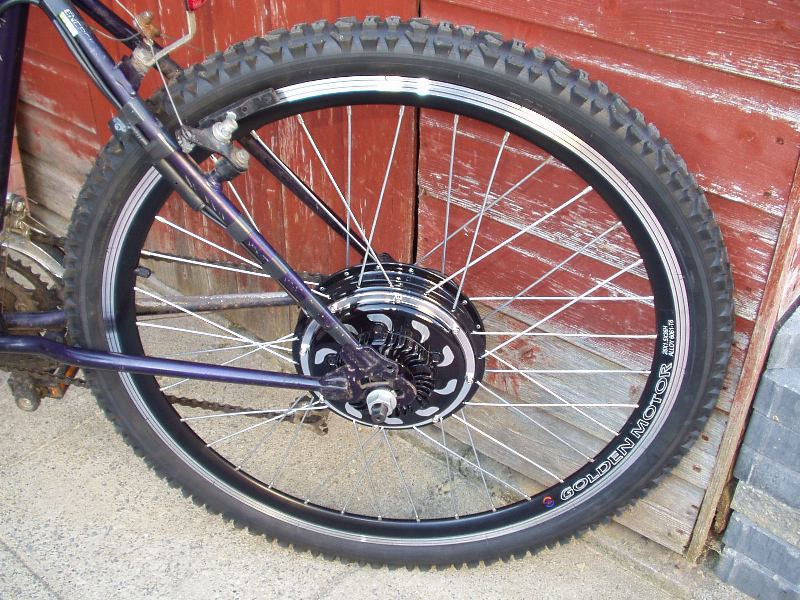

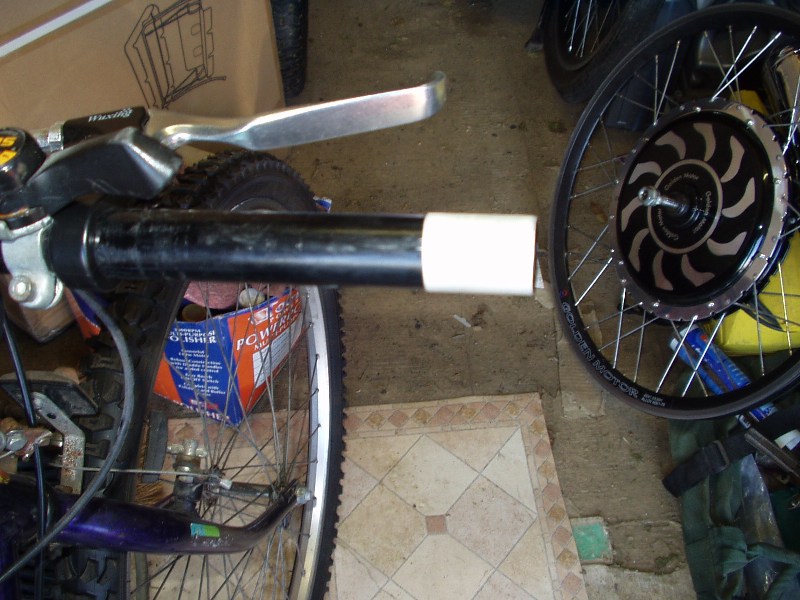

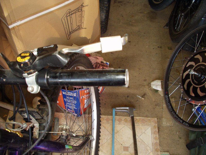

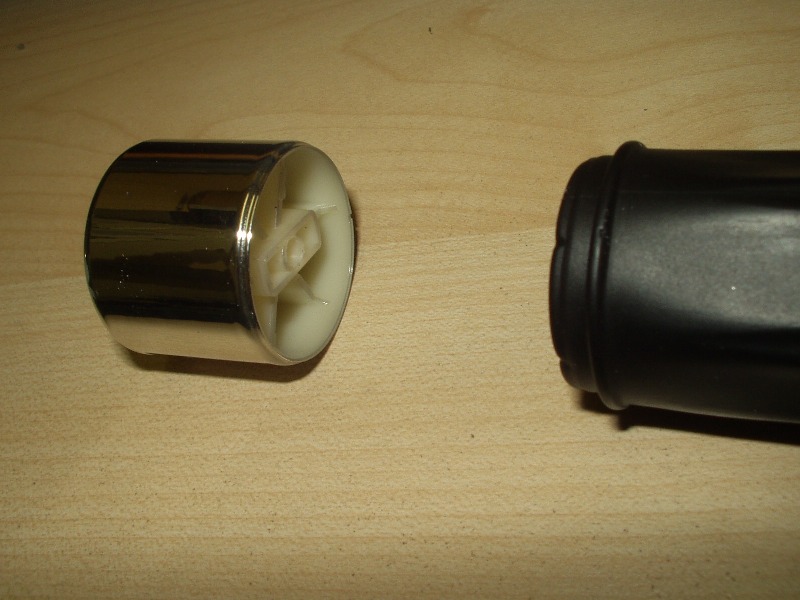

With the motor fitted, I flipped the bike upright again and started on the controls. I pulled the rubber grips off and swapped the brake levers for the new ones in the kit.
As I was about to fit the twist throttle assembly, I suddenly remembered how inconvenient I had found the additional width of the handlebars on my other bike to be when squeezing through narrow doorways etc..  So I decided to take some drastic action and hacksawed ~30mm off each end of the handlebars to compensate for the additional length of the chromed plastic end caps on the grips which extend well beyond the end of the handlebars:
The controls were quickly fitted and tightened in the correct position, and the width of the handlebars seems much better than my other bike fitted with an identical twist throttle, and I still have the option of reducing the overall width of the handlebars even more by simply removing the plastic end pieces if necessary.
The controls were plugged into the front harness which was then taped to the frame using insulation taped along its route to the connector on the motor harness.
I soldered a suitable connector onto the power cable to suit my home-made 1.4 kg (3.09 lbs) battery pack, a 29.6V 5Ah Turnigy LiPo pack (2 x 4s) which is contained within a small frame pannier bag strapped to the front of the top crossbar.
I then secured the rest of the motor harness to the frame using a bit more insulation tape, and here is the final result:

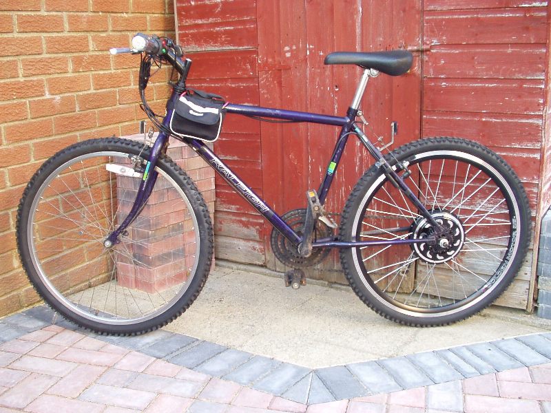

For those who may be wondering, the total weight of the converted bike (including motor and battery pack etc) is now 22.72 kg  (50.09 lbs).
Test Pilot's Weight: 66.7 kg (147 lbs or 10 st 7 lbs)
Battery Pack: 29.6V 5Ah Turnigy 20C LiPo pack
Total Weight: bike + motor + battery pack + test pilot = 89.4 kg (197.09 lbs)
You can see from the following pictures exactly how neat and unobtrusive the Smart Pie is:
I had the same problem but I was able to fix it by bending the dérailleur.
