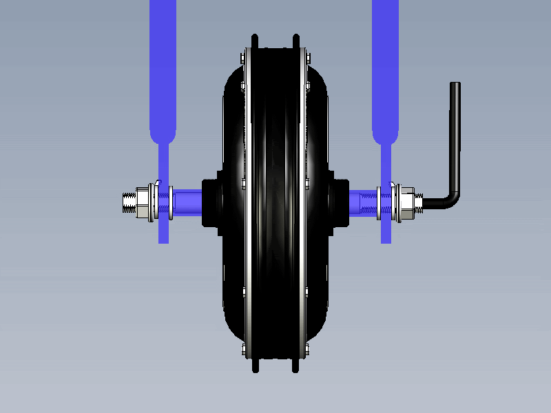

Sorry to be thick but can some one show a picture of these washers / spacers and the order they go in...
Thanks in advance for your help
Re: What Are The Spacer Tubes For?
« Reply #13 on: October 01, 2009, 10:25:55 PM »
This should help:
                             Click to enlarge
