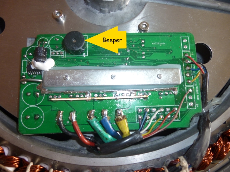

If your internal controller is equipped with an on board beeper like this one:
You should hear two beeps when the controller is initially powered up if there is a Hall sensor fault.
However, if your controller is like this one, which doesn't have the beeper installed:
Then you won't hear any beeps informing you of the Hall sensor failure.
