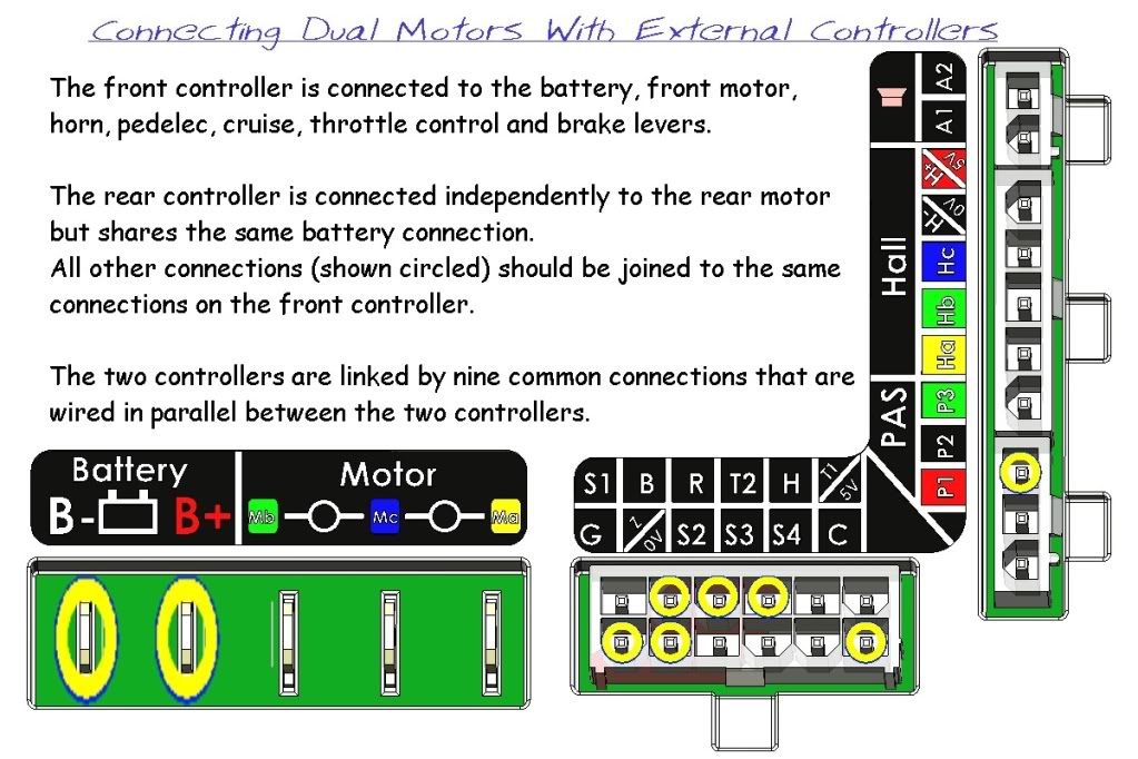

Both controllers will need to share a common negative ground connection, and the following wires can then simply be connected in parallel between the two controllers:
  • Throttle Signal (T2)
  • Brake Signal (B)
  • Reverse (R)
  • Cruise (C)
  • Ground Z/0V
It has been previously suggested that it's not a good idea to join the +5V outputs between the controllers (T1/5V and P1) as this can supposedly cause problems with the two 5V regulators as each one tries to regulate the joined 5V output.
This diagram should help:
